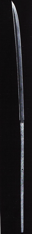

John A Stuart Posted February 10, 2009 Report Posted February 10, 2009 Here are four. They were awesome weapons. John Quote

leo Posted February 10, 2009 Report Posted February 10, 2009 Do not worry, John, as the pictures are indeed confusing and we are getting into a process of hairsplitting right now. Lets simply not mix 2 different questions. 1.What defines a nagamaki(naginata)? 2.What makes a sword blade nagamaki(naginata) naoshi? All the blades shown by Franco were made as sword blades. The 2 swords with grooves could as well both be called "nagamaki naoshi" The absence of grooves does not define a nagamaki, because any engraver could have added grooves to a nagamaki in order to add to its beauty. IMHO I would say a unokubi zukuri shape with its typical hi rather defines a Naginata naoshi sword and a rather shinogi zukuri type blade with long kissaki where motohaba and sakihaba are roughly the same and thickness towards the mune is strongly reduced. The difference between naginata and nagamaki polearms is easier to define: Naginata: usually shorter, more sori, nakago long in relation to blade, unokubi zukuri shape is most common, poles are long, up to 4meters. Nagamaki: longer and therefore straighter looking blades, nakago shorter in relation to blade, usually kanmuri otoshi, honzukuri, shobu zukuri, poles are much shorter and wrapped with band like a extremely long tsuka. Hence the name "Nagamaki" This is a rather simple definition and there are plenty of exeptions. But in order to stay sane, I rather would not start asking: what is the difference between a long naginata and a short nagamaki? Good luck, Martin In order http://www.ksky.ne.jp/~sumie99/naginata.html Quote

John A Stuart Posted February 10, 2009 Report Posted February 10, 2009 Gilles, The four I posted are mumei. John Quote
