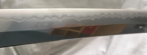

Bruce Pennington Posted September 26, 2021 Report Posted September 26, 2021 So, here's an example posted on Wehrmacht-Awards that, to me, seems to show the shadowing. Am I right on this one being oil quenched? 2 Quote
Brian Posted September 26, 2021 Report Posted September 26, 2021 I would say so personally..yes. 3 Quote
