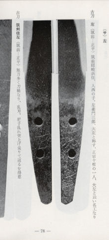

Hi, long swords, tachi, by Sa are extremely rare to begin with, most known works are tanto, and only one known signed example of a long piece extant according to Yamanaka, to say the odds are not in favor is an understatement. Also, "The only signed long blade is inscribed Chikushu Ju Sa."
Comparing this mei to those on pg. 451 in Fujishiro, tanto examples, does not look favorable (opinion). One problem with this mei (perspective) is that it is attempting to look like an original mei rather than simply being an attribution of sort. One way to find out for certain about the mei is submit this piece for shinsa.
That being said, the question remains 'what is this sword?' Its quite possible this is a Koto sword from what can be seen. Is it possible to see additional images with close ups and better lighting?
I agree with Jacques that the signature in this case is gimei.
Brian, when you take a look at the examples provided by Stephen and Jacques, you will see
that the authentic signatures are always made up of a uniform width of the chisel, whereas the
vertical stroke to the left (the second strong when counting in stroke numbers) on your
"Sa" starts thick, becomes thinner around the center, and grows once more thicker at the
ending.

Hi,
On shoshin mei, the right vertical stroke never crosses the lower horizontal one.
About age, it seems to be kesho yasurime, so this blade is shinto or shinshinto but not koto.
My guess would be shinshinto.
Surely not 1400's /Sa
There were MANY smiths that signed Sa thought, in that period. They were gone by Shinshinto times.

Hi, Brian!
Interesting blade to be found in a military koshirae! A good buy!
It looks indeed like a Shinshinto copy of a late Nambokuchyo Yamato Shizu blade. The pictures do not show enough details to tell the date of manufacture precisely.
Judging from the style it could have been a much longer blade which was cut off considerably 200 years ago and then had the Sa-character scratched in. It was then shortend again during the Showa period to fit the military scabbard.
Regards, Martin

O-SA can be safely excluded on the basis of mei and sugata. That's about all we have for judgement, sitting in front of computer screens. There are two possibilities left: It is a gimei sword, as was suggested because of the yasurime, or it is a blade from O-Ishi Sa-school in Chikugo. They purported the famous name and used it without deliberatly cheating. This attitude can be compared with Mino smiths in Seki, using the "trademark" KANEUJI in a similar way during Muromachi-period. Without seeing the blade itself, any further conclusion is ridiculous.
