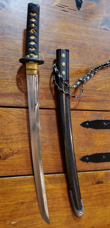

There is zero chance of ever finding who owned it or returning it. Just make sure your family takes care of it. Potentially a good sword. Fittings are good too. Someone will advise you how to remove the tsuka and see if there's a signature.
As for the story of how it was acquired, I suspect the story changed over time, no offense. This is not the sort of sword anyone in WW2 would have been carrying in battle in those fittings. Maybe acquired after the war or in Japan. It's a nice sword and better than most wartime ones would have been.

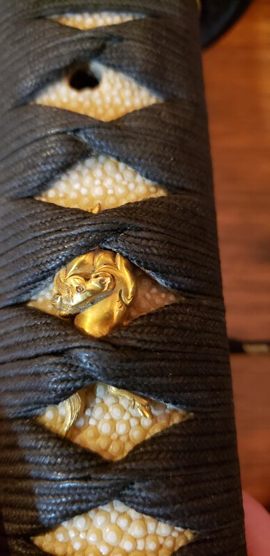

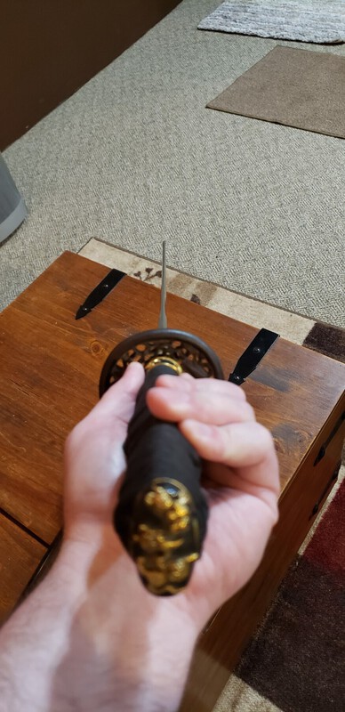

Tap this peg (mekugi) out from the other side and the handle (tsuka) and metal fittings slide off the tang (nakago).  If they are tight, light tapping with a rubber mallet on the handguard (tsuba) or with a wooden block will loosen everything up.  No harm will come to your sword by doing this.

Thank you everyone for your replies. Ill get with my uncle and see about finding a signature or makers mark. It might be a bit as we are in different states. (I was recently visiting when I took the photos)

Ill call my uncle and see if he is willing to remove the peg that Bruce pointed out and give an update.

The handle is made to come off...but steady as she goes.

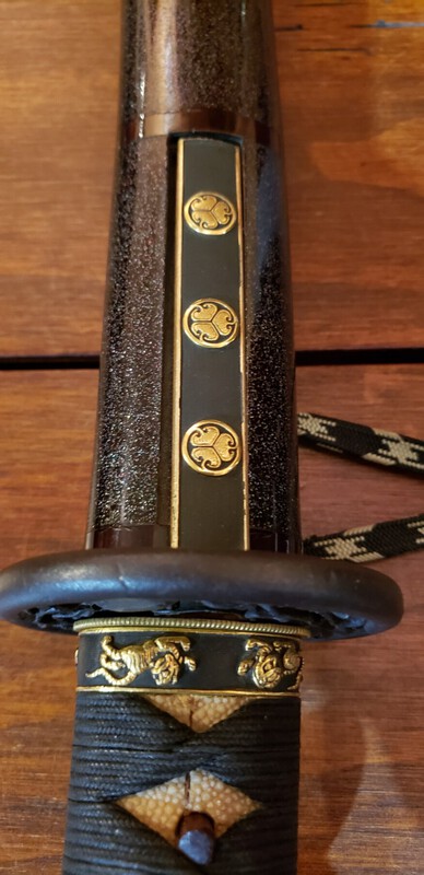

The three circular crests on the small knife (kozuka) slipped in the side of the scabbard (saya) are the Aoi Mon which is the symbol for the Tokugawa family. I wouldn't read too deeply into this though - Kozuka are often lost or replaced so it may be modern replica but still a fun tidbit of information.
Aoi mon are probably the most common symbols used out of all the mon, and rarely signify anything. Used profusely on later koshirae, nothing to do with the Tokugawa in 99% of the cases.

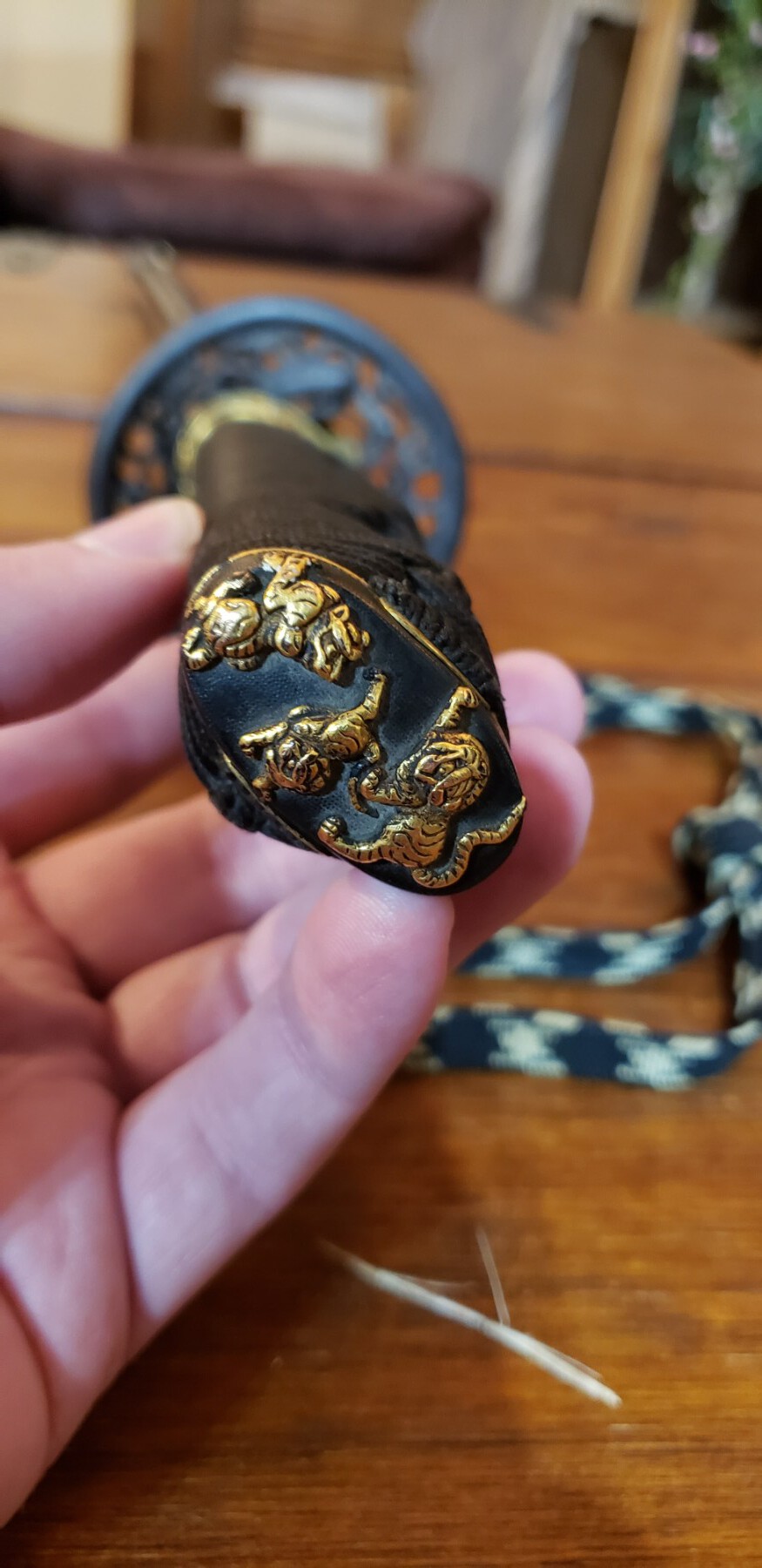

Kozuka looks high end. Can be Yoshioka.
The blade is almost straight, very beefy, some taper... Maybe Kambun shinto. The nakago and the boshi are too most important elements to be more precise in attribution.
