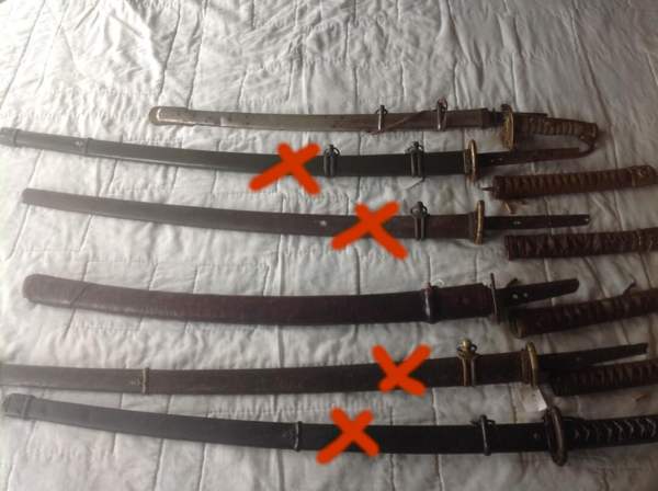

MacTheWhopper Posted September 14, 2021 Report Posted September 14, 2021 I have a guy who has a few swords he has collected over so many years and is wanting to part with. The pictures of the swords he has for sale are below: The 2nd from the top and 2nd from the bottom were the most of interest to me. The 2nd from the top appeared to be a type 94 and both of them appeared to have pretty decent sized blades. The third and fourth from the top appear to be signed After receviving not the best pics to identify, I asked for a couple of more of the original two i had liked. I received these pictures. The tang on the bottom one seems to be of very low quality and wouldnt match type 98 mountings would it? The other one with the 4 holes it seems to have quite a bit of rust as well. I have asked for a few pictures of the kissaki. Does anyone have any opinions on these swords? Quote
Kiipu Posted September 14, 2021 Report Posted September 14, 2021 One of the swords you depict is thought to be for Chinese use with a Chinese made blade and Japanese made fittings. I have knowledge of only two, and one is incomplete. The fittings sometimes show up in Japan. Fairly uncommon to say the least. Please help with translating the writing on sword Attention: @BANGBANGSAN & @Dave R Quote

BANGBANGSAN Posted September 15, 2021 Report Posted September 15, 2021 The last one looks like an NCO sword but add 石突 and 責金 from Type 98 on NCO scabbard. Quote
BANGBANGSAN Posted September 15, 2021 Report Posted September 15, 2021 On 9/14/2021 at 10:51 PM, Kiipu said: One of the swords you depict is thought to be for Chinese use with a Chinese made blade and Japanese made fittings. I have knowledge of only two, and one is incomplete. The fittings sometimes show up in Japan. Fairly uncommon to say the least. Please help with translating the writing on sword Attention: @BANGBANGSAN & @Dave R Expand Including the one showed in that thread, I saw two of those 斉燮元奨刀. The other one says 總長斉燮元奨。 1 Quote
vajo Posted September 15, 2021 Report Posted September 15, 2021 Hard to say for all but this 4 are obvious fake ones. 1 Quote
Stephen Posted September 15, 2021 Report Posted September 15, 2021 I dont know how you keep in order Chris. Pretty sure this is copy not real deal. The top one....lower has better chance of being a decent wakizashi Quote
Dave R Posted September 16, 2021 Report Posted September 16, 2021 It's always a problem when stuff is jumbled up, it's why I get a bit twitchy when someone piggybacks on a thread with a different item. This style keeps turning up and I thinks it's a legit Showa empire piece, but whether it's for Manchuria or Chinese collaborators I cannot say. 3 Quote
Dave R Posted September 16, 2021 Report Posted September 16, 2021 I also think that the items at top have a complicated history, with old genuine mounts and pieces salted through with dubious stuff. If anyone wanted to move on a damaged or very poor condition (unsaleable) Nihonto, sticking some genuine(ish) WW2 mounts on it would make an otherwise junk blade readily saleable, because militaria sells by a different criteria to Nihonto. 1 Quote
