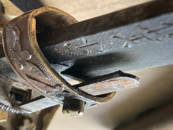

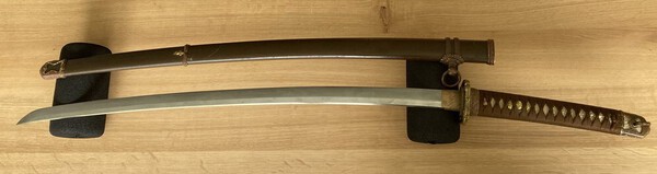

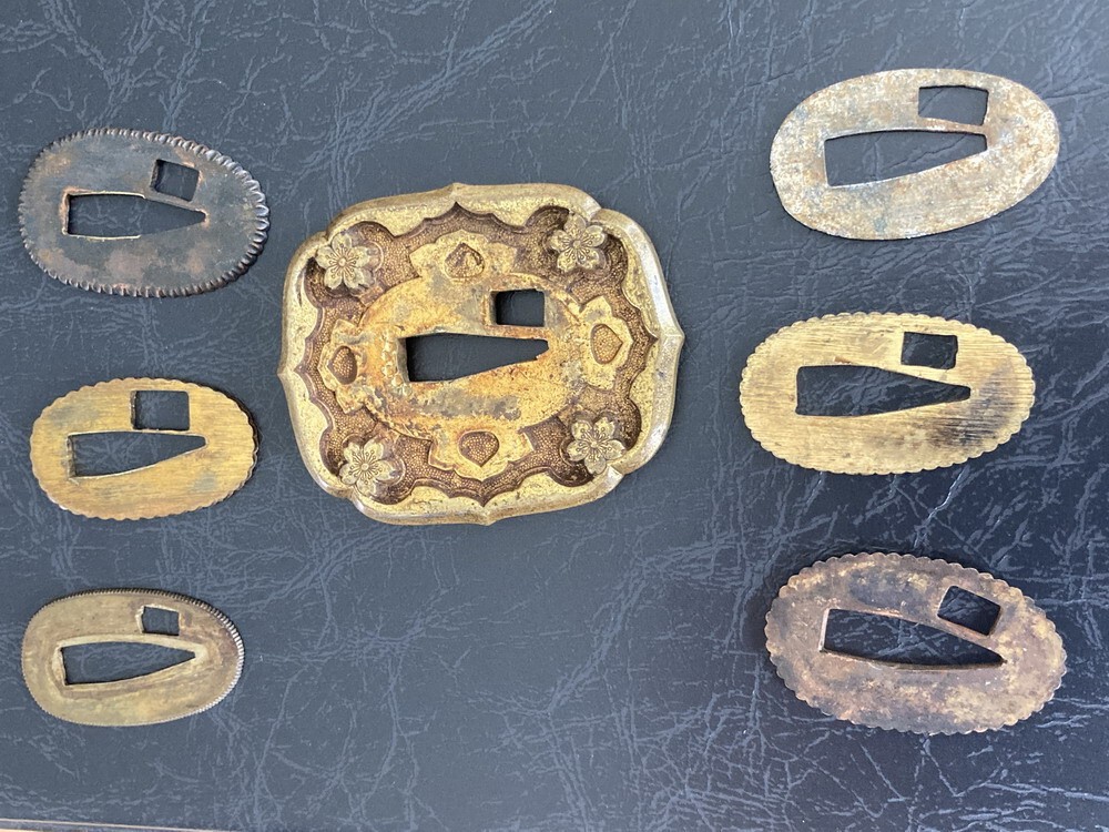

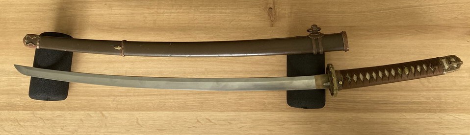

Bull McCabe Posted September 10, 2021 Report Posted September 10, 2021 Hi guys, It is through circumstance that I find myself here. Long been a collector of military history, with a decent and varied collection of WW2. I decided it would be a good idea to add some Pacific to my collection, specifically by a Type 95 arsenal sword, and am now down 4 tsubas, a 1943 Nambu 94, a "Good Luck" flag, a parade and cavalry sword, a Type 95 and 98....and then I found this site. In any case, it is still a new field to me, been a long time lurker here and enjoyed learning from all the various posts. I specifically enjoy the open mindedness, fairness and respect demonstrated on this forum. So I finally bite the bullet and try contribute, despite that I am an absolute beginner in what has proven to be very deep waters from my original desire to simply have a Type 95. I would like to post my Type 98, and generally ask opinions on it, and how best to preserve it. I have some issues, looseness around the seppas, a slight "lack of tightness" on the tang in the tsuka, you can feel it. Likely millimeters, but curious on opinions. Some thoughts - a rewrap is likely, but am curious about how it clips into the saya. It catches onto the metal guard rather than the wooden saya - this piece likely lost? Am I mistaken? There is also some movement on the sword in the saya, likely due to the lost of piece of saya pictured? The seppas and tsuba can also move very slightly if pressed upon. Many thanks for any insights that may help me understand this Type 98 better. Good weekend all. David 1 Quote

Kolekt-To Posted September 11, 2021 Report Posted September 11, 2021 I'll let other more experienced collectors answer your questions, as I am new to Gunto collecting, as well. I do have to compliment you on your Type 98 - looks like a very nice example! The Mon on the kabutogane is something special, too. Quote
PNSSHOGUN Posted September 11, 2021 Report Posted September 11, 2021 David, you have a good looking Type 98, can we see photos of the signature and date? 1 Quote

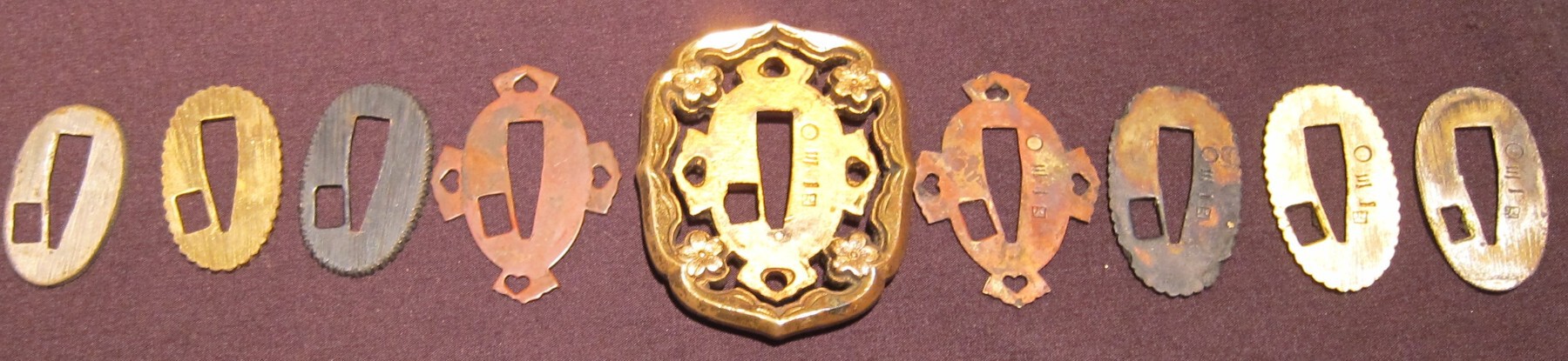

george trotter Posted September 11, 2021 Report Posted September 11, 2021 David, Just looking as the photo of you tsuba (guard) and seppa I can say: You have 6 seppa...there should be 8 here. The two larger "4 lobe" seppas that match that design on the tsuba are missing. Get 2 of these 4 lobe seppa and I think you will probably find the assembly will become tight on the tang. Regards, 3 1 Quote

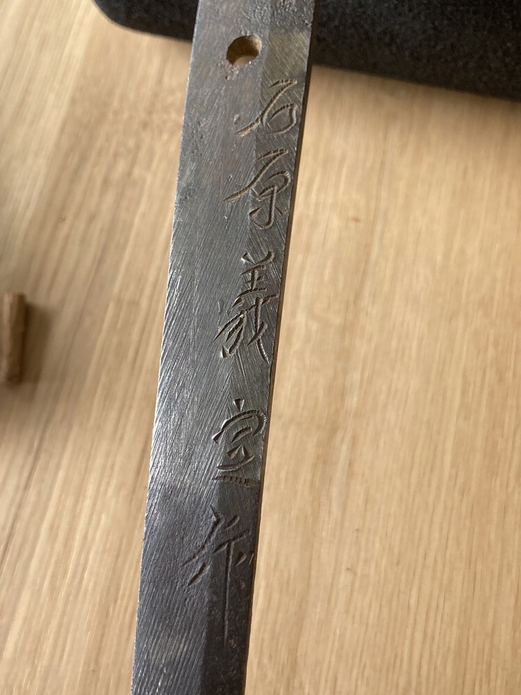

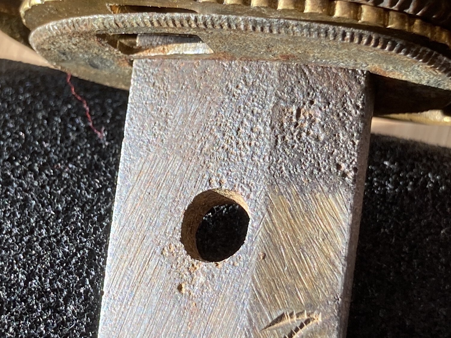

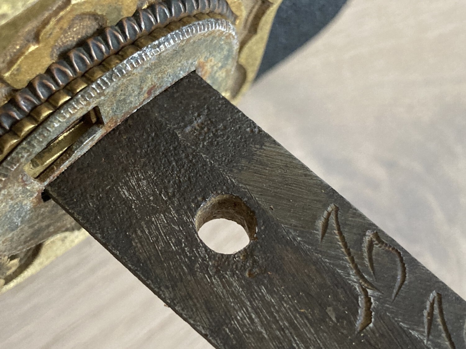

Bull McCabe Posted September 11, 2021 Author Report Posted September 11, 2021 Hi guys, Thank you for the comments and information so far. Very much appreciated. John, I will upload a photo of the tang. I am presuming it is a Showa smith. I found no other stamps on the tang. If you want any other images, happy to share. Quote

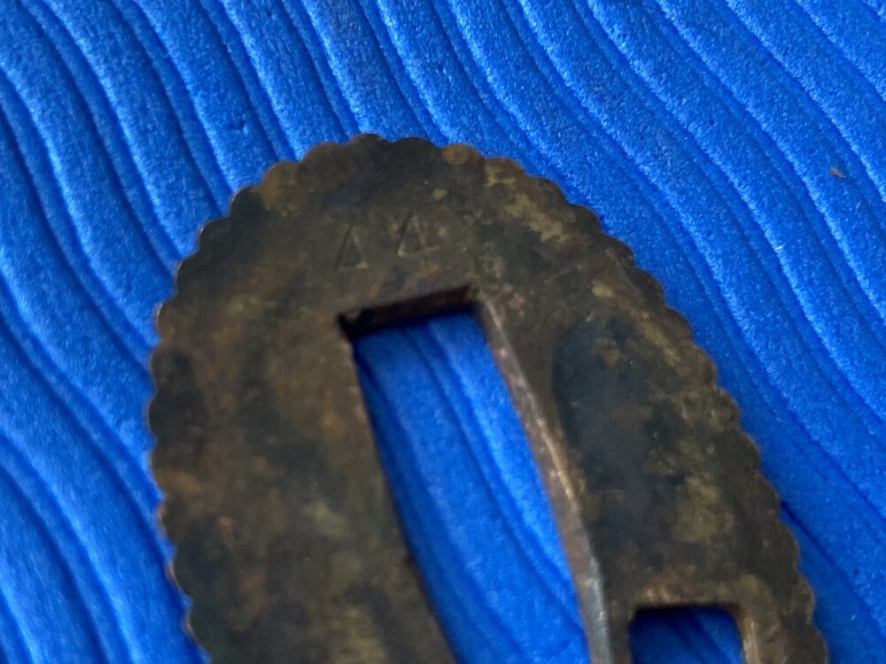

Bull McCabe Posted September 11, 2021 Author Report Posted September 11, 2021 I noticed that the seppas had “44” on them. Is this referencing the year? Quote

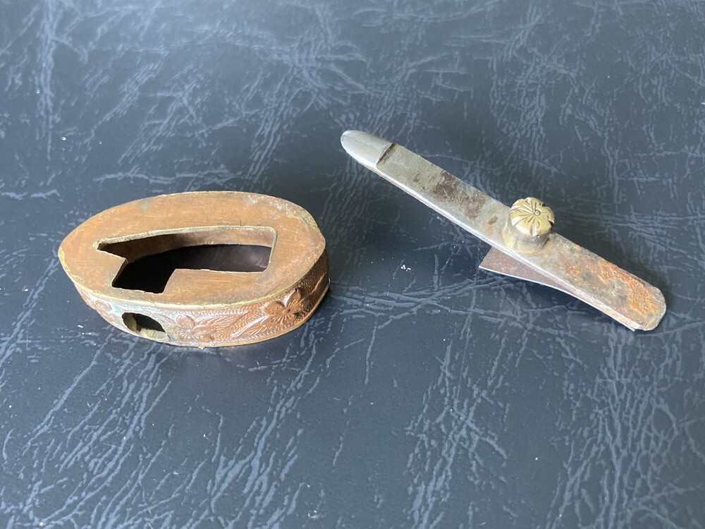

Bull McCabe Posted September 11, 2021 Author Report Posted September 11, 2021 Hi George, that is very helpful. I was not aware that 8 seppas were standard for a Type 98. Something new learned here wherefore my thanks. Where can I buy the right parts? What do you think about the catch mechanism? Should it catch in the wood or against the metal? Many thanks again. Quote

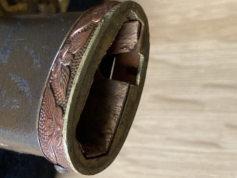

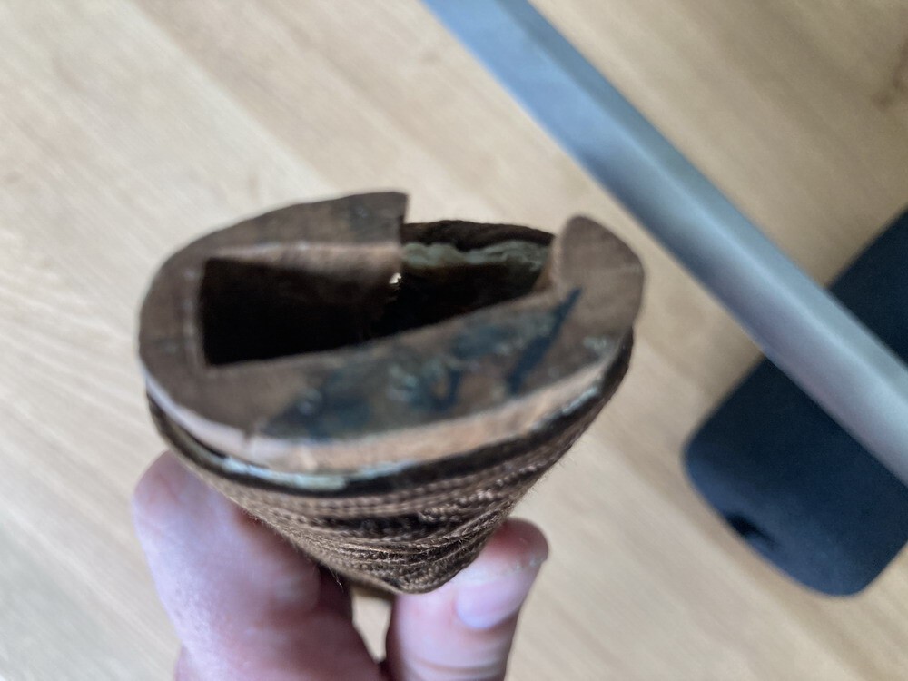

Bull McCabe Posted September 11, 2021 Author Report Posted September 11, 2021 It also appears a piece of tsuka is missing so the mekugi only grips effectively on one side. I am wondering how best to repair this. Any thoughts anyone? Quote
PNSSHOGUN Posted September 12, 2021 Report Posted September 12, 2021 On 9/11/2021 at 6:20 PM, Bull McCabe said: It also appears a piece of tsuka is missing so the mekugi only grips effectively on one side. I am wondering how best to repair this. Any thoughts anyone? Expand A common issue unfortunately, beyond fashioning a better fitting Mekugi I'm not sure of a remedy for this. Quote
Bruce Pennington Posted September 12, 2021 Report Posted September 12, 2021 On 9/11/2021 at 6:17 PM, Bull McCabe said: I was not aware that 8 seppas were standard for a Type 98. Expand David, There was no "standard" seppa configuration. Most of the time, you'll see 4 or 6. Getting into 8 or a grouping with the "fat" seppa, often comes with custom or upgraded fittings. For the menuki fit, I think once you add the missing seppa, the whole thing is going to tighten up enough that you won't notice it. One side, tightly fitted should work sufficiently. I have a gunto (or 2) with a menuki so short it doesn't go through all the way out the other side, and the fit is tight. 1 1 Quote
Bull McCabe Posted September 12, 2021 Author Report Posted September 12, 2021 Thanks for all the tips guys! Getting a couple of these seppas, EBay would be the right place for that? Ill give it a try and see how it goes. First Type 98 so everything is new. If buying a new tsuka, I presume it is a trial and error exercise based upon sharing measurements beforehand? I note koshirae are often for sale on this site. Quote
george trotter Posted September 12, 2021 Report Posted September 12, 2021 Hi david, The guys have answered this question on seppa on your ISHIHARA YOSHISADA SAKU showato (I'm surprised it has no "sho" or "seki" stamp on the tang)...let me just add that 4 o 6 seppa is the most commonly found, but 2 of them are always the "4 lobe" large seppa...they are missing on yours, so yours happens to be an 8 seppa set. You should search on-line, you'll find some. regards, 1 Quote

Bull McCabe Posted September 12, 2021 Author Report Posted September 12, 2021 A quick question on the showa stamp. I read previously this means a non- traditional manufacture through military logistics, such as the machine made Type 95s? Is this assumption correct? Is this blade not a traditionally smithed blade? If so, it would still be expected to have that stamp? Quote

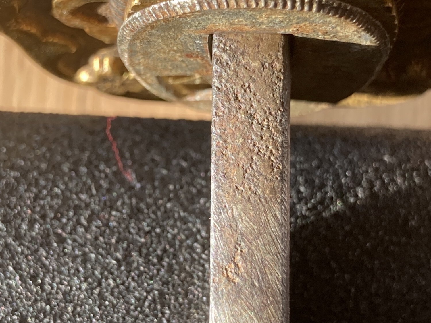

Bull McCabe Posted September 12, 2021 Author Report Posted September 12, 2021 Here is the reverse side of the tang. I did not locate any other stamps. Quote
Brian Posted September 12, 2021 Report Posted September 12, 2021 Stamped swords are still a cut above the NCO ones. Showato are often still made by a smith, hammered and shaped and tempered although in oil. In other words, not fully traditionally made, but far more work than a mill steel NCO blade. 1 Quote
Bruce Pennington Posted September 13, 2021 Report Posted September 13, 2021 David, I could be wrong about the stamp, but to me, it looks like a showa stamp at the top, mei side, that someone tried to obliterate. This isn't uncommon. Either the owner or a post-war owner didn't want the "showato" label (nihonto & gendaito sell for higher prices). The age of the area looks old, so it might have been the owner of the gunto. Not sure why an owner would do that though. Quote
Bruce Pennington Posted September 13, 2021 Report Posted September 13, 2021 Just for interest sake, there is another Yoshisada in presentation tachi mounts HERE. Quote

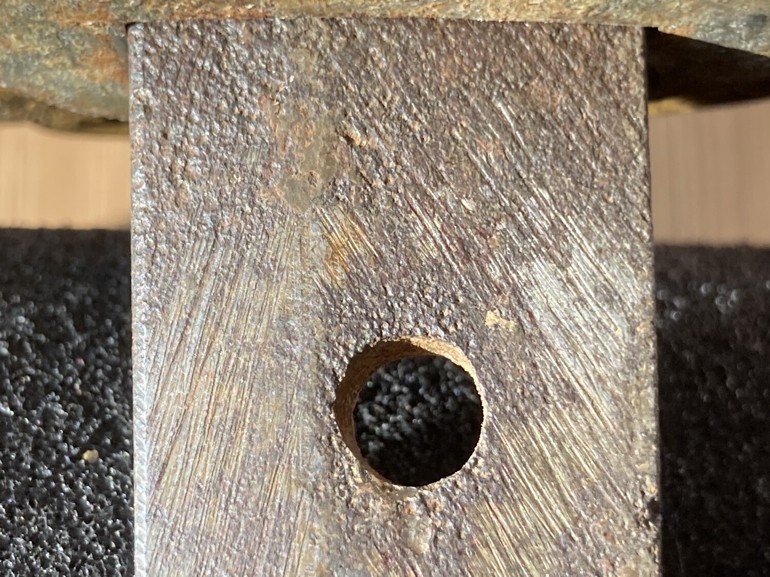

Bull McCabe Posted September 13, 2021 Author Report Posted September 13, 2021 Hi Bruce, That is an interesting spot you have mentioned. My curiosity piqued, I have tried to get some better images in the early morning sunlight to create some contrast. There is certainly pitting there that extends around to the other side of the tang. Any further thoughts very much appreciated. Quote
Bruce Pennington Posted September 13, 2021 Report Posted September 13, 2021 The new photos show that the area is corroded/pitted. I thought it was defacing, that is seen on some blades to hide a stamp. Whether there was a stamp there or not, who can say? If you want to pursue the question of whether your blade is gendaito or showato, you might take a look at some of Ray Singers photos - HERE - to get an idea of how to get good shots to reveal details. Otherwise, simply enjoy your nice gunto, as start looking for the next one to add to your collection! Quote
Bull McCabe Posted September 13, 2021 Author Report Posted September 13, 2021 Thanks again for sharing your expertise Bruce. As this field of collecting is new to me, I had never heard of defacing arsenal stamps. Fake signatures - that I can see the crooked logic behind. But to remove a stamp, and have a signature of a Showa smith, I cannot see the logic. But then you could also bring the signature into question. I think I will just get a couple of seppas and enjoy it as a showato - this was the reason for purchase in any case :-) But I can feel an itch to have an ancestral blade beginning 😉 1 Quote
Brian Posted September 13, 2021 Report Posted September 13, 2021 To me it looks like an obvious arsenal stamp removal. But your mileage may vary. They would be removed when sourced in Japan. An arsenal stamp would be a certain destruction. Whereas if there is no stamp, they will often err on the side of caution and pass it with a torokusho so that it may be owned. Quote
Bull McCabe Posted September 13, 2021 Author Report Posted September 13, 2021 Hi Brian. Never thought of that. That would be to comply with post war terms related to weapons? It does not look recent, if this is what happened. And would have taken a decent amount of skill? Quote
