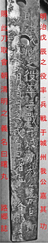

Mei: Cho shu ju fujiwara Moriyasu
Inlay: Meiji Boshin war, for leading troops in attacking the state of ??, I was awarded horse and this sword by my lord. For peace of the world, I name this sword the bright Maru, signed Lu Xiang(a Chinese courtesy name)

Hi,
R:
明治戊辰之役率兵戦于城州我公嘉其功
L:
賜此刀取會朝清明之義名曰曙丸  路郷誌
Nickname of this sword is "AKEBONO-MARU"  曙丸 . (AKEBONO  means  dawn/daybreak .)
Wrote by Michisato(?) 路郷誌 .
  • Like 5
  • Thanks 2

10 hours ago, k morita said:
Hi,
R:
明治戊辰之役率兵戦于城州我公嘉其功
L:
賜此刀取會朝清明之義名曰曙丸  路郷誌
That is wonderful work Sir! It’s especially helpful now that the city/state of Yamashiro could be identified thanks to your translation

On 9/8/2021 at 11:03 PM, k morita said:
會朝清明
I'm wondering about this bit here. I don't think this should be interpreted as a wish for world peace, but I can't figure it out. If I search for this phrase I get a reference to a certain Amano Kanzaemon (天野勘左衛門), who is the subject of an old legend, but I don't feel this is right.
Maybe @k morita or @Nobodycan help with this bit?
