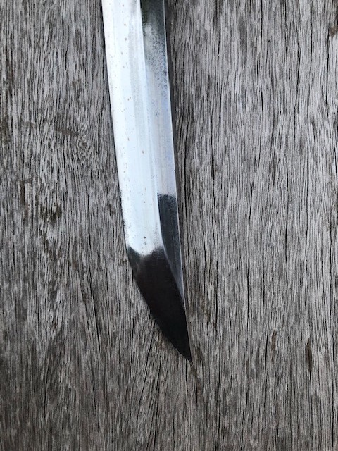

Erwin Posted September 7, 2021 Author Report Posted September 7, 2021 Hi all, thank you so much for your involvement and information I agree on the Kiri style yasurime, it is the first I have in the collection as well. I am more into WW2 types but bought this version to help someone out. Thank you Uwe for you information: Seems to be signed “壽命” (Jumyō) “十六年” was hoping it would be dated but guess not? So Jumyo is all it states and will try to find out more info so I can somehow place it in time. The Kissaki is also very large. thank you again, always extremely impressed you knowledge and respons time Best regards and a great day to you all Erwin Quote

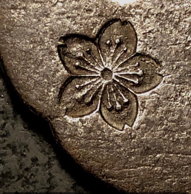

mecox Posted September 7, 2021 Report Posted September 7, 2021 Erwin, looks to be Kato Zennosuke, whose swordsmith name was Jumyo. Have a look at the Naval Swords article in NMB Downloads, p. 9 and 42, summary of him. From pics your sword looks early war. See the plain iron tsuba and sakura stamp on it, and green ito. Maybe the "16" is Showa (1941) but sword may be a bit earlier, so something else?? This Jumyo did do some heavily cut kiri yasurime like this blade. The word Jumyo meant "long life" so often popular as gifts. There were Jumyo smith in early Seki from Koto period, then in Shinto they moved to Owari. Quote
