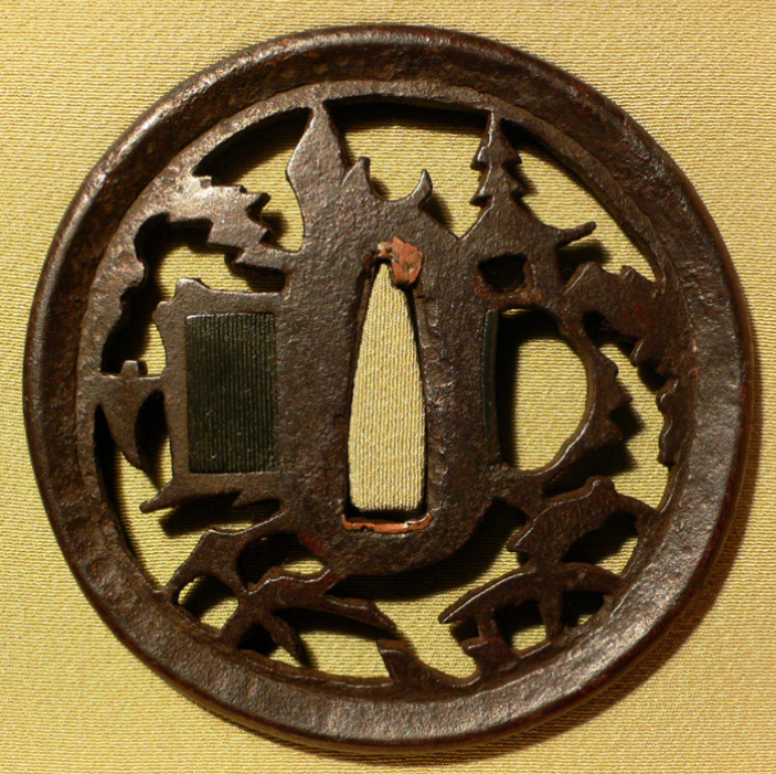

reinhard Posted February 5, 2009 Report Posted February 5, 2009 My dear forumites, I would like to show you a tsuba for open discussion. Although it is attributed by NBTHK to ?, it is a mumei tsuba and I would like to know what YOU are seeing in it. Age, design, craftsmanship and so forth. Being more familiar with blades myself, I just wonder what you think. Don't be shy. This is supposed to be a learning experience for all of us. reinhard Quote
John A Stuart Posted February 5, 2009 Report Posted February 5, 2009 Reinhard, it would be good to have some dimensions as reference. Size, thickness, does it have tekkotsu, is the rim thicker or thinner than the seppa-dai etc. I am torn between Owari and Akasaka, but Akasaka feels better to me. Positive sukashi, smoothly cut, rounded mimi. Mid-Edo period. Best I can do from a pic. John Quote
reinhard Posted February 5, 2009 Author Report Posted February 5, 2009 John, The tsuba is almost perfectly round, measuring 8.0cm in diameter, horizontally and vertically. Thickness of the rim is 6 mm, thickness of the seppa-dai is: 4 mm. There are faint tekkotsu and multi-layer forging is visible. But before presenting the solution on a silver tablet: What about the design? What does it show and in what way are those topics related? And what about numbers? reinhard Quote

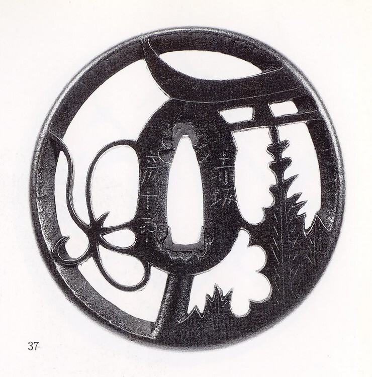

Ford Hallam Posted February 5, 2009 Report Posted February 5, 2009 This looks to me to be the work of the 4th generation Akasaka master, Tadatoki I ( died 1746 ) This, very characteristic, chiselled bevel on the inner edge of the rim is something I've seen in his work before. Just my shot in the dark regards, Ford Quote

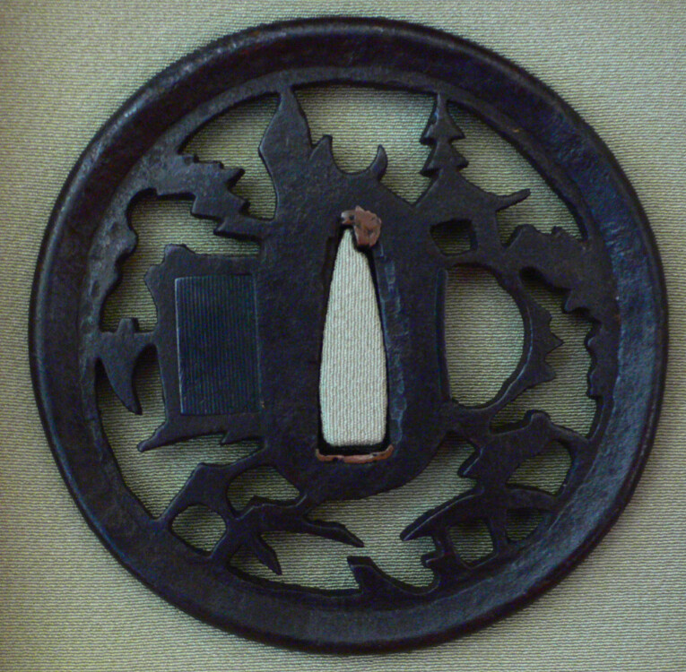

reinhard Posted February 6, 2009 Author Report Posted February 6, 2009 Hello, You are doing a great job so far and it is a pleasure learning with and from you. As soon as I have some more time, I will provide you with pics of the edge and subtler details. To get on with it, I give you the description of the Hozon paper. It can be translated approximately like this: "eight views" design sukashi tsuba maru-gata (round shape) tetsu tsuchime ji (hammered surface) ji sukashi (positive silhouette) dotte mimi (added rim) ryo hitsu ana (both hitsu ana, one plugged with shakudo) The dotte-mimi is not a later addition. It was made of exactly the same steel as the tsuba itself and it has the same deep black color and moist lustre. Focussing on hitsu ana is a very good idea when considering early Akasaka work. The steel quality however is similar to Owari tsuba. My next question is: what does "eight views" mean? reinhard Quote
reinhard Posted February 6, 2009 Author Report Posted February 6, 2009 Here's another pic of the same tsuba taken by daylight and with less disturbing shadows for those, who try to identify the design. reinhard Quote

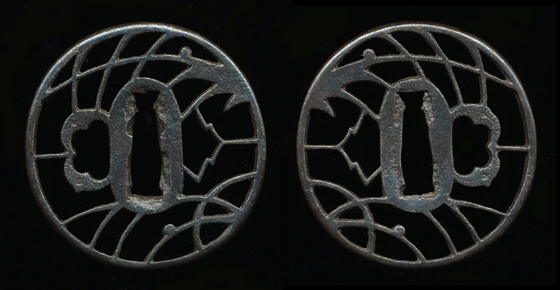

Ford Hallam Posted February 6, 2009 Report Posted February 6, 2009 The rectangular shape of the left hand side hitsu is apparently nudging some opinions away from Akasaka. I'd just like to point out that in fact while it's not terribly common there are a number of examples of similar squarish shapes to be found in the work of the first 4 masters. I'm personally still comfortable with my call although I'll admit that trying to pin it specifically to Tadatoki I might be pushing it as his work is generally a bit more sophisticated. This tsuba does have a certain ruggedness about it and the pierced web of the plate is unusually plain for him. To my eye, although the design does seem a bit "busy", ( as I think John mentioned) it is quite delicately cut out with no areas not having been carefully considered in terms of shape and arrangement. The overall texture of the iron ( it's relative coarseness compared to the refinement of later Akasaka steel ) and the fact that Reinhard tells us the edge shows faint layering further convinces me this work is from the earlier period of Akasaka production so I'll stick with no later than 4th master. Quote

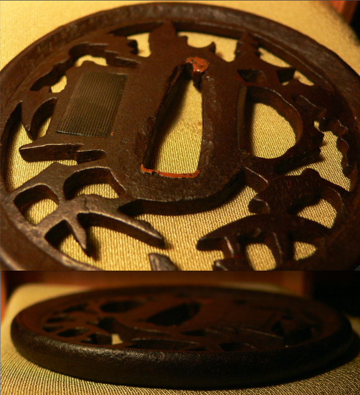

reinhard Posted February 7, 2009 Author Report Posted February 7, 2009 For those of you not yet tired of considering, here are some more pictures. They show basically my limited skills of taking pictures with a compact click-o-matic camera. On the rim some granular tekkotsu as well as linear structures are visible. A further hint are these passages from literature related to this school: "it seems most improbable to me that the production of the above mentioned group should have been restricted to one place or even to a single family......the metal is frequently the same or resembles that of the Owari guards. In terms of design and quality the earlier......sukashi can be called equal in the rank with Owari tsuba." "The artistic work of ..... tsuba lies somewhere between Kyo-sukashi and the Owari-schools. .....openwork is bolder than Kyo but more delicate than Owari.....The designs are unique." John narrowed the subject immediately by saying Akasaka and Owari, but maybe this was too tight a border. Bold angles are pointing towards Akasaka work, the steel quality is leaning towards Owari work, but there is still Kyo-work beyond common expectations, creating a triangle of possibilities. The key-word has not been said yet and therefore I don't want to set you free now. And what about the eight views? reinhard Quote
John A Stuart Posted February 7, 2009 Report Posted February 7, 2009 Reinhard, The tekkotsu was always problematic on this tsuba leading to Owari metalcraft, but, Akasaka in style and technique. While pondering these attributes together within and the influence by Ko-Shoami could this be an Ono tsuba? Their designs and metalcraft would fit, I think. John Quote

Ford Hallam Posted February 7, 2009 Report Posted February 7, 2009 One thing about this design strikes me and that is the deliberate vagueness, or abstraction of some of the elements. What I mean is while some of the aspects are very clear as to what they are, the geese, the temple etc, ... the moon is only just there...it wouldn't be difficult to imagine it slightly more visible and complete yet the maker has clearly and deliberately only included just enough to make it recognisable. The remainder of the elements remain more obscure though. This makes me think that there was a certain kind of intellectual game being played here...one where the maker is showing certain scenes but making them vague enough so as to provide something of a puzzle for the viewer...as sort of "all things to all men" approach. This strikes me as a particularly urban game...perhaps a little trivial compared to the more prosaic concerns of battle hardened warriors. I wonder if this could tell us something about it's origin and who it was intended for. I also came across this much later version of the same subject. It's far more literal and it's obvious what all the elements are. The image comes from the Tokyo national Museum collection catalogue. Quote
reinhard Posted February 8, 2009 Author Report Posted February 8, 2009 Thank you all out there. Your input was amazing and far beyond my expectations. You made the best and more out of my non-professional pics. Since I'm not an expert on sukashi tsuba and this is not a kantei with a lecture, I'll just give you my thoughts. John pinned it down at first sight: somewhere between Owari and Akasaka. My compliments. Nevertheless I'd expect (especially early) Owari tsuba to be more static and symmetrical. The steel quality however is equal. Akasaka is a good choice as well, but early Akasaka tsuba are characterized by typical hitsu-ana and seppa-dai shapes. Generally they have an easier appeal than this one. The bold-angled design however is pushing towards Akasaka. Marc eliminated Kanayama with good reasons. Generally they are smaller and steel quality is different. Ono tsuba usually have simpler design, their surfaces appear "molten" at times and granular tekkotsu are very prominent. This tsuba feels somewhat heavy and its massive dotte-mimi and thoroughly worked steel give you a "no-nonsense"-feel. On the other hand, it displays a refined artistic concept within its solid frame, as Ford has pointed out. It is representing to me the borderline between "simple" Muromachi aesthetics and a more sophisticated attitude on the horizon. - However, Shinsa came to conclusion it is a SHOAMI tsuba. Personally, I don't consider this a Shoami tsuba within the pool of vague attributions, but the "real thing" SHOAMI. Thanks to all of you for your investigations. Especially to Martin and Markus on the subject of "eight views" reinhard Quote

Ford Hallam Posted February 9, 2009 Report Posted February 9, 2009 This Akasaka example is what led my thinking astray Quote
