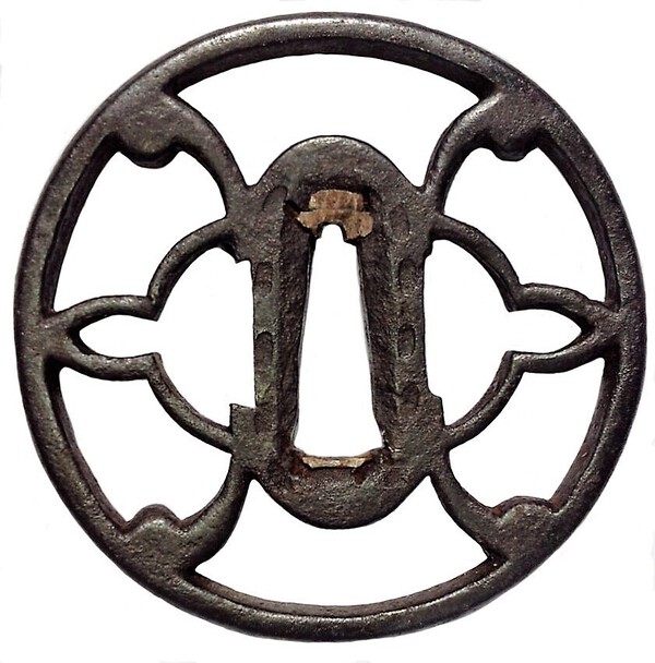

Hi,
A recent addition, I'm unsure if Owari or Akasaka but I'm drawn to Owari. It has nakabiku from the mimi to the seppa dai.
The sukashi elements look more Owari. I understand the karigane and geese in flight but not sure what the other four sukashi elements are?
Dimensions:
Height: 65mm
Width: 63.5mm
Mimi thk: 5.4mm
Seppa dai thk: 4.85mm
Welcome any thoughts please.
I find it very difficult to tell the difference between Owari and Akasaka designs- there is a lot of design overlap. This link has a guard with some of the design elements to your example perhaps it may help.
Regards Dale
Dale, Curran,
Thank you for your responses.
It is a tough one between Owari or Akasaka. The rounded mimi I would have said Akasaka but the article you posted Dale was very informative.
I'll happily say Owari.
Thanks again
Sorry I am late to this thread, but I wish to add my Owari vote. The maru mimi is a head scratcher but Owari (kanayama) will have such niku sometimes that it can appear almost a maru cross section. From your image it is a little hard to tell.
Akasaka, even later ones, will reliably have nakadaka (higher in the center) but yours is dished boasting a thicker mimi.
Kodai Akasaka were made small, but even then they were generally 7,0-7,3 cm where Owari (Kanayama, because yours reminds me of that particular production center) were smaller.
And finally, most Akasaka makers had some version of yose tagane markings much different than yours. In fact, I rather associate those tagane marks in yours with Kanayama, because of those I own that is their look. Won't typically see those in Akasaka. My 2cents
I have attached an image of a small Kanayama tsuba displaying those typical tagane marks.
Best Regards,

This. The OP's guard has a lot of meat to the rim but I'm still noticing a bevel and it seems like kaku mimi koniku as a whole vs a true maru.
Later period (early-mid Edo) Owari IMO.

Regarding the motif observations, Owari (but mostly Kanayama) will have that North/South and East/West presentation of complimentary objects- geese with fudo, gourds with ginkyo, temple bells with pine...
The tsuba Colin presented has those suhama shapes (its name alludes me today) typically seen in Owari and, of course, the geese. Mine I think are fern bracken with hats.  Both have tall seppa dai seen more in Kanayama than the general Owari.
All,
Thanks for the replies and insight.
Agree the Tagane are similar to Marks tsuba, the seppa dai on my one is a little wider.
I believe the geese in four directions is called 'shihou' but may relate to other objects.
Hello Colin T.,
Been very busy with important life things... but felt compelled to reply as I like your tsuba and these type of tsuba. I would generally agree with the member consensus here that the tsuba is like the work of the Owari group. I would add that the tsuba is likely very a very late in the groups production circa the Middle Edo Period. I will add the caveat that I cannot examining the tsuba in hand and getting a real fee for the iron which is very important for this type of attribution. The workmanship nor the openwork design itself I feel is characteristic of the unsigned Akasaka School work. I hope you find this information helpful it grows your interest and appreciation for these type of Japanese sword fittings.
Hi David,
Thanks for the comment, I agree having examined the tsuba further on the back of the previous comments by members I would say late Owari.
I do like and appreciate this style of sukashi tsuba.
Best regards
