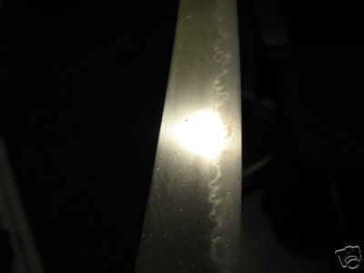

Link Posted February 4, 2009 Report Posted February 4, 2009 I just bought my 1st "good" sword Hozon papers ect. in almost new polish it's really nice ! anyway I was told by someone not to use the powder even though he gave me a kit with the powder in it. He also gave me a micro fiber cloth and siad thats all he'll ever use on a sword in good polish so I am taking his advice. However I have an old blade early edo that was mis handled over the years and is in old polish prob. done about 50 to 70 years ago and there was some minor blackish stains on the blade so I tried the powder on them and ended up mixing a little of the oil and powder and rubbed out all the stains and with a little work I can now see some boshi in the kissaki and the hada is showing up way better. I think the powder really helped that older polish. Quote

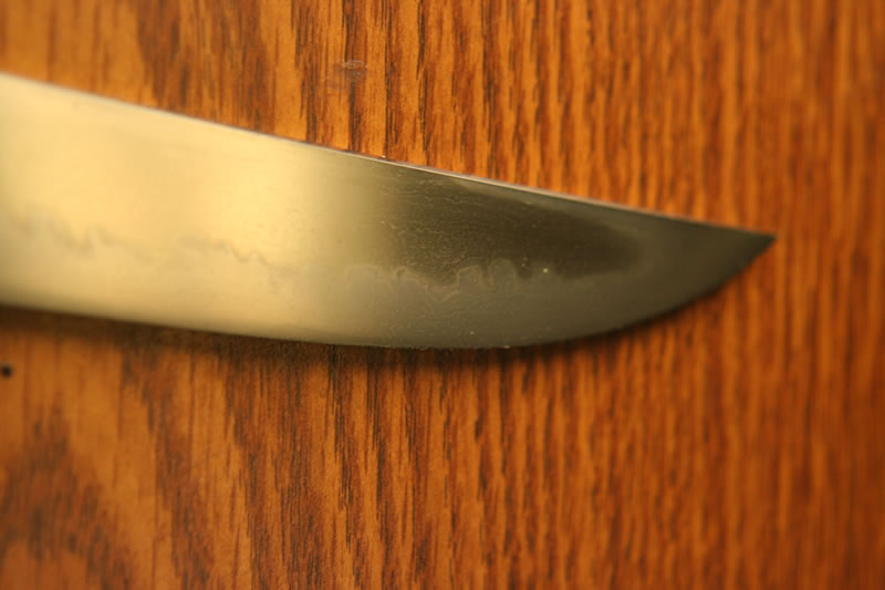

Jean Posted February 4, 2009 Report Posted February 4, 2009 Marriuszk, Roughly. If you look at an angle to the hamon and find a hamon totally different from the one you are seeing upfront you are facing hadori. For example, I have a Suruga Shimada tanto, Hirosuke. he polish shows a notare midare hamon. If you have a look at the balde from a 30° angle you will see a totally different hamon with togari, that's hadori effect. With hadori, very good polishers can give a hamon where it runs off the blade Quote
