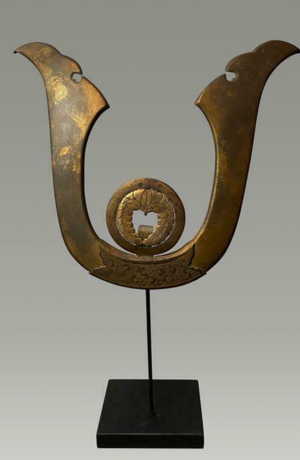

Hello dear members,
What do you think about this maedate?
it was discribed as late edo period bit i have absolutely no experience when it comes to maedate.
i doubt that it is edo,wahat do you guy think?
best regards,
Ciro

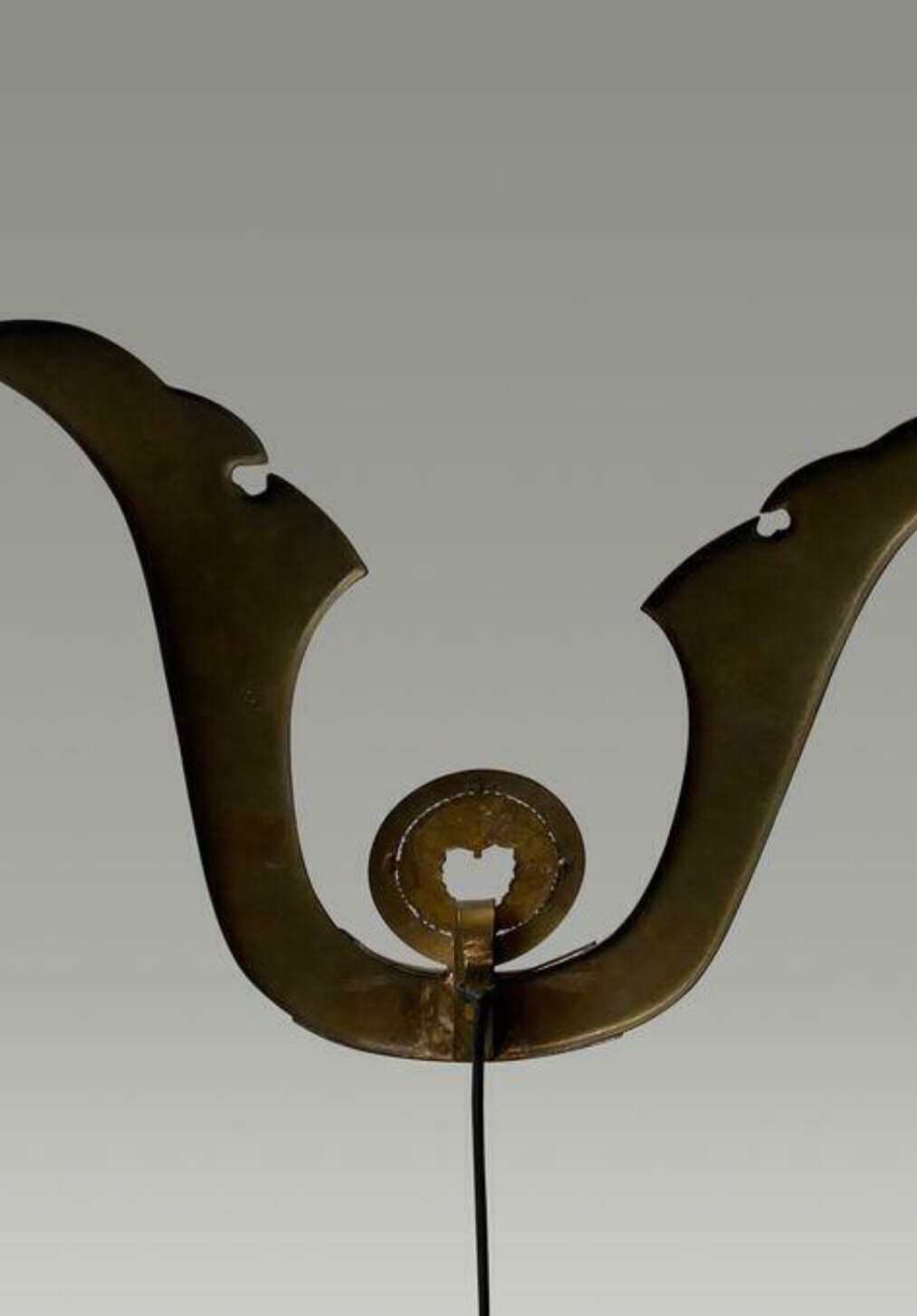

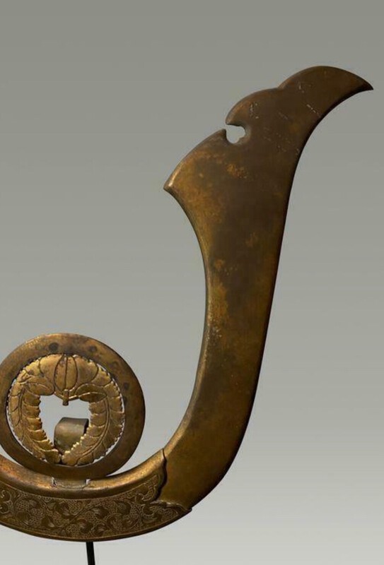

Modern and/or repro. The kuwagata and kuwagata dai are all in one piece and even then not fully formed. Even Meiji versions would have the kuwagata as separate pieces to be inserted into the kuwagata dai. This seems to have been stamped from a mold.
