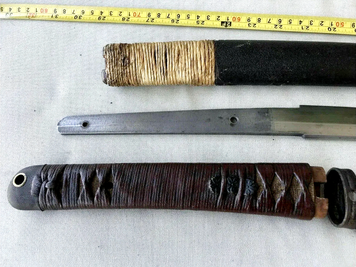

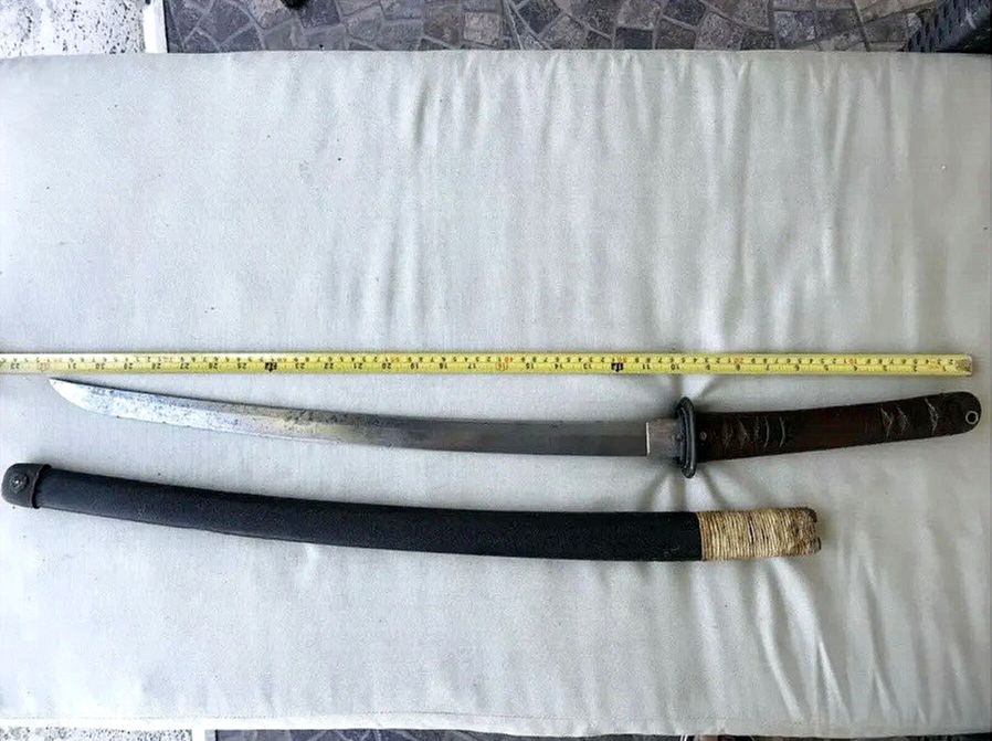

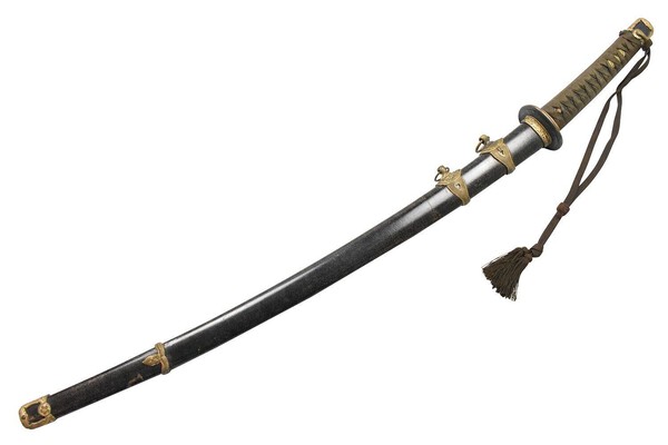

This one has me stumped. A person local to me asked me to translate his WWII katana. It is in gunto mounts, but dated with a Meiji date. It also has what appear to be arsonal marks that None of my Fuller & Gregory books show. The signature is throwing me off too. First symbol looks like Ko. Since this is a military type sword I did not post in the translation section.
Help me with this one, please! Thanks in advance to everyone.

Quite interesting!  The kanji on top are in Tensho script.  If you don't get a translation of either that or the mei soon, post it in the Translation Assistance forum.  I'll put it in the Warrelics forum too.  Nick Komiya is good at these Tensho items.

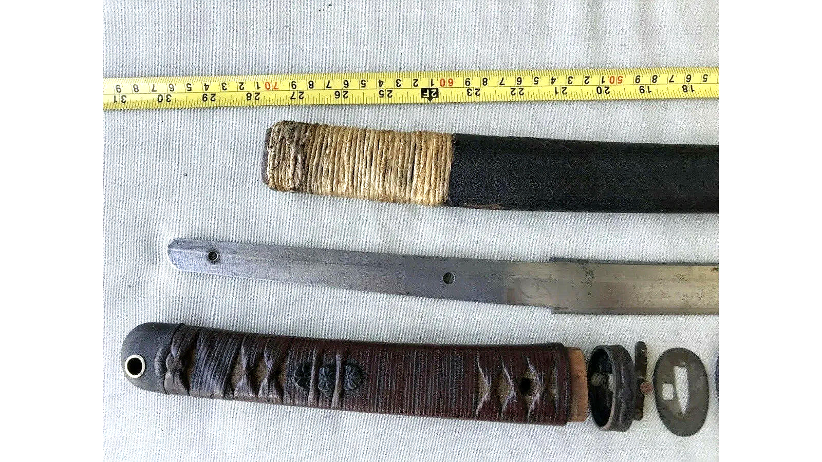

What is interesting about this one, the nakago was turned down at the end and threaded. I am guessing that it was in Kyu-Gunto fittings, then later put into Army Gunto fittings. The blade is also in the kogarasu-maru configuration...very interesting.
14 minutes ago, Bruce Pennington said:
Yes, it was definitely made for a kyugunto.

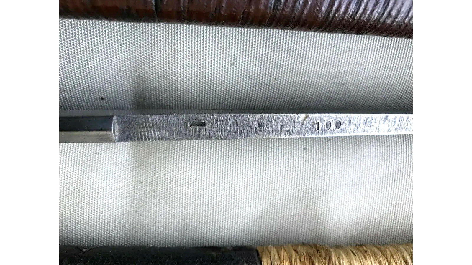

Found an odd stamped Type 0

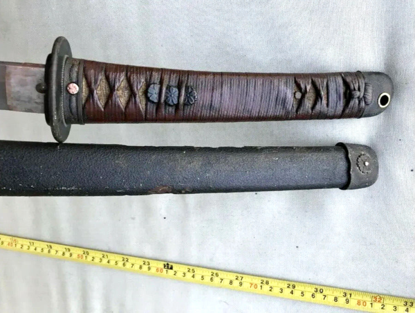

Thanks Dan, good one!  The mune numbers are not rare.  I have found them on blades of numerous smiths, almost all of them RJT, or pre-RJT, but this is the first one that was mumei.  The large "1" seems, to me, to be some sort of inspector number, while the 100 is some sort of tracking, or serialization.  The "1" stamps, and "2", and others often have arsenal stamps, too, like Osaka or Nagoya, even "Ho" of Kokura.  So, it isn't exclusive to a single arsenal.  Most of them are in RS mounts, like this one.
2.thumb.png.2baa23fd3d43430d736c09af28707daa.png3.thumb.png.6b73c9eb2ea26da36407b502955234c0.png5.thumb.png.657197d11abb51fd3949ddb452dd5434.png
20 hours ago, DTM72 said:
Found an odd stamped Type 0 on eBay with markings on the back edge of the nakago.
Thanks Dan.  I have run into this Type 100 marking variation before.  The seller of serial number 2-95 was of the opinion that it was made by Nagamitsu.  The location of the serial number on the nakago mune indicates it was made under the supervision of Ōsaka Army Arsenal.  The Ōsaka swords that are serialized on the nakago mune can be either traditional (RJT) or nontraditional manufacture.
WTS Nagamitsu sword
Just looked at a few Nagamitsu on file, and agree.  The nakago and yasurime, or almost lack of it, is classic for his style.

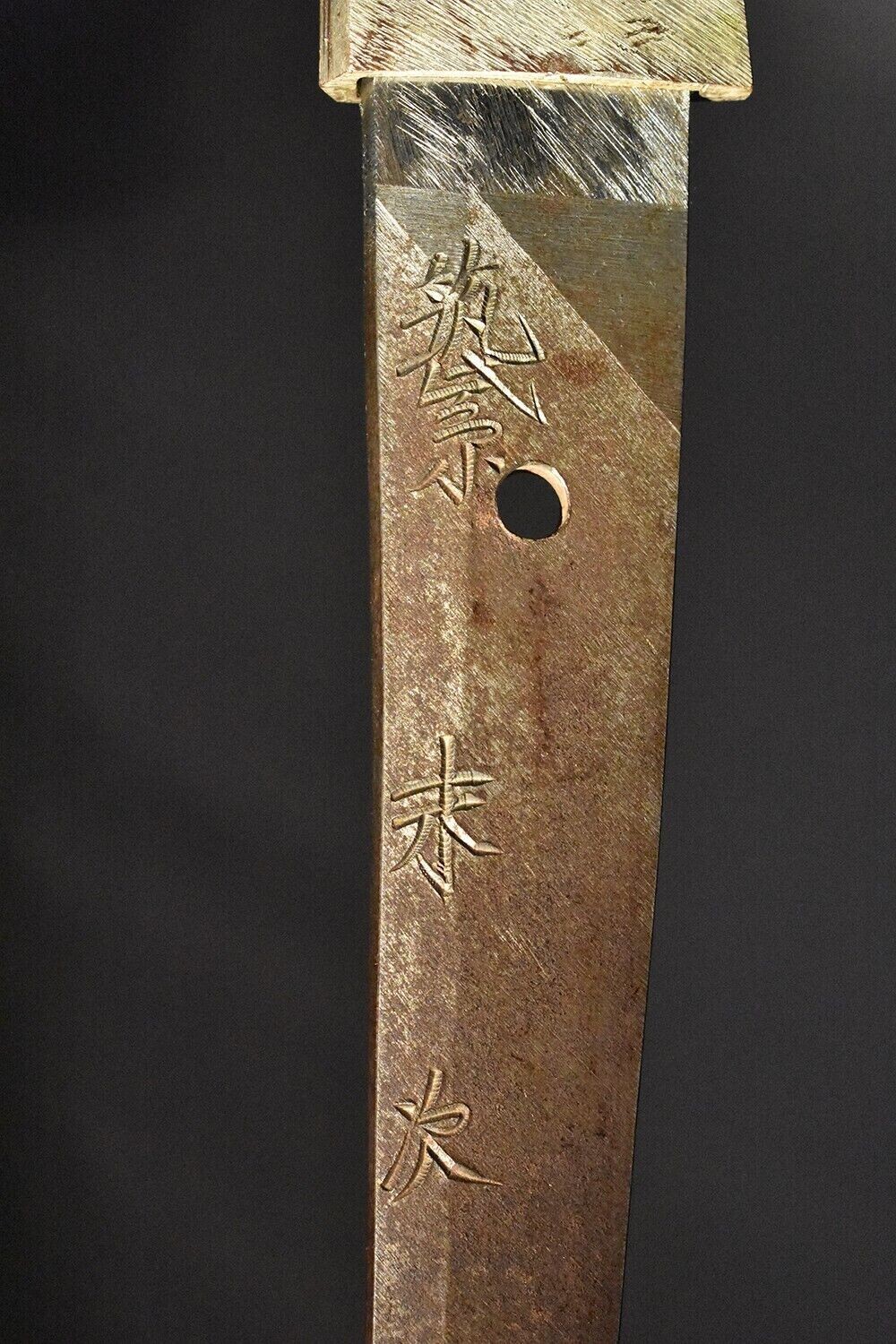

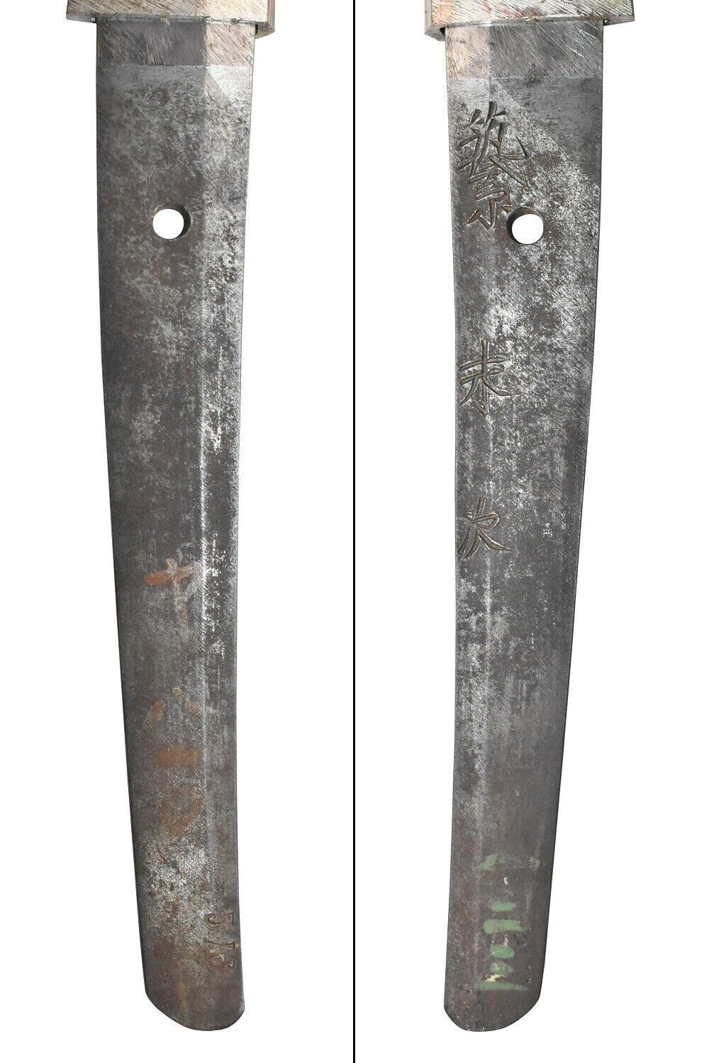

Great one John, thanks!  That's on a REALLY nice kaigunto, custom saya.  The mei says "Tsukushi Suetsugu".  Don't see a Showe era Suetsugu, but Sesko lists some from early eras, so it's likely a WWII smith assuming the name.  After some eye-balling, I'd put the number at "316".  You can just see the faint line angling down to make the 3.
@SteveM @Kiipu @BANGBANGSAN somebody care to double check my translation?  If BTW, what is the meaning of the "Tsukushi"?

Thanks Trystan!!!  An interesting update:  As I was filing this, I found that I also have a Tsukushi Shigemitsu 234, and in the Japanese sword Index, there is a "Tsukushi Suetsugu Shigemitsu" mei!
It appears to be the same guy!  For some reason, he's signed this blade with only his province and first name.  Hm.
