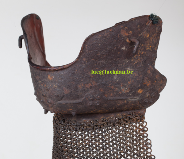

I share with you another kabuto from my collection, it is a Korean helmet dating back to the momoyama era, I also send you the state of my research on this Kabuto, do not hesitate to correct or complete :
C4DFF251-8300-4FEA-AB0D-7B90F9BC20DF.thumb.jpeg.89db09a5960b2da70eb9389ac94b9c3d.jpeg 63D3765C-226C-4602-B295-C46B70A4F16B.thumb.jpeg.5cbd2e58221da5f9c6d5f89d8ba8b450.jpeg8803F877-1542-45B5-BBF4-F69A8BA71753.thumb.jpeg.b89c55f5d4f899a9614f21a06958f04d.jpeg
The helmet consists of 4 plates by 4 metal bands riveted with 32 rivets, a mount found on many North Asian Mongolian-shaped helmets. Inside the base of the original Korean stamp there are multiple openings originally intended to secure a neck protection.
The bowl is topped with a tehen no kanamono at the top reported during reassembly, as is the koshi-maki and the tsunomoto. The mabizashi which replaces the original visor is bordered with a braided edging of silver copper wire (I have not found this type of decoration on any other kabuto ?).
the openwork iron mon in the shape of a golden melon flower (shiho-mokko) is applied to the mabizashi. Mon used by the IKEDA clan (Settsu-Ikeda branch).
The helmet was most certainly brought back from Korea during the Imjin wars (1592-1598), samurai of the IKEDA clan participated in the second invasion under the command of IKEDA Hideuji (池 田秀氏) who was one of the 6 generals (2800 men) of the right wing army under the command of MORI Hidemoto during the second invasion of Korea (1597-98). Stephen Turnbull, Samurai Invasion Japan Korean War 1592-1598, p240).
A Joseon kabuto reassembled with an identical helmet that belonged to TORII Mototada (heroic commander of The defense of the castle of Fushimi prelude to the battle of Sekigahara) is kept at the Seichu shrine in Mibu-cho, Tochigi prefecture (Illustrated Sengoku armor collection - definitive edition (2) (Gunzo history series) ISBN: 405603642X (2005)

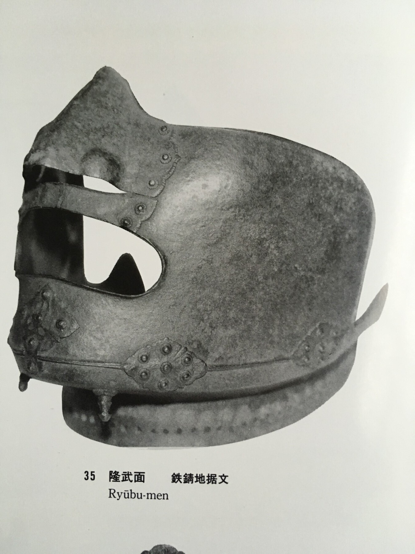

A Korean helmet with a similar stamp that belonged to Ryu Seong-ryong (state councilor)who wore it during the Imjin war (Advanced Center for Korean Studies, Cultural Héritage Administration Trésor n° 460)
You mentioned a Korean stamp or mark. May we (wife and me) see it?
As your title said, it looks much more Namban <=> Spanish / Portuguese influenced than the original korean pillarheads. Bluntly:  yours is more elegant than most of the Korean helmets.

On the Korean origin of the helmet: I found two arguments in favor of this hypothesis:
- The boshi comes from "RUNJEET SINGH" a British antique dealer from Asia who attributed to it a Korean origin.
- It is very similar to Korean helmets from the same period, like the one that belonged to Ryu Seong-ryong, the mounting of the helmet is very similar; a four piece bowl of russet iron, joined vertically by means of riveted winged straps with a median ridge, a method that can be found on many north Asian helmets of Mongol form.
Finally, the presence of samurai from the IKEDA clan under the command of IKEDA Hideuji ( 田秀氏), one of the 6 generals of the right-wing army during the second invasion of Korea (1597-98) is confirmed. in two books that of Stéphane TURNBULL (Samurai Invasion Japan Korean War 1592-1598, p240) and that of Georges Sansom (A History of Japan, 1334-1615. Stanford University Press. P. 353), these books are available, in part , under google book and a search can be done using the name "IKEDA Hideuji" under google book.
there is a Nanban helmet which is completely identical to this one (except the parts reassembled in Japan). This named Kabuto having belonged to TORII Motodata is exhibited at the Seichu shrine which honors Mototada in Mibu-cho, Tochigi prefecture.
This is what I was able to find in my research.

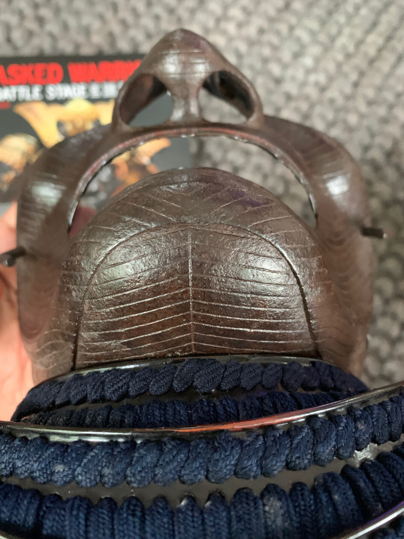

this is one of the more scarce Iwai men.   Are there file marks on the teeth?
One of the characteristics of this variation is the lack of the nagashi no ana, and the file strokes on the teeth.
I don't know if it is objective to link it to Yozaemon, but it is one of the finest Iwai one can find.
Mine shares many of the same characteristics as Alain's, including the lack of ase-nagashi-no-ana. No file marks on the teeth. Here's a pic underneath the chin. Besides Alain's very plausible idea that these were made for show or display, I'd like to hear other theories as to why there is no ase-nagashi-no-ana.
Yes the tehen and the interior without shikoro and ukebari35574145-CA5B-4570-BA48-8EEAC3A68D40.thumb.jpeg.4e304cc582279df022e2f325981dad33.jpeg
at the base of the original Korean bowl (above the shikoro) there are multiple openings originally intended to secure a neck protection

Luc in fact I had not noticed, it have file strokes on the teeth, very interesting..
it is a kind of Yasurime.   This is the only type of men I know with this feature.
very rare.
That’s right!
Also in this category of men seldom seen…
At least equally interesting is the missing ase nagashi no ana 🧐

Thanks for the images Alain, I agree with you, it looks like it was originally a Korean helmet that was converted into a kabuto, likely during the Momoyama period. The Shikoro looks to be a later addition?
