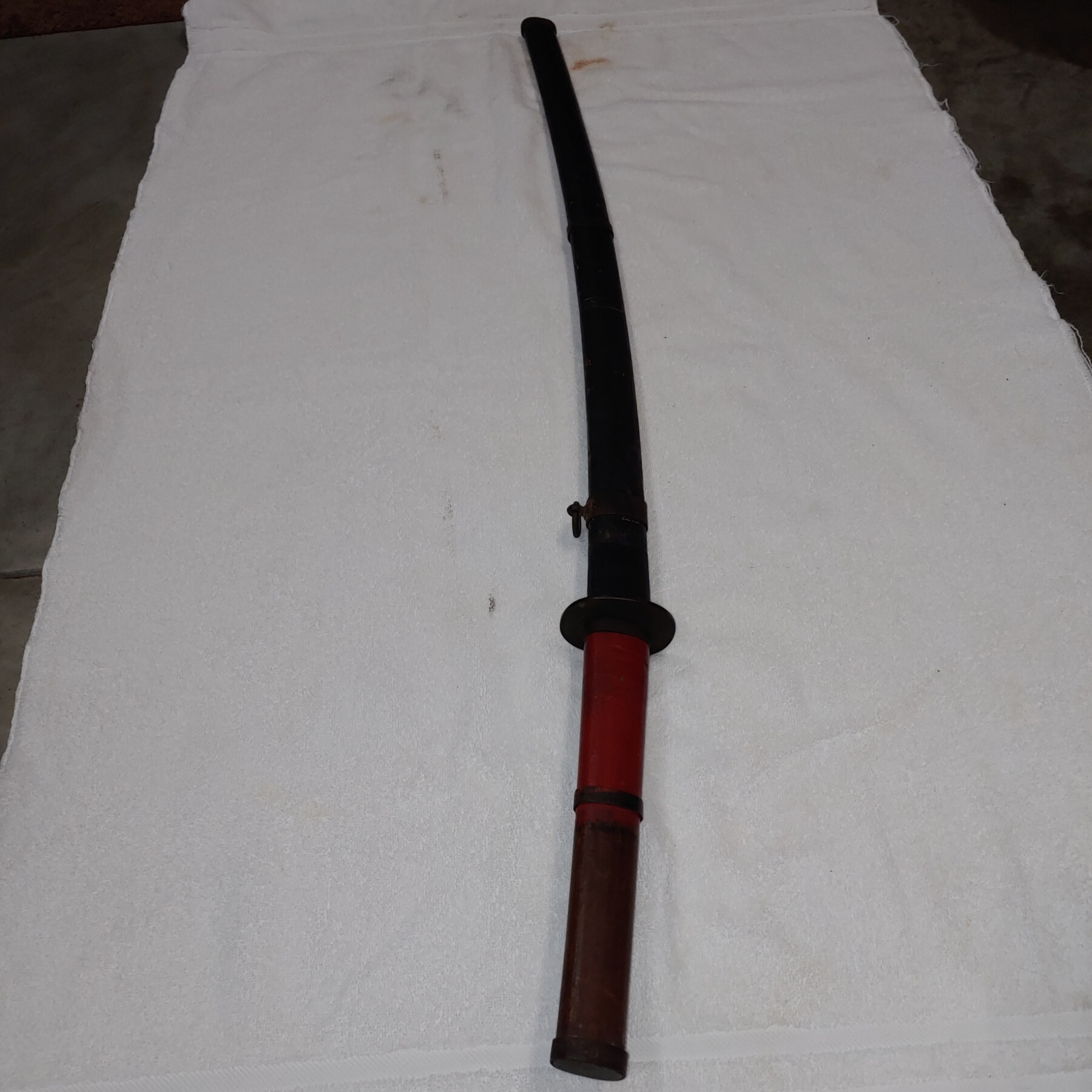

Cire69 Posted August 23, 2021 Report Posted August 23, 2021 I have had this sword in my collection for several years. I got it from a friend who's father had in for as long as he (the son) could remember. My initial impression was this was a "tourist" type sword but I figured if I had the translation of the kanji it might lead to a better understanding of where it came from and what it might actually. There are no other markings that I have found. The koshirae is a simple wooden tsuka and saya with plan steel rings and a plane tsuba. Thanks you! Quote

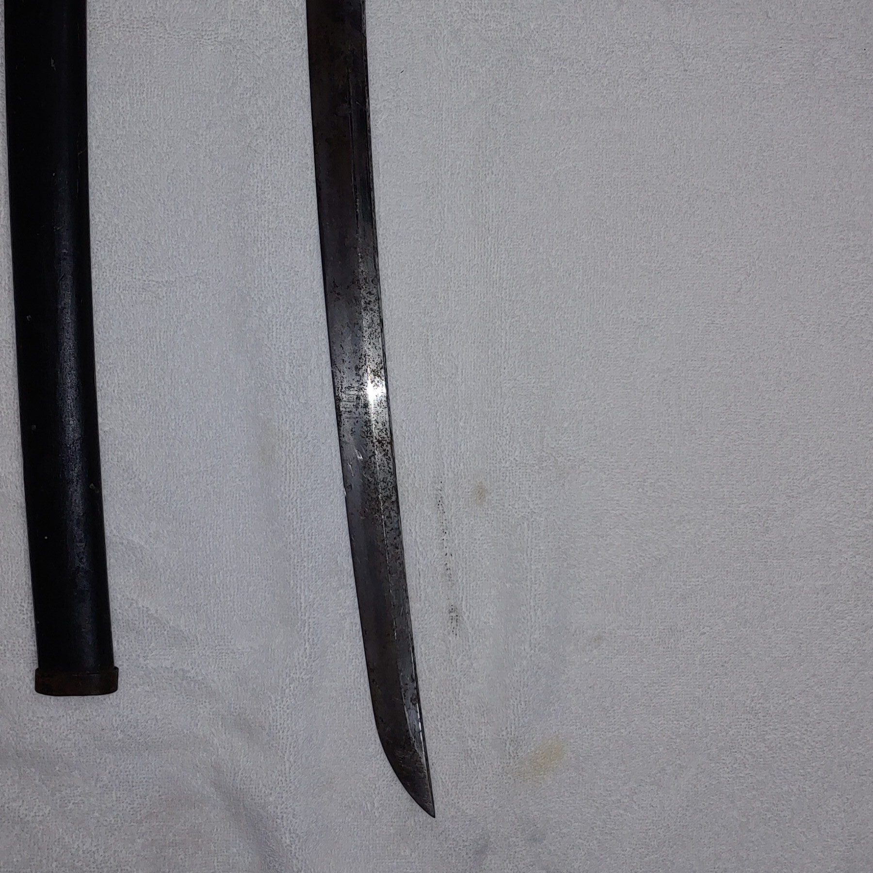

DTM72 Posted August 24, 2021 Report Posted August 24, 2021 壽命 = Jumyo The mekugi-ana (hole on the tang) appears to be punched, not drilled. This usually indicates an older blade, but we all need to see the complete blade and tip of the blade to give you a better assessment. So far, I would say it is NOT a cheap tourist item. 1 Quote
raaay Posted August 24, 2021 Report Posted August 24, 2021 Hi Dan , sorry too disagree , but it looks like a drilled hole to me , you can even see the burr marks , IMHO i would say it is a Showa sword , we need more photos to be a 100% 2 Quote
DTM72 Posted August 24, 2021 Report Posted August 24, 2021 On 8/24/2021 at 3:55 PM, raaay said: Hi Dan , sorry too disagree , but it looks like a drilled hole to me , you can even see the burr marks , IMHO i would say it is a Showa sword , we need more photos to be a 100% Expand Fàilte Ray. I based my opinion on the size of the burr on the top side of the hole. Look at the shadow. Drilling generally will not leave that large of a burr. Your opinion of Showa is a reasonable opinion based on the cleanliness of the nakago and absence of any darker colors that would indicate an older blade. We can probably agree that we need more info than just the nakago picture to really give an accurate assessment of it. Have a pint of Strongbow for us both...I could really use one right about now. 1 Quote
Cire69 Posted August 24, 2021 Author Report Posted August 24, 2021 Thank you all for your input. I have uploaded some more pictures to hopefully help answer some of the questions. Quote
Cire69 Posted August 24, 2021 Author Report Posted August 24, 2021 Here are a few others that better show the koshirae. Quote
Cire69 Posted August 24, 2021 Author Report Posted August 24, 2021 Here are a few better pictures of blade and the habaki Quote
