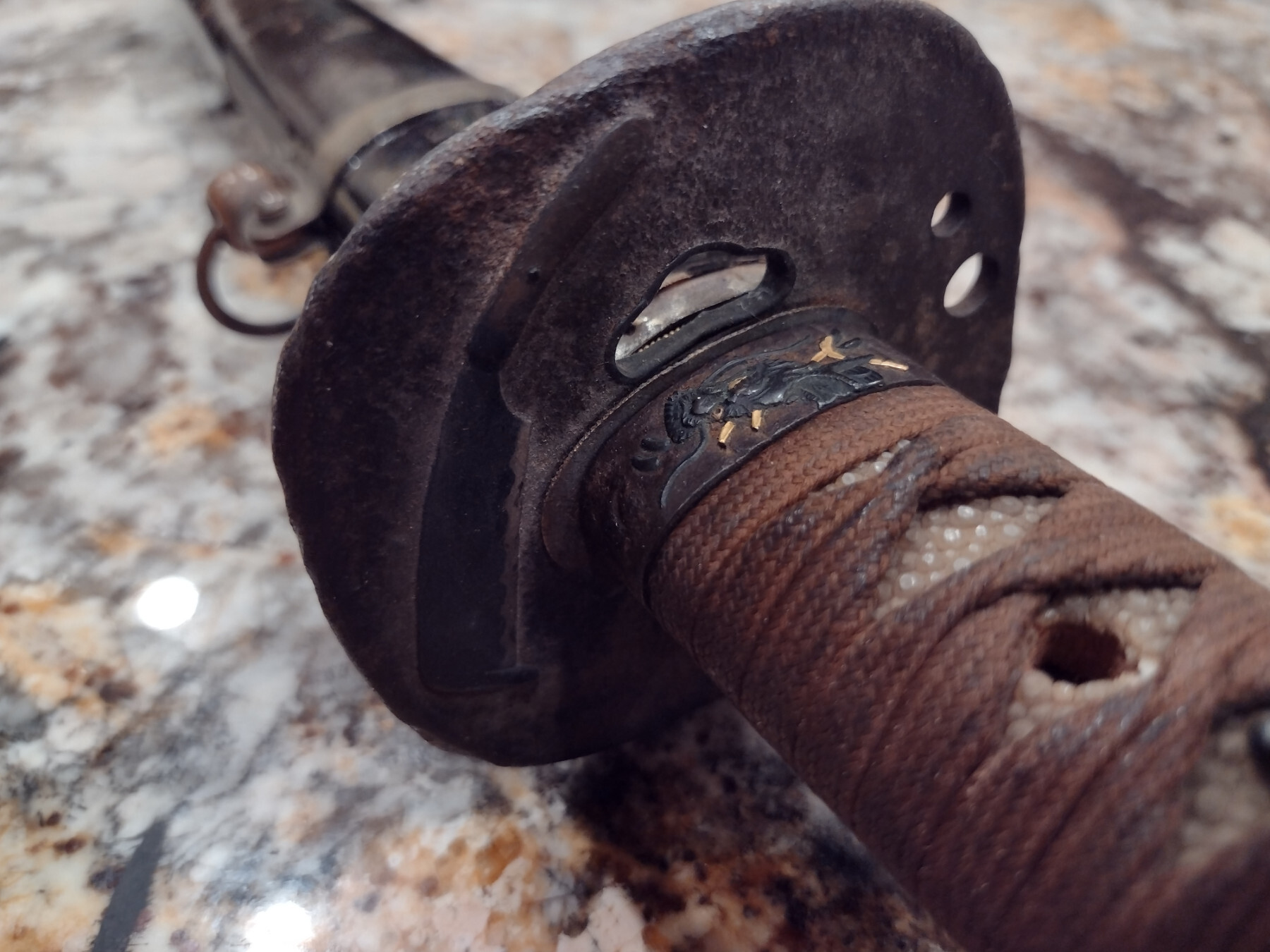

Matting2 Posted August 23, 2021 Report Posted August 23, 2021 Quote I received this sword from my parents estate. They were given 2 swords from a friend that was a WW2 army vet. around 45 years ago when I was a small child. they were kept in the closet all of those years and I am trying to get some information on the older one. The second sword is a mass production sword from WW2. the older sword is obviously more than that and I would like to get some information on the sword or its sword smith for my new family heirloom. It appears to be made from Shigimasa but there are no other markings on the tang Quote

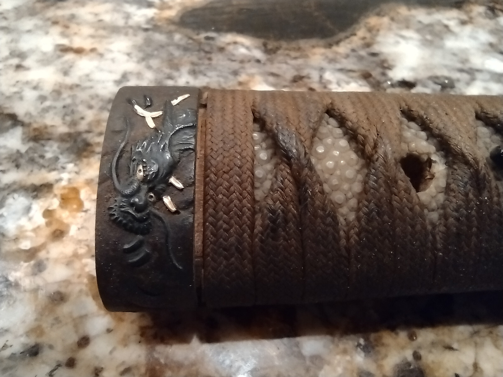

DTM72 Posted August 23, 2021 Report Posted August 23, 2021 重正 Looks like Shigemasa I am unable to find any matches for this signature. The blade appears to be older than WWII and the signature does NOT match the WWII smith Ikkansai Shigemasa. That being said, this looks to be an authentic Nihonto. Unfortunately, I personally cannot find a match to this particular smith. The tsuka (handle) has a sarute (d-ring) that was added, and not a normal configuration for this style of handle. There is a blue/brown tassel is company grade officer tassel affixed to the sarute. This would be found on a military issue gunto, not a civilian type sword like yours. The iron tsuba appears to be Edo period and the saya (scabbard) appears to be WWII. Need a better pic of the saya to tell you more. It also arrears theat the ashi (suspension ring) is upside down. WWII gunto were made to be worn in the style of tachi, which is edge down. I am guessing someone flipped the ashi to mount the sword edge up, as a katana should be. Need better pics of the blade, close-up) to give you a better idea of what you have. Quote
Geraint Posted August 23, 2021 Report Posted August 23, 2021 Dear Mark. As Dan says this one seems to read Shigemasa and it is not a WWII sword but rather earlier. It is in civil mounts which have been adapted for use in the war by the addition of a loo for the tassel and a ring to the scabbard to suspend the sword from, it may have originally had a leather combat cover. The fittings are quite nice and the condition of the blade looks fairly good given it's history since the war. Resist the urge to clean anything, just keep the blade lightly oiled. If you measure from the tip to the notch on the back of the blade where the metal collar sits what length do you get? All the best. 2 Quote

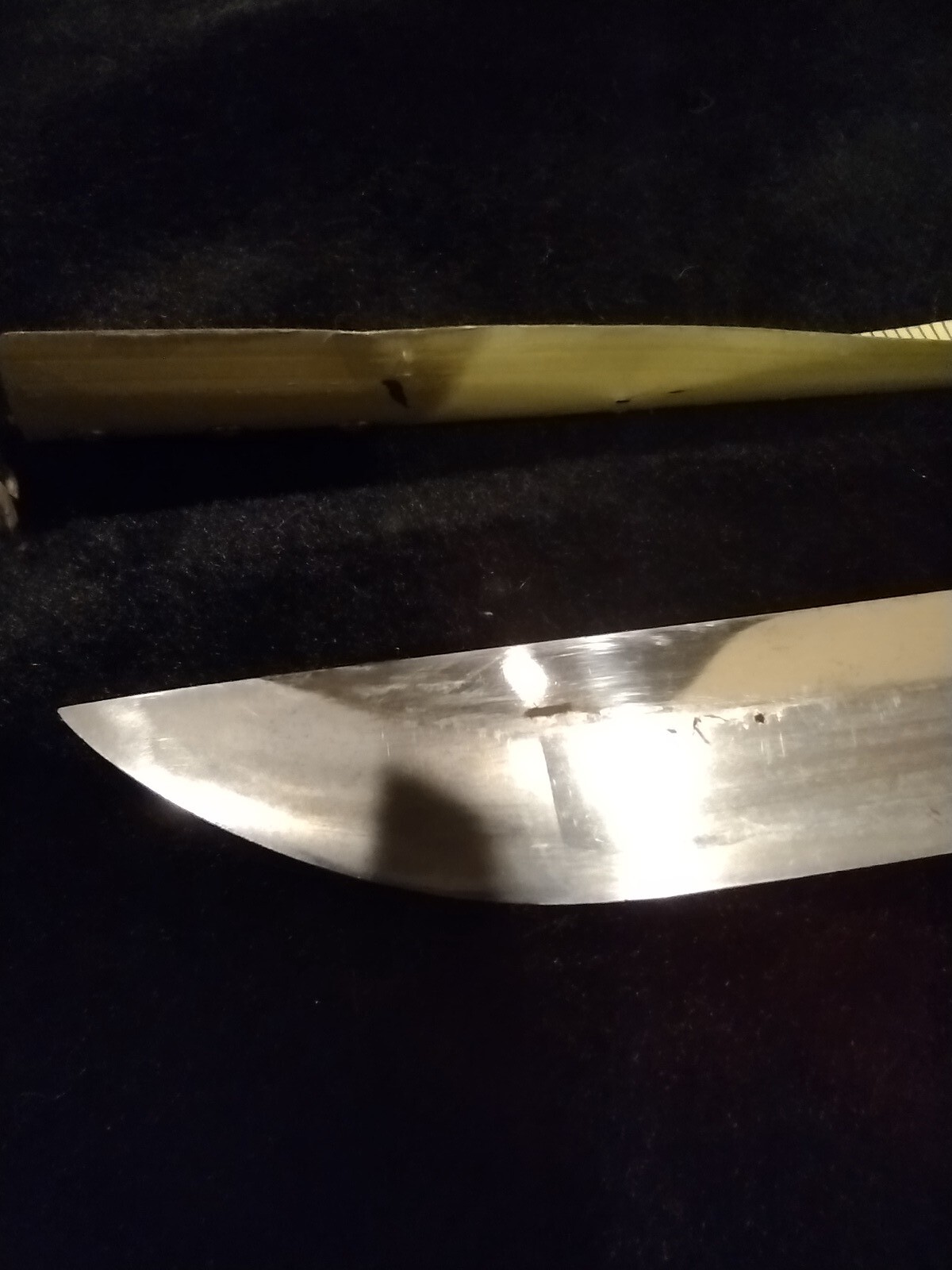

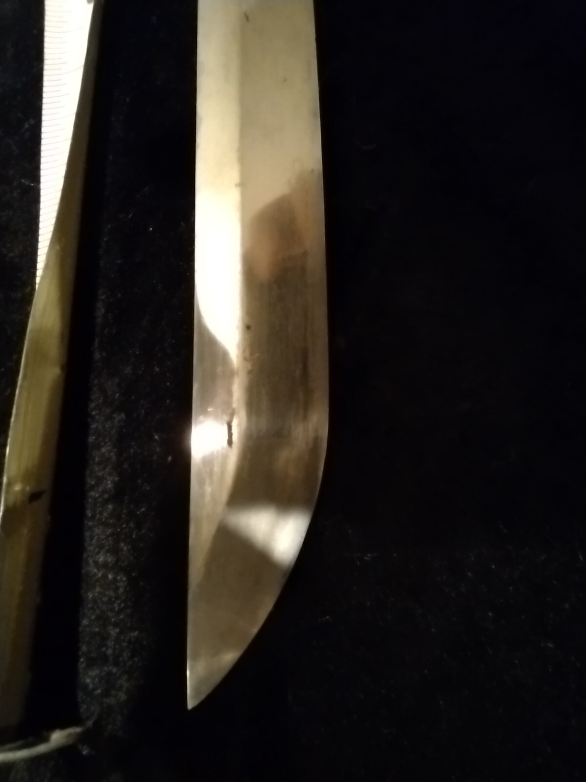

Matting2 Posted August 24, 2021 Author Report Posted August 24, 2021 The black stuff near the tip is something on the blade not rust. You guys told me not to clean it. I hope these help with the Shigimasa mystery and thank you again for all of the incredible help. I will post pics of the other sword tomorrow Quote
Matting2 Posted August 24, 2021 Author Report Posted August 24, 2021 Almost forgot the most important one Quote
