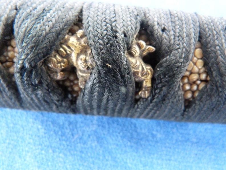

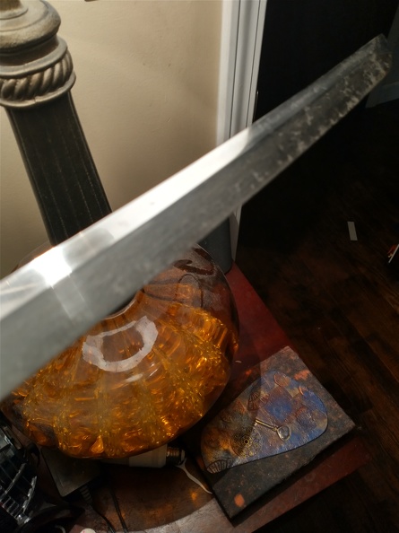

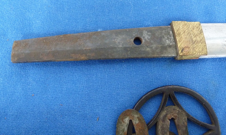

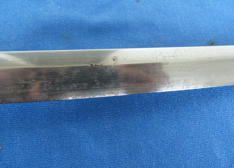

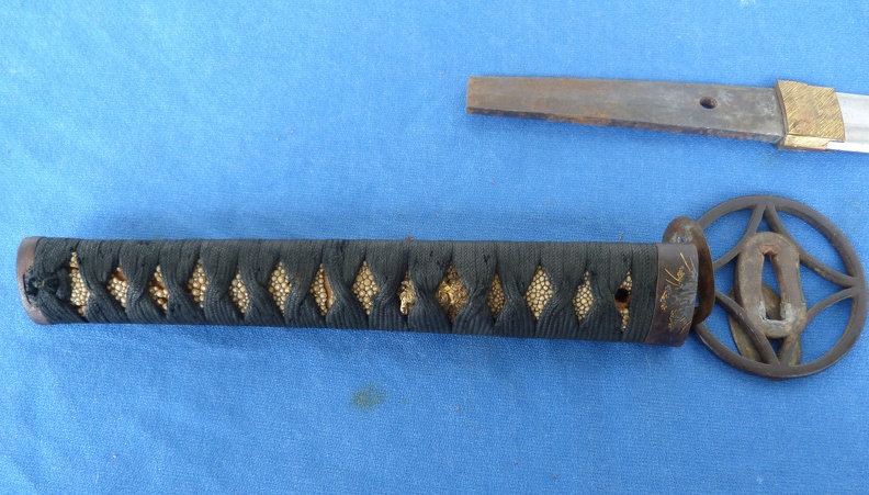

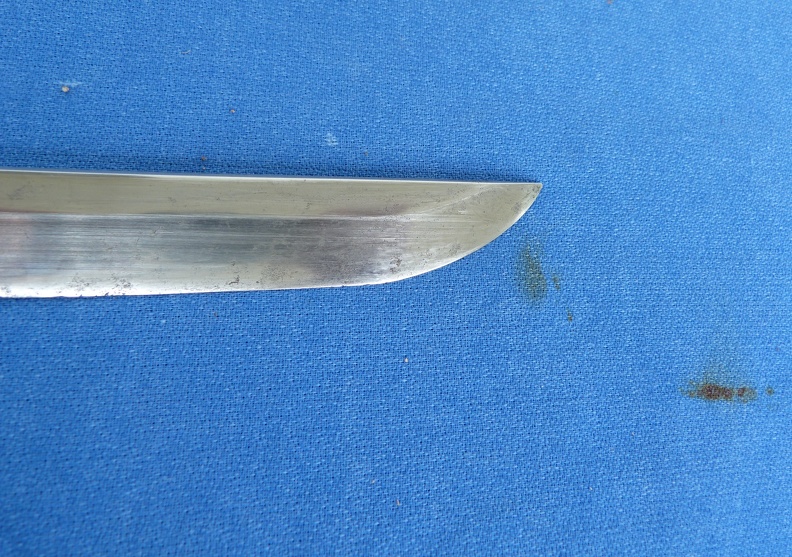

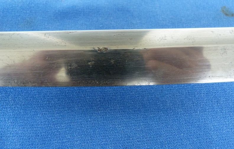

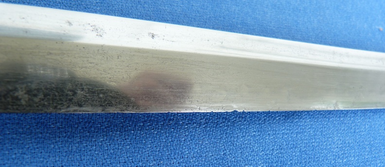

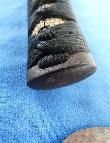

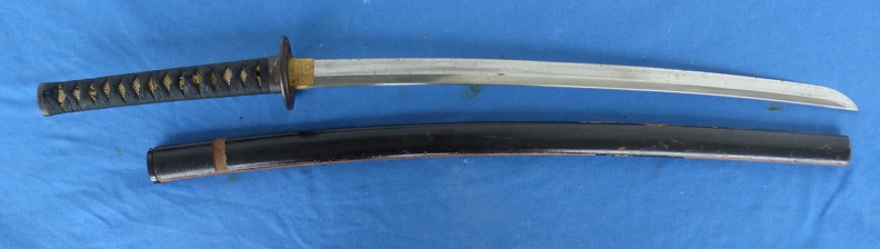

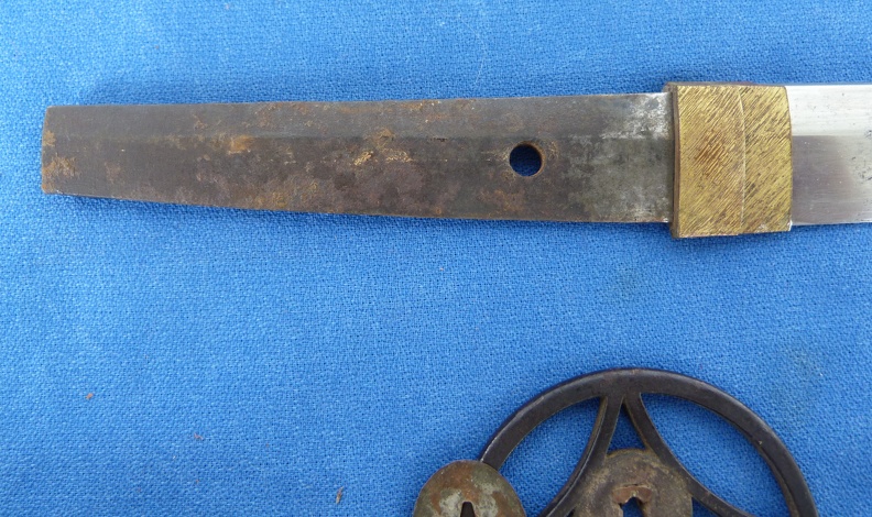

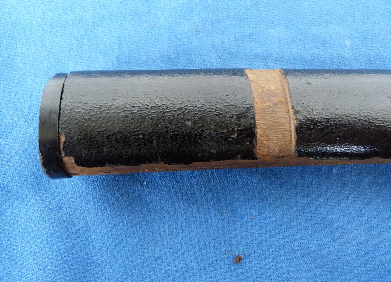

Worn, but traditional.  It doesn't appear to be a high end piece. I see at least two forging flaws on the shinogi-ji. The hamon is faint and I'm terrible at getting pictures of them.
Any information appreciated.

I actually kind of like aged and worn fittings like yours.
To be honest, the mirrory look and scratches across its length make me worry the sword was buffed, maybe as an improper way of removing rust. I guess the good news is that by taking it, you’ve saved it from further damage.
Right now the features are not very discernible, but perhaps if you use very fine uchiko, like what Robert benson sells, you can make the hamon  and hada easier read. Obviously it wouldn’t be a good idea on an in polish sword but since yours isn’t at all, and may have been buffed, it might  help make it easier to read. This has an explanation http://web.archive.org/web/20191102061738/http://www.sydneytokenkai.com/new-page-14.htm

I doubt the sword is worth much at all.  I've had one low offer.  I'll take it to a show here and see if it does a bit better.  23" blade, so long wakizashi, and everything is worn.
The existing fukure will get worse with any non sensitive polish; if polished, the togishi will have to work around those. Not a job for an amateur. Probably not cost effective, imo.
