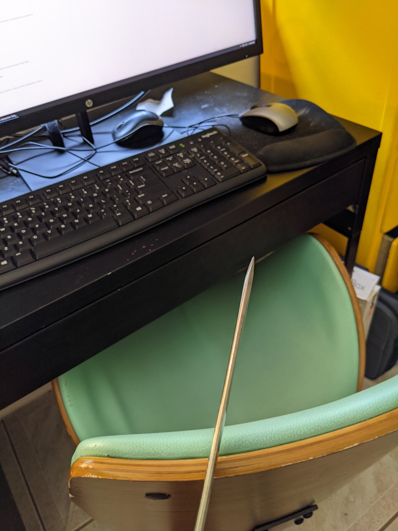

10thRoyal Posted August 23, 2021 Author Report Posted August 23, 2021 @Surfson you make a good point. I have emailed Tod but am not expecting him to say that the net value is greater after polishing than it is now. Honestly, this whatever he says I would say I am in a win-win situation for sure. Something I noticed about number 9, that I unfortunately do not have the terminology knowledge to properly describe, is that the thickness of the mune decreases from the habaki to the just before the kissaki at which point it quickly becomes thicker. This morphology reminds me a bit of the change in thickness along the mune of my naginata. Is there a proper term for this and does is signify any particular school or period? Or is this simply an effect of polishing a particular way? Quote
O koumori Posted August 23, 2021 Report Posted August 23, 2021 This sugata is known as U no Kubi-zukuri or "cormorant's neck." Dan K Quote
Geraint Posted August 23, 2021 Report Posted August 23, 2021 Dear Michael. With respect to Dan I think this is the effect observed when there is a raised or high shinogi. All the best. Quote
10thRoyal Posted August 23, 2021 Author Report Posted August 23, 2021 If I am understanding this correctly, it appears that the sakikasane and shinogi height are increasing together, with the sakikasane increasing faster than the shinogi height. Following the contour of the blade with a cloth, there is a definite "bulge" at the kissaki. Forgive me for any errors in terminology. Quote
Geraint Posted August 24, 2021 Report Posted August 24, 2021 Dear Michael. Have look here, http://www.ksky.ne.jp./~sumie99/shaping.html Just below the photograph is an illustration of kissaki which shows what your sword appears to be like. All the best. Quote
