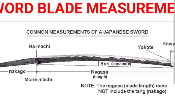

Although the ruler is extended from kissaki to past the nakago, because I had troubles holding the measuring tape in alignment with the sword. The number I recorded was a proper nagasa measurement (kissaki to munemachi and not measuring the nakago).
The deepest curvature of the sori (same here on it being measured only by the nagasa despite the ruler extending past the nakago):

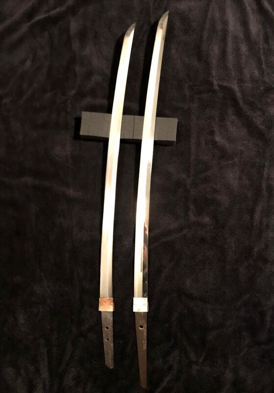

Note the following two pictures in regards to discussion on the sayagaki below. It's the lower mekugiana that fits this shirasaya, and the fitting isn't perfectly snug:
2 mekugiana and suriage:

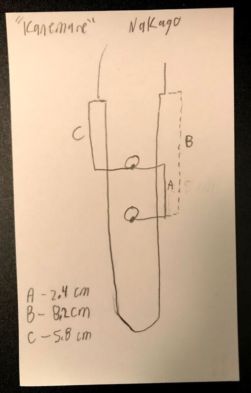

Crude drawing of measurements of nakago:

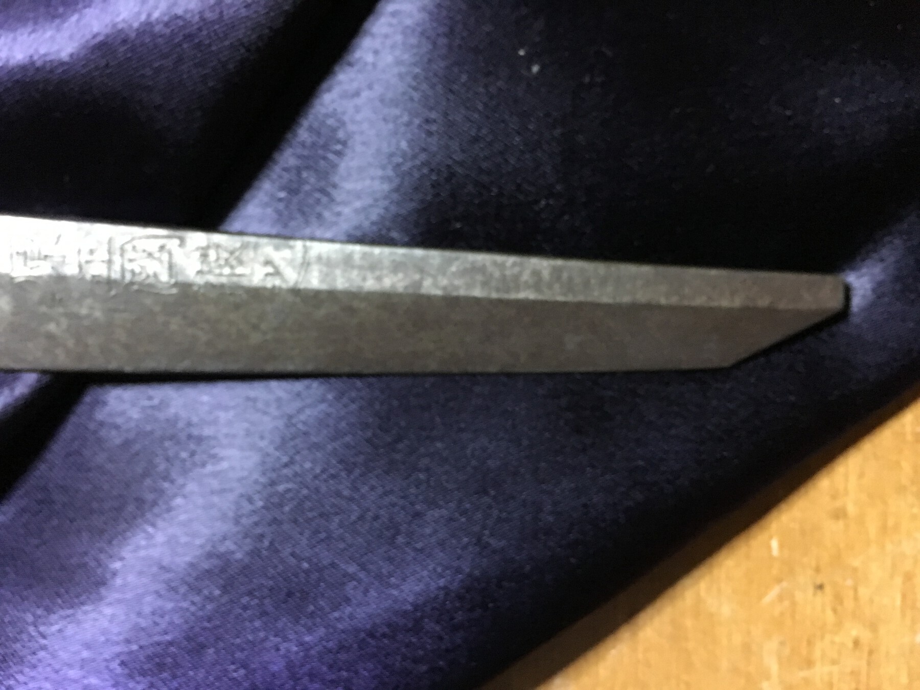

Quite small Chu-Kissaki. Pencil for scale

You are adamant that the sword is suriage but why?  One image we don't have is of the nakago without the habaki but from what we see here suriage is not evident to my eye.
Your diagram of the sori measurement still has the tape running from nakago jiri to kissaki whereas it should run from the mune machi to kissaki, as per Stephen's post on your other sword.  Would that change things?
As regards the fit in the shirasaya, does the nakago fit well apart from the small gap?  In your image of the whole shirasaya both parts seem to align well, if this is the case wit the blade in place then it is most likely the right shirasaya.  The habaki appears to fit the blade well but sometimes the habaki can become a little damaged where it fits the machi, bruised a little, and this can result in the ort of gap you illustrate.
Just as an aside, Shinto Kashu swords tend to have a distinctive nakago jiri, have you come across this yet?

Here's an example of the Kaga nakago jiri that Geraint mentioned. This may be a silly question, but have you found any other examples of blades by this smith either on the internet or in reference books? He doesn't get a mention in Hawley's and nothing pops up in a Google search for me - that may mean something or nothing but having a verified example to compare with yours would help with identification.
Couple points.
Habaki should be removed when measuring and showing sugata.
Second your still measuring from nakago
Measure from munemachi to tip.
See line that shows sori.

@Stephen I also got a private message about the nagasa and sori measurement, so I realize the photo must be misleading. I measured correctly, just have the measuring tape going past the nakago. I found it difficult to hold the tape and the sword, so I extended and locked the tape past the nakago and then just wrote down the proper nagasa measurement.

Hmm, interesting. The dealer told me it was suriage, so that could be confirmation bias on my part. That said, the judgement came from the fact that there's two mekugiana, and the nakago feels stubby. It's small enough that you almost can't get a full fist around it. Given the length of the sword, that seems off. Lastly, the sugata shape seemed like it was missing a bit of its curvature. Could you please say a bit more on why you think it's ubu?
Other than that gap, the nakago in the shirasaya feels perfect. Maybe that's not a strike after all.
