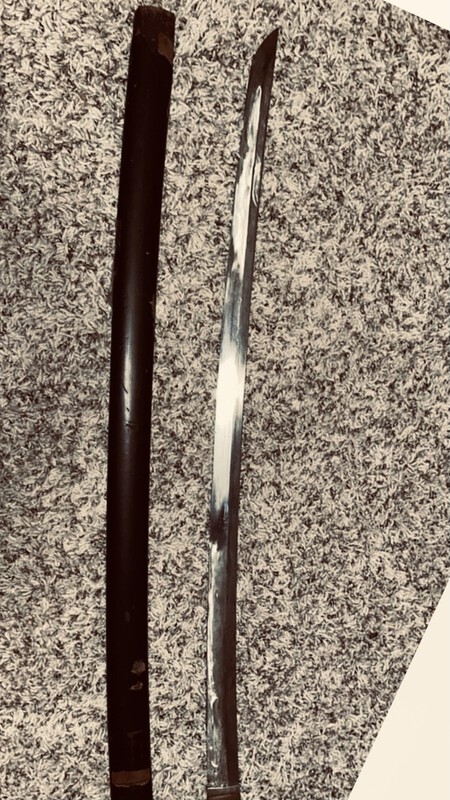

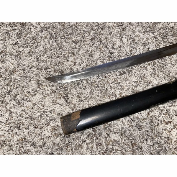

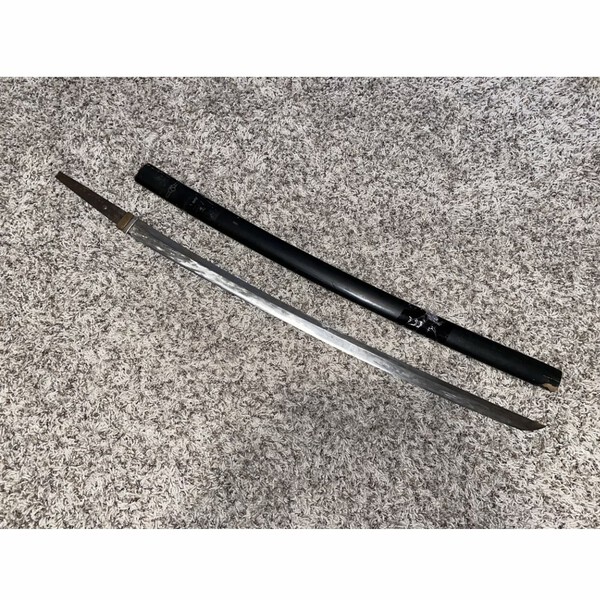

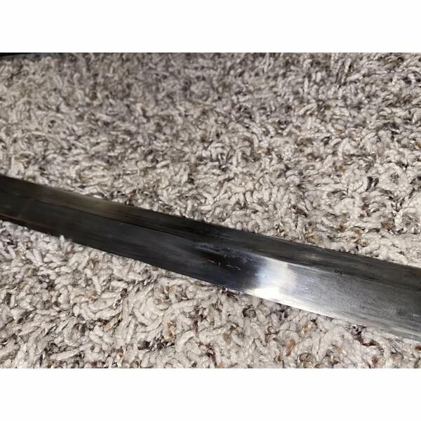

Utopianarian Posted August 16, 2021 Report Posted August 16, 2021 Recently acquired blade on eBay. Blade 27.25 inches cut down blade. Apparently it was sadly buffed down by someone in an amateur attempt to clean blade. The shape appears intriguing to me maybe late kamakura/Nanbokucho. The auction seemed to have a lot of interest for a blade in such condition being 18 bidders trying to obtain this blade. I paid $920 plus shipping and tax to win auction which I don’t know yet if that was a smart move or not. It comes with nice two piece Habaki. Hard to see hamon in photos. What are your thoughts based on limited pics. Thank you Quote
PNSSHOGUN Posted August 16, 2021 Report Posted August 16, 2021 Looks like a real headache, not sure what you're seeing in this one. Quote
mywei Posted August 16, 2021 Report Posted August 16, 2021 Looks like someone has taken the blade to a grinder to buff it? Going to need a lot of further investment to restore the blade which may or may not be worth it in the end - as long you're aware Quote
Utopianarian Posted August 16, 2021 Author Report Posted August 16, 2021 Yes, You are right. Further investment for sure for proper polish. The shape appears like early blade and looks like there still is a lot of metal on blade despite the amateur buffing. Just wanted your thoughts regarding blades shape and possible era Quote

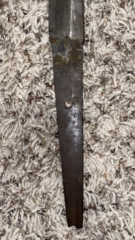

Utopianarian Posted August 16, 2021 Author Report Posted August 16, 2021 Here is A pic of 2 piece Habaki that it was fitted with. I know it’s a gamble but fun to find out more about the blade in the future 2 Quote

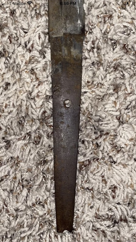

AntiquarianCat Posted August 16, 2021 Report Posted August 16, 2021 I hope it’s not rude to ask, but was the vendor someone like Showa22? It reminds me a lot of his buffing jobs. Personally I try to stay away from those since it causes geometric damage to the sword, obscures most features you would use to appraise, and getting a proper polish to fix it is going to cost many times the price of the sword. Also if the grinder has removed too much metal, upon a polish it will be tired at best. Your hamachi is also pretty worn, indicating it might already be tired. I like the nakago and suriage shape regardless. For some reason suriage swords are cool in my head. It sort of testifies to their character and continued use across multiple periods. Quote

Brian Posted August 16, 2021 Report Posted August 16, 2021 Someone spent a lot of money on that habaki, so they valued the sword. Good luck, it's always a gamble. 3 Quote

French nihonto Posted August 16, 2021 Report Posted August 16, 2021 The problem is that habaki is almost more valuable than the blade. (market value of course). On the other hand, it is possible that the blade is a beautiful historical value if it is kamakura. cordialy Quote
mywei Posted August 16, 2021 Report Posted August 16, 2021 For what it's worth I agree it looks koto but not sure based only on sugata. Could also be muromachi imo Quote
ROKUJURO Posted August 16, 2021 Report Posted August 16, 2021 I don't see a very early blade. To me it looks more like KANBUN era. 1 1 Quote
Bazza Posted August 16, 2021 Report Posted August 16, 2021 I thought Shinto ... Hey George, do stay please. I've immensely enjoyed your posts. BaZZa. 1 Quote
paulb Posted August 16, 2021 Report Posted August 16, 2021 Think I am in the shinto camp too. I would guess early Edo but that is purely on shape. I don't see anything that suggests Kamakura or Nambokucho but again that's just based on shape and nakago. As Brian says someone valued it to have that habaki made for it (assuming it isn't a swap) but it is a gamble good luck and keep us posted with what you discover 1 Quote

Stephen Posted August 16, 2021 Report Posted August 16, 2021 My opinion really doesn't matter because your going to do what you're going to do anyway. Patina on the nakago looks late shinto, the sugata remind me of a loyaltist blade. Good luck on future rolls of dice. 1 Quote
Bruce Pennington Posted August 16, 2021 Report Posted August 16, 2021 On 8/16/2021 at 3:16 AM, Utopianarian said: Here is A pic of 2 piece Habaki that it was fitted with. I know it’s a gamble but fun to find out more about the blade in the future Expand Thanks for the close-up! Threw me at first .... I thought "Wow, never seen a triple habaki before" but then realized the outer piece had protected the original finish underneath on the second piece, giving it a 2-tone look. 1 Quote

Alex A Posted August 17, 2021 Report Posted August 17, 2021 Reminded of Kanbun too Also, maybe not suriage but made to look suriage and if suriage, no great care was taken and the nakago looks a bit odd now, which is not a good sign. But anyways, good luck. Quote
AntiquarianCat Posted August 17, 2021 Report Posted August 17, 2021 I guess some of the pictures do give it a fat middle that tapers later on, like kanbun. It also doesn’t have the robustness or big kissaki I’ve gotten used to with nanbokucho so I wouldn’t be surprised if it were kanbun after all. Although the buffing and other wear probably makes it hard to look for features that would narrow things down better. The only question then is why would a Kanbun look osuriage? Was this an attempt to make a newer sword look older? That reminds me a bit of the doctored shinshinto I ran into a while back. Quote
Alex A Posted August 17, 2021 Report Posted August 17, 2021 Just speculating, difficult from those images. You do come across Kanbun O-suriage. Quote
sabiji Posted August 18, 2021 Report Posted August 18, 2021 ...if the Habaki was made for this sword at all. I also think it is a Shinto sword. And O-Suriage it does not have to be. Maybe it's really just missing the actual nakago jiri because the cut went through a hikae mekugi ana of an ordinary Shinto nakago. Quote
DoTanuki yokai Posted August 18, 2021 Report Posted August 18, 2021 This shape looks shinto, but it could be also an old sword that indeed lost most of its sori that could have been koshizori due suriage. Ofc it could also be mumei shinto with little changings to the nakago to look like O-suriage. Even if the habaki is original to the sword i think that means nothing for the potential value of the sword. Based on this pictures i can not say what it is. You should try to see what the Boshi and the Hada in Shinogiji is doing, maybe you can make something out with it in hand and the right light. I would also check the inside of the lower mekugiana for a difference in rust, i think it would be different if it is significantly older. 1 Quote
Bazza Posted August 18, 2021 Report Posted August 18, 2021 I'm intrigued too by the straightness of he nakago mune causing an unnatural (to me) narrowing to the nakago jiri meeting the curve from the ha. With the remnant mekugi ana one can imagine an upsweeping mune and nakago with (perhaps) a lost fumbari. With a present nagasa still at a healthy 27.25 inches/69.2cm the blade is possibly an o-suriage tachi. I think it is time to seriously consider a window in the blade and also the boshi. I think there maybe more to yet be revealed ... BaZZa. Quote
