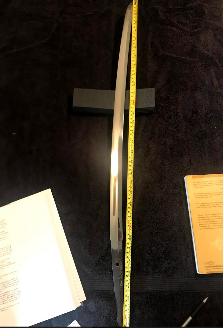

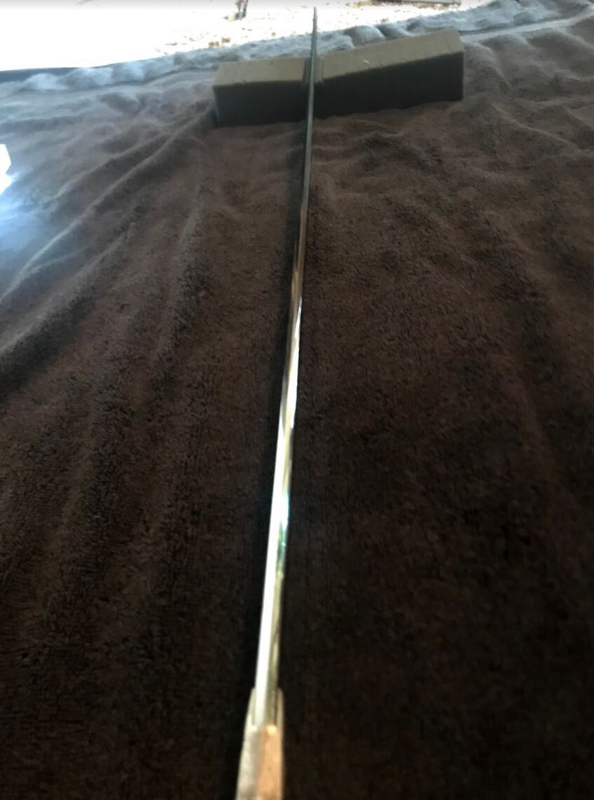

Kaigunto230 Posted August 15, 2021 Author Report Posted August 15, 2021 Couple questions. Do you think I got the sori correct? I went with Koshizori instead of Torriizori, because it looks to me like the deepest curve is in the waist/closer to the nakago, but it took some eyeballing for a time. Next, does anyone have a good reference for Bungo Takeda school? Nagayama's Connoisseur's book has a short description but not too much to go on. I'd like to learn more about my particular smith. Quote
Stephen Posted August 15, 2021 Report Posted August 15, 2021 I do sori from a direct line from the kissaki to mune notch. Measure deepest of the curve. Sorry for not reading your worksheet my eyes have been giving me problems on a good day I'll recheck it. Quote
Stephen Posted August 15, 2021 Report Posted August 15, 2021 http://www.japaneseswordindex.com/measure.htm 1 Quote
Geraint Posted August 15, 2021 Report Posted August 15, 2021 Dear Michael. Congratulations on your first sword. First of all a reality check. Do you seriously think that having purchased a library, travelled to a sword show, bought your first blade and allowed yourself to be photographed studying it intently you are not obsessed? It's too late, my friend! You may have to hold back a little with baby on the way but it's never gonnna go away now! The type of sori is hard to see in most blades in hand, the diagram Stephen linked to will help and so will looking at lots of swords where there is an accurate description. As this is a Shinto Takada sword torii sori would be expected. Minor point but it matters, this is a TAKADA sword not Takeda, they are often dismissed as functional not artistic but that is a whole can of worms I'm not getting into. It does, however, make information a little harder to find. I hate to add to your library list but if you do not have them might I recommend the volumes Art and the Sword, published by JSS/US? I'm sure Grey could sort you out with these. In particular Vol. 4 has a lengthy essay on Kyushu Shinto. Excellent information and wonderful oshigata, (and just to confound my earlier statement I note that there is a sword by Yukinaga which is described as having shallow koshi sori). Enjoy! All the best. 6 Quote

Kaigunto230 Posted August 15, 2021 Author Report Posted August 15, 2021 @Stephen, thanks for the measurement website! I think Yumoto's book had the same/similar diagram, so that's what I tried to do. The picture above with the ruler going from the kissaki to the munemachi is my attempt. Felt a little ridiculous going up and down it for twenty minutes looking for the point with the greatest distance, but I do think it's in the waist. Here's some quick photoshopping; I think the point where the curvature starts getting smaller is the orange line. Sorry about the measurements on the kantei sheet. Relooking, those are a little difficult to read huh? Is this better? I'd re-edit my post but time ran out. Speaking of obsession, is it bad that I've already thought "Gold status is $30/six months? That's a great deal since I've been spending so much time on here!" Who knows Brief Overall Descrition: Fujiwara Yukinaga Shinto Katana with NBTHK Tokubetsu Kicho Origami Shirasaya length: 93.5 cm Overall length: 82.5 cm Nagasa lengh: 64 cm Kasane length: 0.7 cm Mekugiana: 1 Mihaba: 3 cm Motohaba: 3 cm Sakihaba: 2 cm Motokasane: 0.7 cm Weight: unknown (didn't have a proper scale) Sugata shape: Shinogi-zukuri Hada: mokume Sori: 1.8 cm; Type: Koshizori (but discussion on whether it's torrizori) Kissaki: chu-kissaki Mune: Iori Hamon: chu suguha Yakiba: Nioi deki (this one was difficult too; I couldn't see any nie, but it's not in brilliant polish, so that may have complicated matters. Can you see anything different on the hada/hamon picture?) Boshi: Ichi-mai (Again, the polish made this difficult, but it seems like the entire boshi was bright like the hamon. See the picture of the boshi/kissaki above. Do you think I'm right?) Nakago: Ubu; Futsu-gata Yasurime: Kattesagari Bohi: N/A (Is there a term for a sword that doesn't have bo-hi? Online some jokester said "No-Hi" and I'm inclined to go with that unless someone points me to something better ) Koshirae: shirasaya Polish: Modern (I think; another stare at it for a time and make a call) Period: Shinto School: Takada Origami: NBTHK Tokubetsu Kicho from 3 June 1974 Other Information: Bought from Mr. Tony Smith in conjunction with another sword as a bundle deal at the 2021 Token Kai. Quote

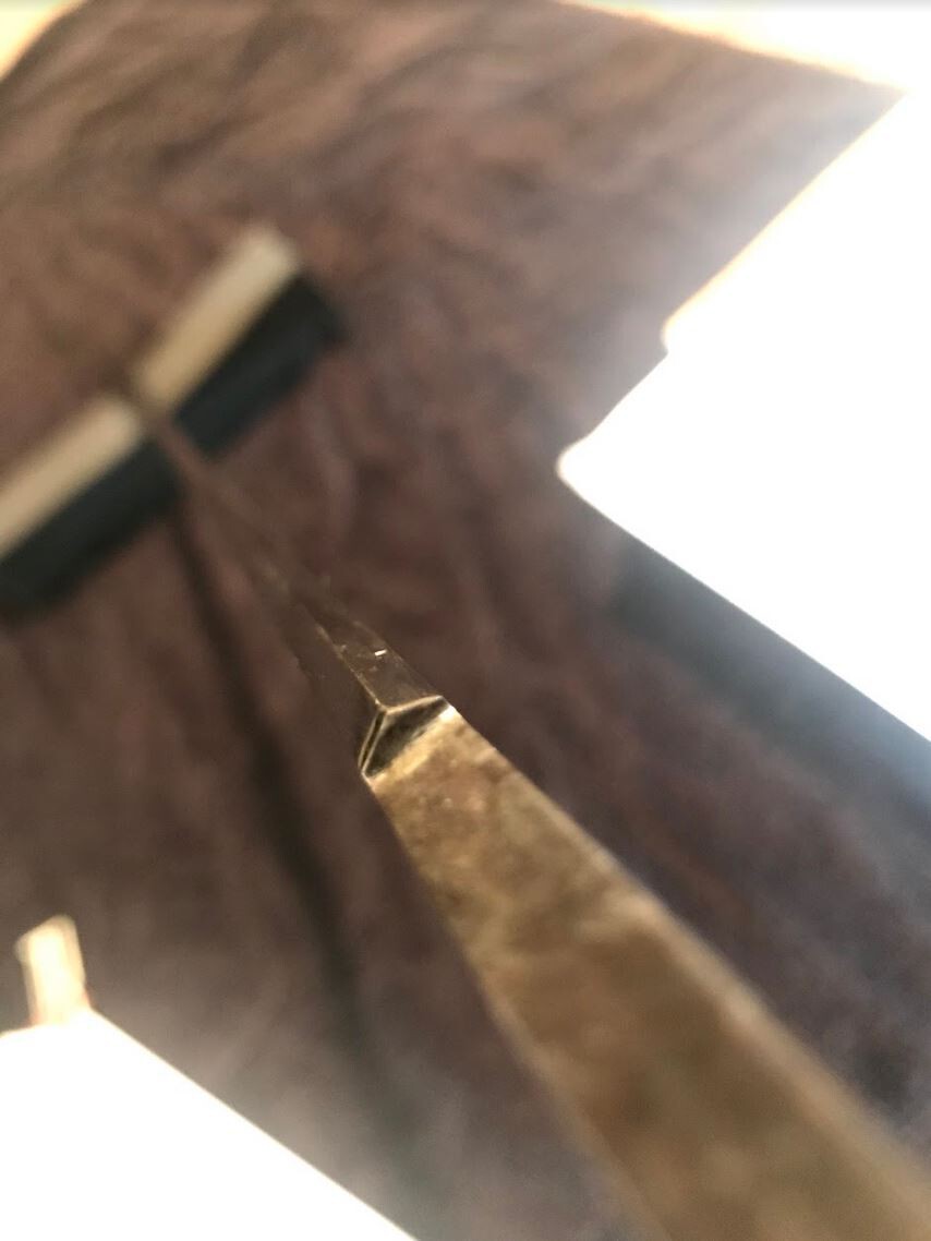

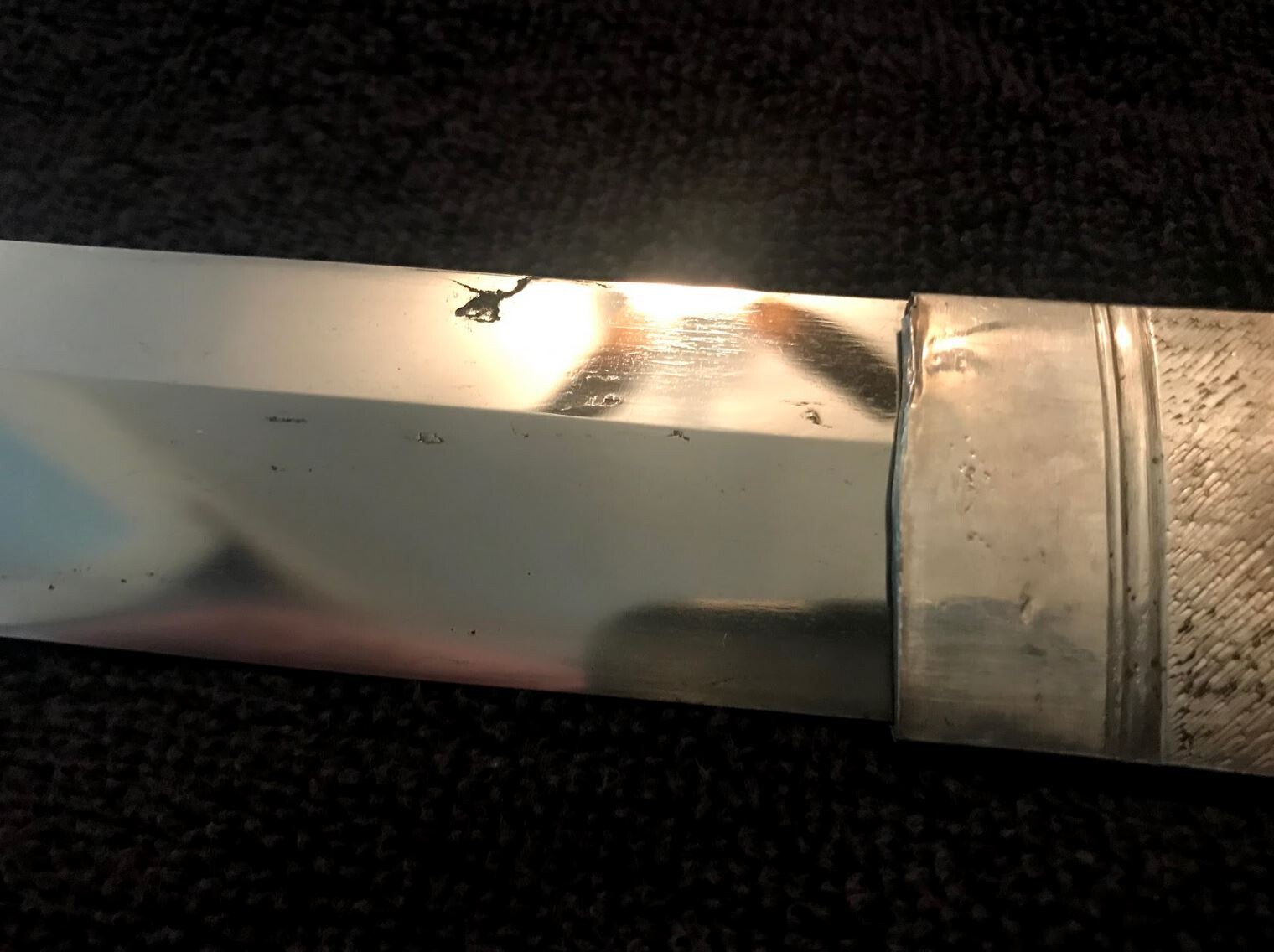

Kaigunto230 Posted August 15, 2021 Author Report Posted August 15, 2021 Thank you all for your engagement. Honestly, this community adds so much to the study. Another question. Do you see the odd darker colors on the bottom circumference of the mekugiana? It also appears distinctly on the origami oshigata. It's like someone added back material when they made the hole too wide. That's my assumption, but am I right? Quote
Stephen Posted August 15, 2021 Report Posted August 15, 2021 Yes a shim of copper added to tighten the ana. Guys in tsuba we call it sekigana...do we call it the same on nakago. Don't think ive ever addressed it having it own name. Quote
