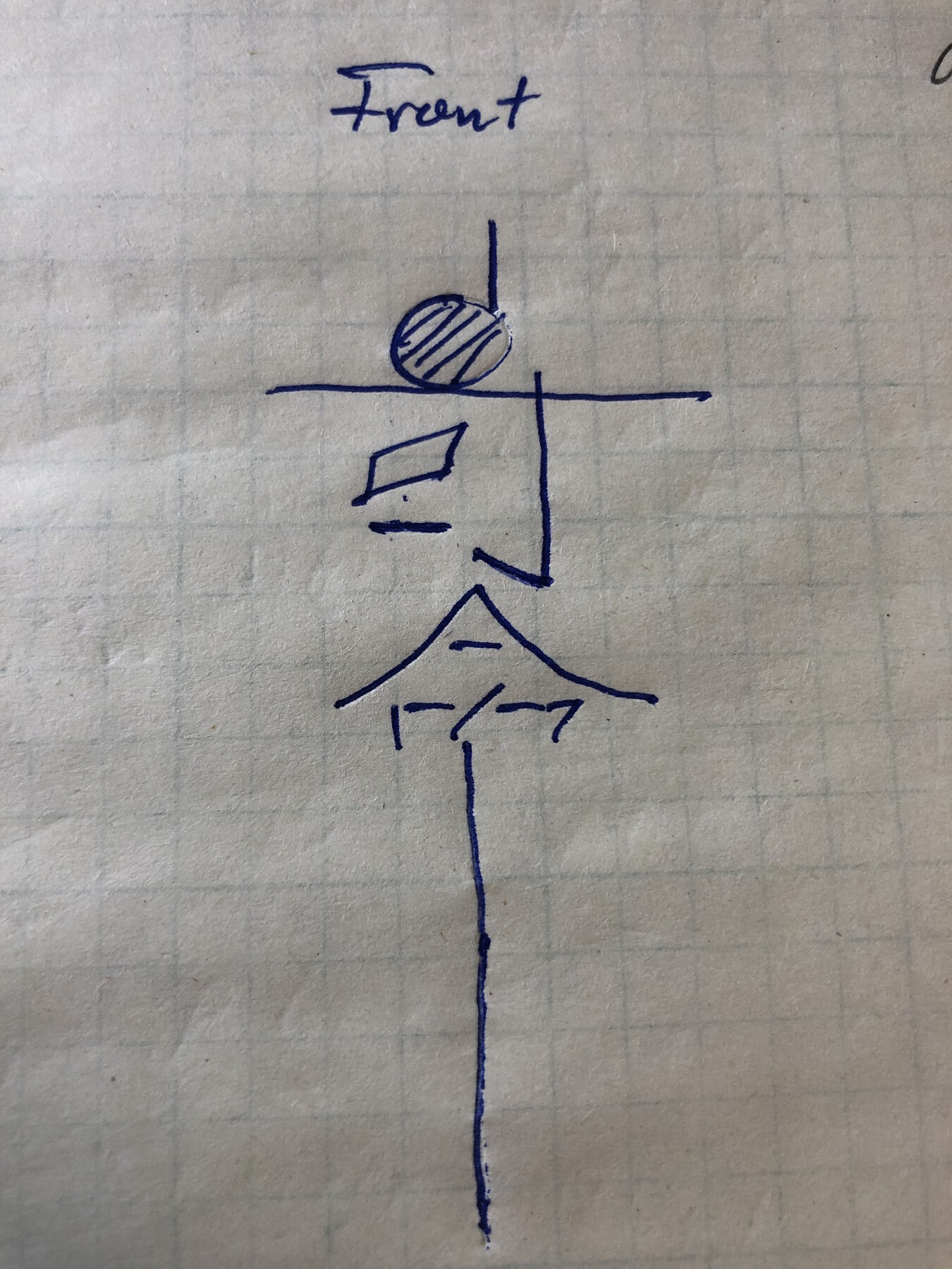

Hello all. Brand new here so if asking these questions break any community rules, I apologize.
Recently my father came across a couple swords in antique store. To his untrained eye, they looked legit. I believe they are as well. We are looking for some more input and opinions. Here are the blades with multiple angles.
First is the wakizashi and a kogatana (which was pointed out to me that it could be gimei and I'm not too worried about it). I can't upload all of the pictures but I will include links to imgur with albums of both pieces. If interested, the mei is in the album and we believe it says Jumyō.
Here is the katana, which we (with some reddit help) deciphered came from Taikei Naotane in 1857.

These were sold as a set, and the tsuka on each looks similar which I would assume means that they have been a set for some time. If this makes sense, let me know.
Thanks in advance for looking, and any input is welcomed as far as what should be our next steps moving forward if these pieces might be worth getting refurbished professionally and possibly papered.

I feel pretty confident on the katana when compared to his other signatures and with the hamon as you said. We believe the wakizashi says Jumyō, someone told me there’s been many smiths with that name over a large timeframe and it’s drilled over the signature
What you have drawn and the pictures, do appear to be Jumyo. 壽命.
The katana shows the date. 安政四年五日 (Ansei 4=1857) Sorry I cannot find the 4 line kanji for the #4.
大慶庄司直胤 (花押) = TaiKei ShoJi NaoTane (Kao)

So I've found many multiple Jumyo smiths, and looking up the kanji it is defined as "life span." The below site says that these were generally given as gifts to Daimyo.
https://new.uniquejapan.com/a-signed-jumyo-long-life-wakizashi/
I'm at a loss for what to look for next with the wakizashi. How would one go about narrowing down the possible origin without the vast knowledge and resources that Shinsa can provide? There is only signature on one side of the tang,  and no date. Which I would assume means that the blade is older or made by a lesser smith.

I have also seen this Kanji at the top of his signature on legit blades
17 minutes ago, Steven Edmund said:
the drawing you made that the other person commented on.
Well. I haven’t noticed Jumyō on any of his other blades but I also haven’t thought to look. From the beginning of looking at these I figured the wakizashi was much older and hadn’t thought it might be Taikei Naotane as well

I think the Jumyō might be from late Muromachi into early Edo period. Jumyō smiths were known to do that very long elongated stroke at the bottom character. However on yours it is even longer than on my reference examples. Perhaps that could be a thing to look for if some did longer one than others? I am just looking at the sword in overall and basing my estimation about the age on that.
We are definitely aware of his importance and that people would want to pass a blade as his. Is the only way to be certain to go through NBTHK or find our own expert first?
also I read that he died the 27th of may, and we read it as “one day in February” for the date so it would have been right before he died.
Another thing we noticed was that the tang has been squared off, which we assumed would have been done as the laws about length of katana changed. Is that a dead giveaway for anything in particular?
I have been looking out for an elongated Jumyō but haven’t seen one. Are there specific reference books you would suggest investing in?

Lets see if I can do "tagging", for Taikei Naotane I know forum member Peter @BIG knows a lot. And for Jumyō I know member Malcolm @mecox is a good source. He is the author of English language book Mino-to: http://www.users.on.net/~coxm/?page=our_books you can also browse his website for some references. Unfortunately I don't have a copy of his book anymore as I intended to get one of the big Japanese tomes for Mino swords, haven't yet gotten one.
I think this is the most elongated signature I was able to find with quick search: https://www.giheiya.com/shouhin_list/japanese_sword/katana/02-1110.html NBTHK specifies Shintō in brackets so they see this as Edo period work.

The date on the tang is 安政二二年正月日 - Ansei 4th year (1857), January.
