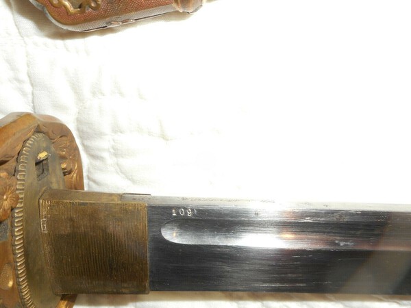

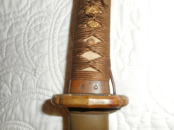

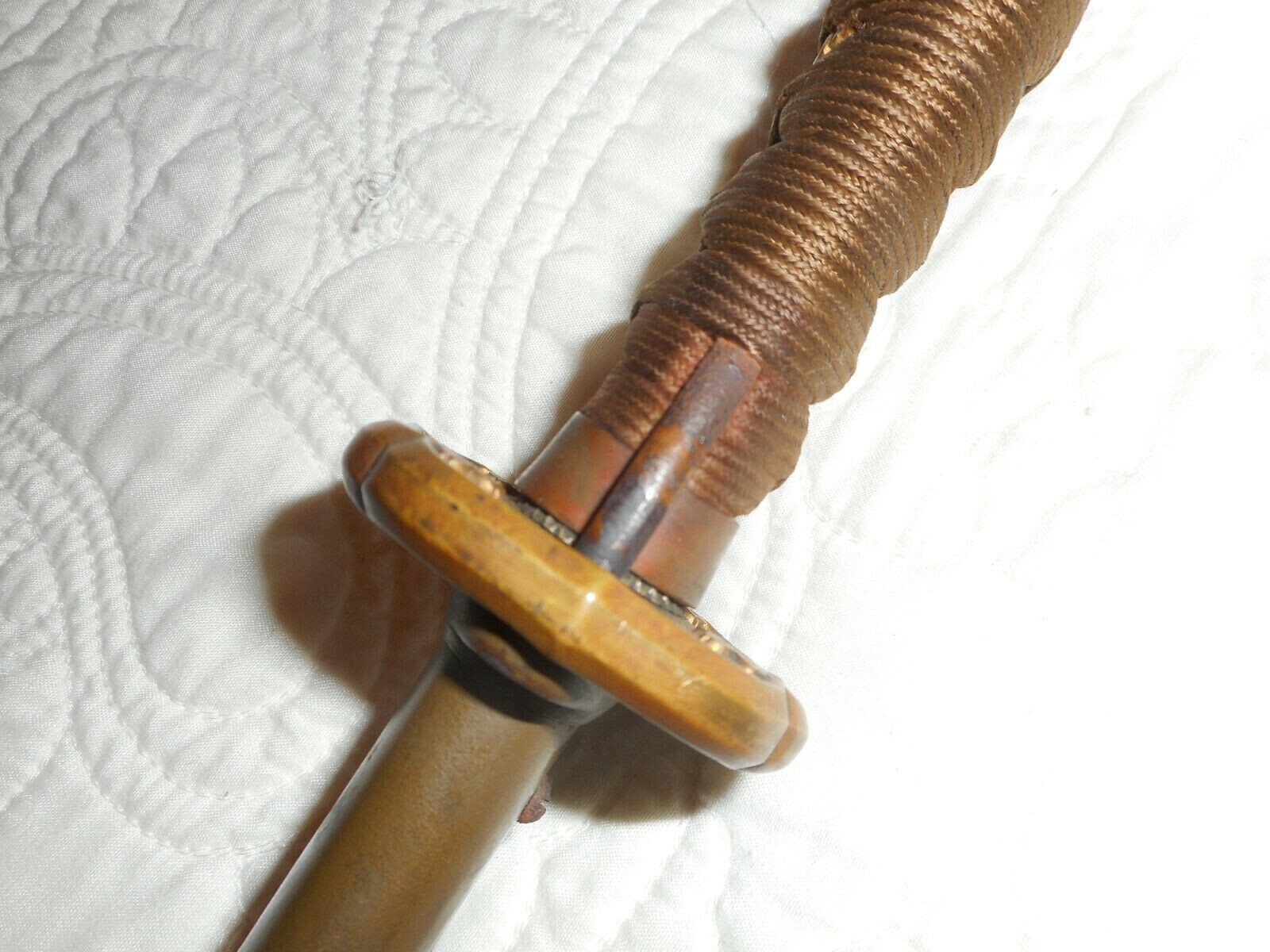

PNSSHOGUN Posted August 4, 2021 Report Posted August 4, 2021 Can anyone explain this one, halfway between an NCO and a Zohei-To......or make believe garbage? https://www.ebay.com/itm/274890568132?hash=item4000c131c4:g:3moAAOSwrYxhCdG7 Quote

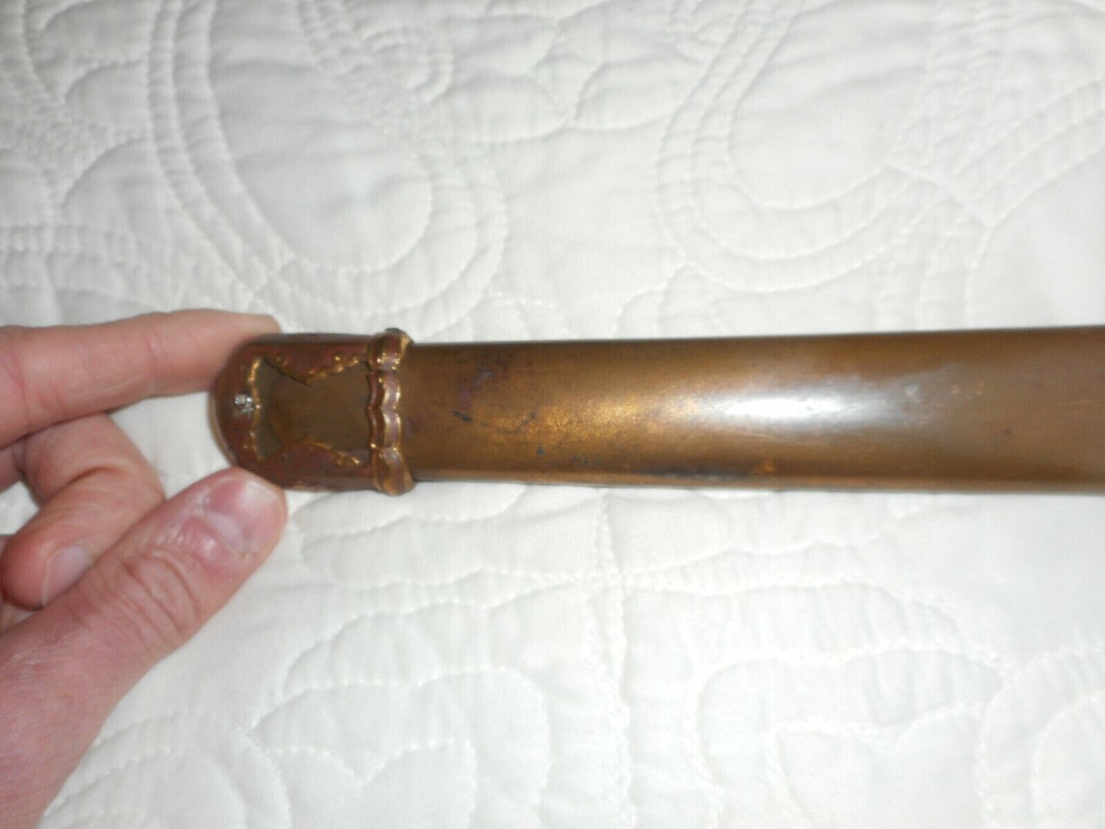

Bruce Pennington Posted August 4, 2021 Report Posted August 4, 2021 Adding a couple more of the photos: Calling @Stegel and @Shamsy!!! My gut says fantasy piece. The 95 parts seem legit, but that serial number - 109 - ????? That would mean this should be a copper handled 95. The saya throat number is too blurry, but seems to match. To my eyes, the ito, same' and menugi look new, yet in the poor and dark photo of the full tsuka, it looks damaged (of course that could be faked too). Will try to lighten/enhance that one and will edit if it helps. There were plenty 95s rented and bought by officers during the war. So this one COULD be one of those. The owner could have had the tuska and other fittings modified befitting his officer status. Just depends on what Ernie and Steve think of the serial number. Type-set looks poor for a legit 95 number to me. Quote
Bruce Pennington Posted August 4, 2021 Report Posted August 4, 2021 Brian, Any chance of spinning this off from post #96 as a new thread? The saya has that goldish undercoat like the copper-handled 95s used, so that would seem to support the idea that the saya was original. The screw on the sayajiri appear to have a silver-color like steel or aluminum. I'm no expert on WWII screws, but I've only seen copper screws on these, which would indicate a post-war add-on. Still leaning toward post-war fantasy piece with real parts. Quote

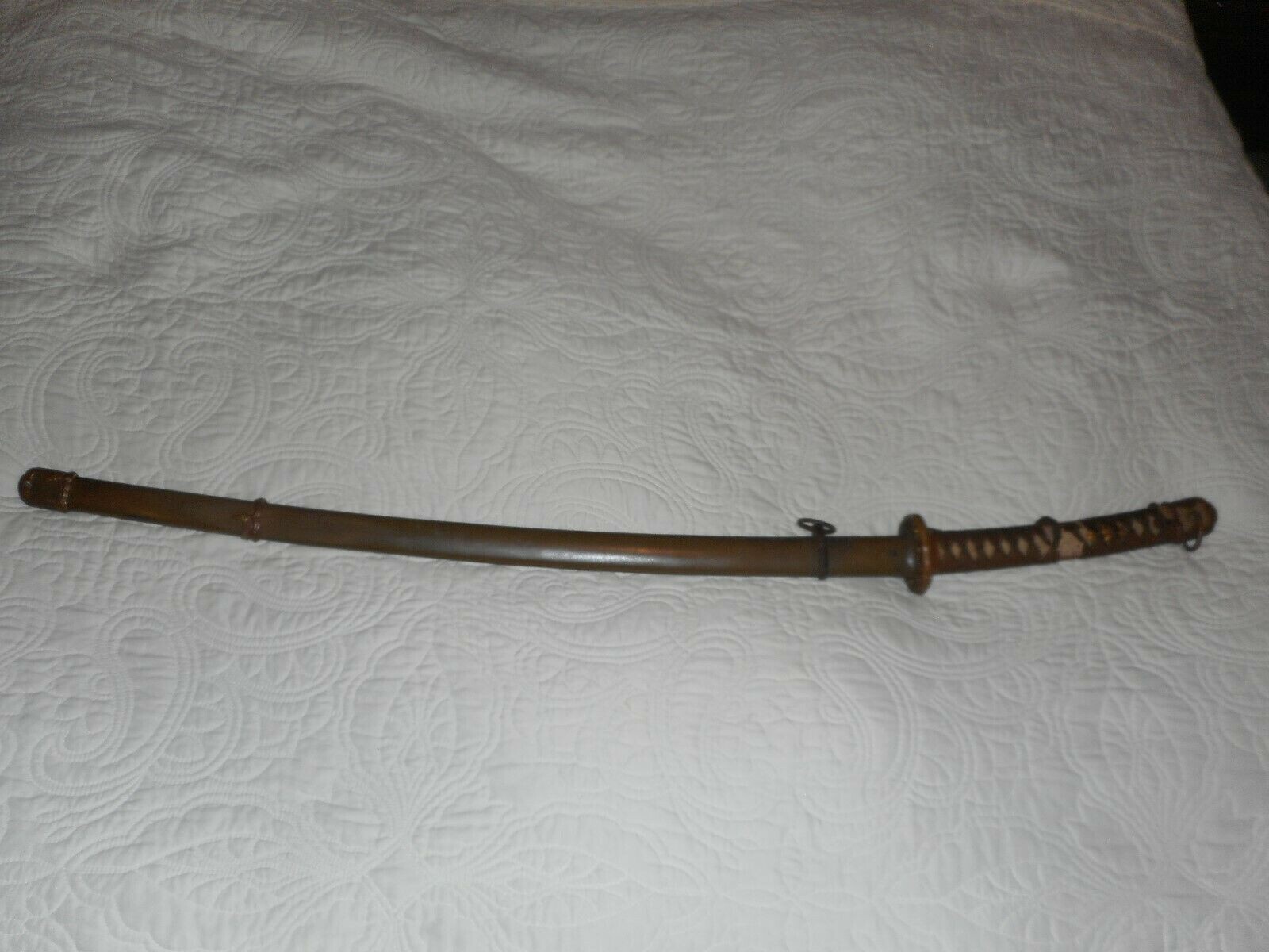

BANGBANGSAN Posted August 4, 2021 Report Posted August 4, 2021 I think the scabbard is original to this sword by adding a Type 98 Ishizuke 石突。 1 Quote

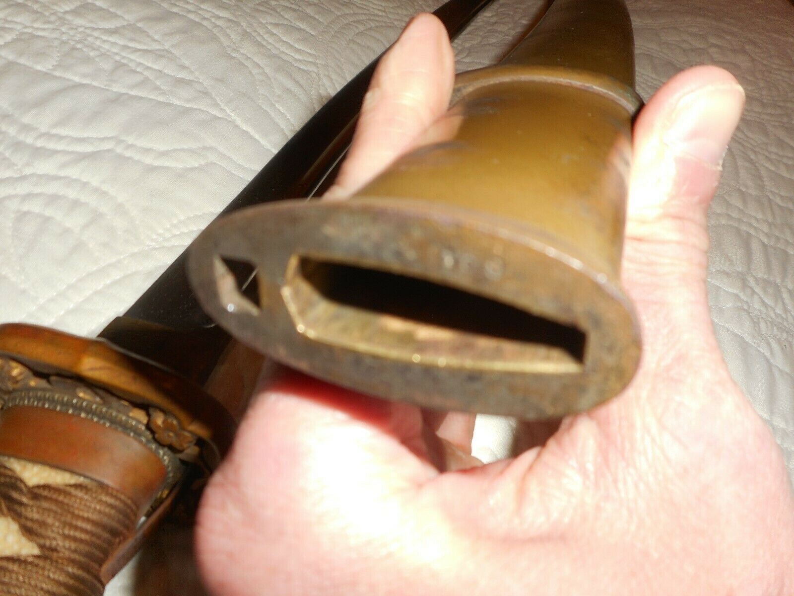

Shamsy Posted August 4, 2021 Report Posted August 4, 2021 Honestly, I really don't know with this one. I don't have 109 listed in my Pattern 1 database, though I have about 20 swords to add when I have time and energy to update. Stegel may have different records to me. The stamps look correct, as does the saya. If there was ever a 'real' example of a private purchase sword that was modified to look like an officer sword, I would say this is a good candidate. Could it also be a project by someone with parts or a fabrication of a 'rare' sword? absolutely. That's about all I have to say. If someone wants to buy this, then please share it with the forum when you get a hands-on look. 1 Quote
Shamsy Posted August 4, 2021 Report Posted August 4, 2021 On 8/4/2021 at 7:11 PM, BANGBANGSAN said: I think the scabbard is original to this sword by adding a Type 98 Ishizuke 石突。 Expand Oh, should have commented. It 100% is and it is correct for the serial number range of the Pattern 1. You can clearly see the curved 'shoe' shaped brass plug of the saya in the photo, under the added officers cap. 1 Quote

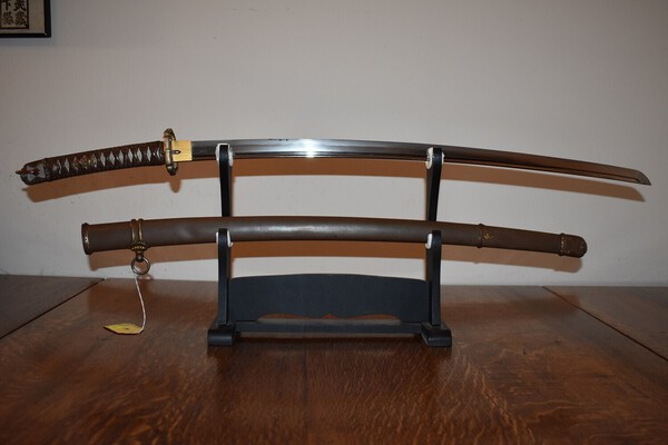

PNSSHOGUN Posted August 6, 2021 Author Report Posted August 6, 2021 Here is a similar blade but in officer mounts: https://www.ebay.com/itm/265195228837?ssPageName=STRK%3AMEBIDX%3AIT&_trksid=p2047675.l2557&nma=true&si=84i%2FvCoo%2FZ2CbPcP8CpK84BF53E%3D&orig_cvip=true&nordt=true&rt=nc 1 Quote
Shamsy Posted August 7, 2021 Report Posted August 7, 2021 Just too add one comment more. I think a Type 95 blade in officer mounts would be infinity more likely to be genuine than an officers blade in 95 mounts. Blades were obviously in shortage, but I've not seen anything to suggest koshirae were ever hard to obtain. I can easily imagine an officer remount a 95 blade they purchased and owned, but absolutely don't believe an NCO would do the same for their issued sword. Always an exception though. 1 Quote

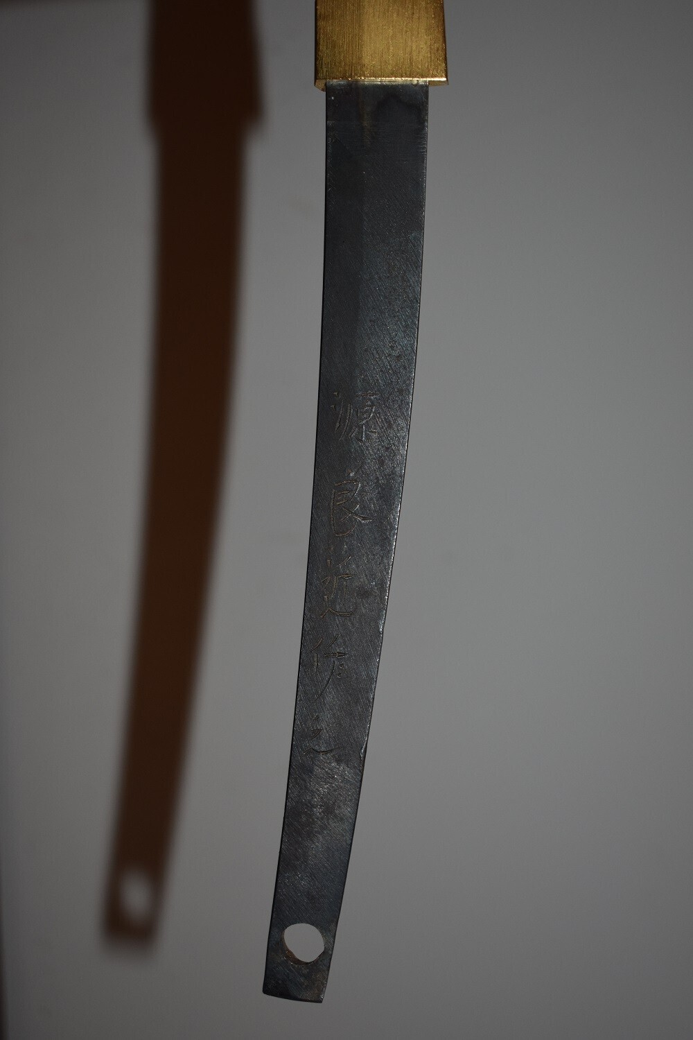

Bruce Pennington Posted April 11, 2023 Report Posted April 11, 2023 I believe there is at least one other thread discussing officer gunto with NCO, Type 95 tsuka, but I can't find it, so I'm posting here. This is from John Plimpton's new book, Swords of the Emperor. He's listed it as an officer sword. You can see the fuchi is well made and fits the tsuka perfectly, so I doubt it's a post-war piece-together. One drawback to the book is that there are no, and I mean NO, blades in it. So we don't know if the blade in this is an NCO blade. It would have been good to know. Also, he mentions this "variant type was often used by paratroopers." There is a bibliography in the back of the book, but he doesn't state, here, his source for such a claim. Boy, the paratroopers and NLF seem to be the go-to guys for every odd-ball sword people find. I suspect this is more along the lines of this thread. I bet there is an NCO blade in this and it's a custom job for an officer during the peak of the sword shortage. 1 Quote
John C Posted April 11, 2023 Report Posted April 11, 2023 On 4/11/2023 at 1:51 PM, Bruce Pennington said: officer gunto with NCO, Type 95 tsuka, Expand Interesting that the write-up includes the tsuba as being made of aluminum. Was that common? John C. Quote
Bruce Pennington Posted April 11, 2023 Report Posted April 11, 2023 Actually, I didn’t know they existed! Quote
BANGBANGSAN Posted April 11, 2023 Report Posted April 11, 2023 On 4/11/2023 at 1:51 PM, Bruce Pennington said: One drawback to the book is that there are no, and I mean NO, blades in it. So we don't know if the blade in this is an NCO blade. It would have been good to know. Expand Bruce You can ask @mdiddy Matt and see if he still got that sword. It has a 源良近 blade. 1 Quote
BANGBANGSAN Posted April 11, 2023 Report Posted April 11, 2023 On 4/11/2023 at 5:00 PM, Bruce Pennington said: Actually, I didn’t know they existed! Expand Bruce, you had seen them before and replied to the thread. 2 Quote

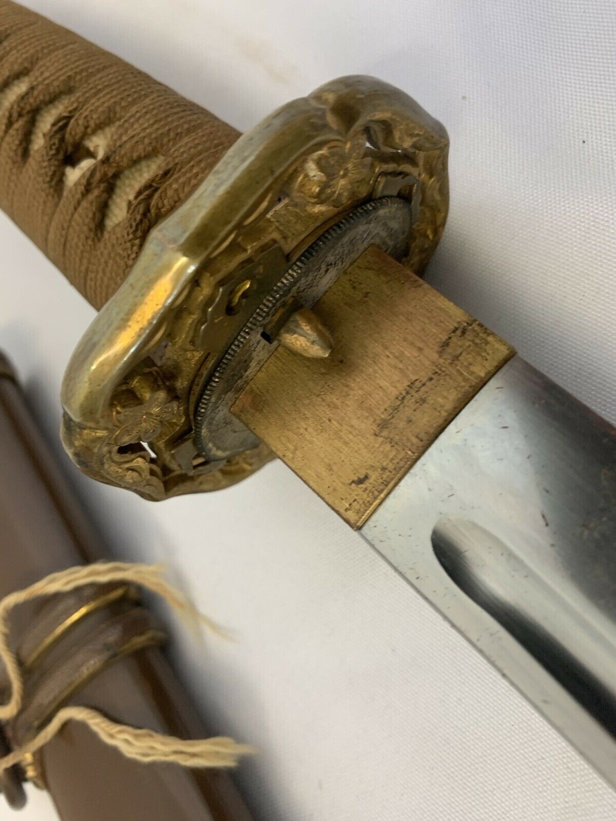

robinalexander Posted April 12, 2023 Report Posted April 12, 2023 Sorry I'm late on this thread. Just an observation in regard to the habaki on the originally posted sword (PNSSHOGUN).......correct me if I am wrong (as if I should ask ) but the markings on the habaki go crossways rather than being smooth or possibly length ways. I haven't noticed that before on 95's and if that is not a std 95 habaki then it may add weight to the theory that it was an officers purchase and the habaki was professionally refitted to the blade. Not being a friction fit in this case, the actual exterior dimensions of the habaki would be less important. Rob 1 Quote
