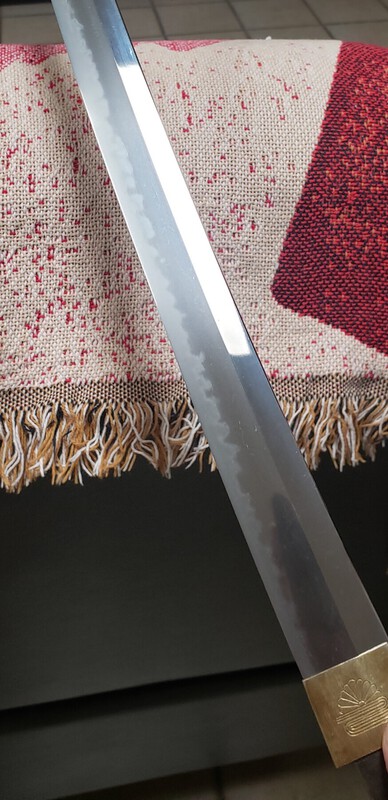

Kolekt-To Posted August 2, 2021 Author Report Posted August 2, 2021 One more photo of the Captain's sword ("Masataka" - Minotagawa shrine smith - blade in Type 97 mounts). Such a beautiful blade! 2 Quote
PNSSHOGUN Posted August 2, 2021 Report Posted August 2, 2021 The Mei doesn't look quite right on this one, is it papered? 1 1 Quote
IJASWORDS Posted August 2, 2021 Report Posted August 2, 2021 WOW! Nice sword! Looks like it was made yesterday, it is so good! What provenance did you see relating to the Captain's ownership? Did you photograph that? 1 Quote
Kolekt-To Posted August 2, 2021 Author Report Posted August 2, 2021 Hey guys, remember I'm a newbie here. Lol. I'm going off what my mentor told me - I trust the guy and know that he has a solid reputation in the collector community. I'm not sure if this sword is papered or not. He told me that he has swords that are papered (probably some of the ones that I saw and handled last weekend were papered) and that he has several swords in Japan that are waiting to be papered. He told me that one has already been papered and is "Juyo" status, and that it will be more months ahead before he receives those swords back from Japan. As the relationship develops, I expect to learn a lot more and that more will be revealed. And, though I was witness to some great swords, I saw only part of his collection. Currently, I'm not even aware of all the questions I should, or could, be asking. I'm at that stage where I'm just happy that someone with a lot of knowledge and experience is sharing their wisdom with me in person, and that he's helping steer me in the right direction so I can reduce my risk of making costly mistakes. I'm confident that I will be made aware of more details about his collection we proceed. I did ask him how he acquired that particular Minotagawa sword (remember that he has several in his collection that I'm aware of) and he told me that he got it through a contact (in Japan, if I remember correctly), but did not reveal the name of the source - and I wasn't going to pressure him for the name of the source (we just met, and I need to be respectful and develop a trusting relationship with the man). No doubt I'll be posting more great photos of swords from his collection in the future, and I will try to ask the right questions and get more information about the swords. I hope to post photos of swords that I can be proud of from my collection, too. Currently, I've got mostly low-grade showato, but I'm shifting gears and seeing the value in aiming higher. 1 Quote

Volker62 Posted August 2, 2021 Report Posted August 2, 2021 Hi Geoff In my insignificant opinion, the signature and also that kikusui over the signature of the Masataka looks good. A long time fellow from collector from New York, who sadly passed away has written a fine booklet, named "Gendaito made at the Minatogawa shrine" Maybe you compare the signature... 1 1 Quote
Bruce Pennington Posted August 2, 2021 Report Posted August 2, 2021 Geoff, For my files, could I get clear close-ups of the kikusui on both the blade and the habaki? Thanks! Quote
mecox Posted August 2, 2021 Report Posted August 2, 2021 Geoff, in the article on Japanese Naval Swords (part 1) in the NMB Downloads there is a summary on the Minatogawa Shrine forge and also of Masataka. Will give you some background. 1 Quote

Sam Smith Posted February 9 Report Posted February 9 Hello everyone, today I came across this post by chance. If it violates any rules, please let me know or remove it. The following are my views. This sword is a fake that appeared on Yahoo Japan a few years ago. First, based on the inscription, the original owner only became the captain of the battleship Yamato in 1944. It is impossible for him to have foreseen this in 1942. Second, I checked some archived websites and found other fake Kikusui swords on Yahoo Japan between 2017 and 2019. They all have a similar style and format. Finally, I am not an expert on Kikusui swords, and there may be some mistakes in my research. Here, I will post the pictures I found and a link to a Japanese blog that questions the authenticity of these swords (the blog does mention a possible original selling link for this sword, but I cannot access it). I welcome any experts to join the discussion. I apologize for any disturbance. SAM https://ameblo.jp/ku...try-12729097877.html 平成最後の特別出品!!約半世紀ぶりに戻ってきた幻の名刀!!菊水刀!戦艦大和最後の艦長『有賀幸作』佩刀!!『(菊水紋)湊川神社正孝』 の落札情報詳細 3 1 2 Quote
Bruce Pennington Posted February 9 Report Posted February 9 8 hours ago, Sam Smith said: the original owner only became the captain of the battleship Yamato in 1944. That fact alone, would put all these in question. Originally, John, PNSSHOGUN, was concerned about the authenticity of the mei. We have seen a number of blades coming out of Japan that were likely originally mumei and had fake mei added. These could fall into that category. Is it possible they were all minitogawa blades that had the fake Captain inscription added recently? 2 Quote
Sam Smith Posted February 9 Report Posted February 9 1 hour ago, Bruce Pennington said: That fact alone, would put all these in question. Originally, John, PNSSHOGUN, was concerned about the authenticity of the mei. We have seen a number of blades coming out of Japan that were likely originally mumei and had fake mei added. These could fall into that category. Is it possible they were all minitogawa blades that had the fake Captain inscription added recently? In my opinion, the likelihood is not very high. Judging from the inscriptions themselves, they appear to be the work of the same person. Given the prevalence of forgeries during that period, this one is probably also among them. 2 Quote

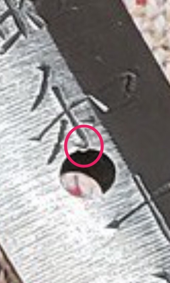

KungFooey Posted February 10 Report Posted February 10 1 hour ago, Sam Smith said: Hahaha, I noticed that too. Actually, I personally feel that for GUNTO on Yahoo, we should be cautious about the Fukuoka & Osaka landing certificates during the Reiwa era and the Osaka landing certificates during the Heisei era. It seems that these two places have relatively lax management, and counterfeit products from overseas can always obtain certificates in these two locations Wow! Well spotted Sam! I'll be looking much more carefully at blades registered in those two prefectures from now on. Plus, I was just looking more closely at the sword which is the subject of the OP and the totally clean nakago appeared unnatural to me - so I enlarged one of the photos. It's the first time I have ever seen a signature chiseled after the nakago-ana has been drilled (obvious from the burr on the side of the hole). 🤔 7 2 Quote
Sam Smith Posted February 11 Report Posted February 11 On 2/10/2025 at 3:09 PM, KungFooey said: 哇!发现很好的山姆!从现在开始,我将更仔细地研究在这两个县注册的刀片。 另外,我只是更仔细地观察了 OP 的主题剑,完全干净的 nakago 对我来说似乎不自然 - 所以我放大了其中一张照片。 这是我第一次看到在 nakago-ana 钻孔后凿出的签名(从孔侧面的毛刺可以明显看出)。🤔 Great find! It's obvious that they first considered the compatibility of this fake before engraving the inscription, which is the reverse of the normal procedure. 1 Quote
