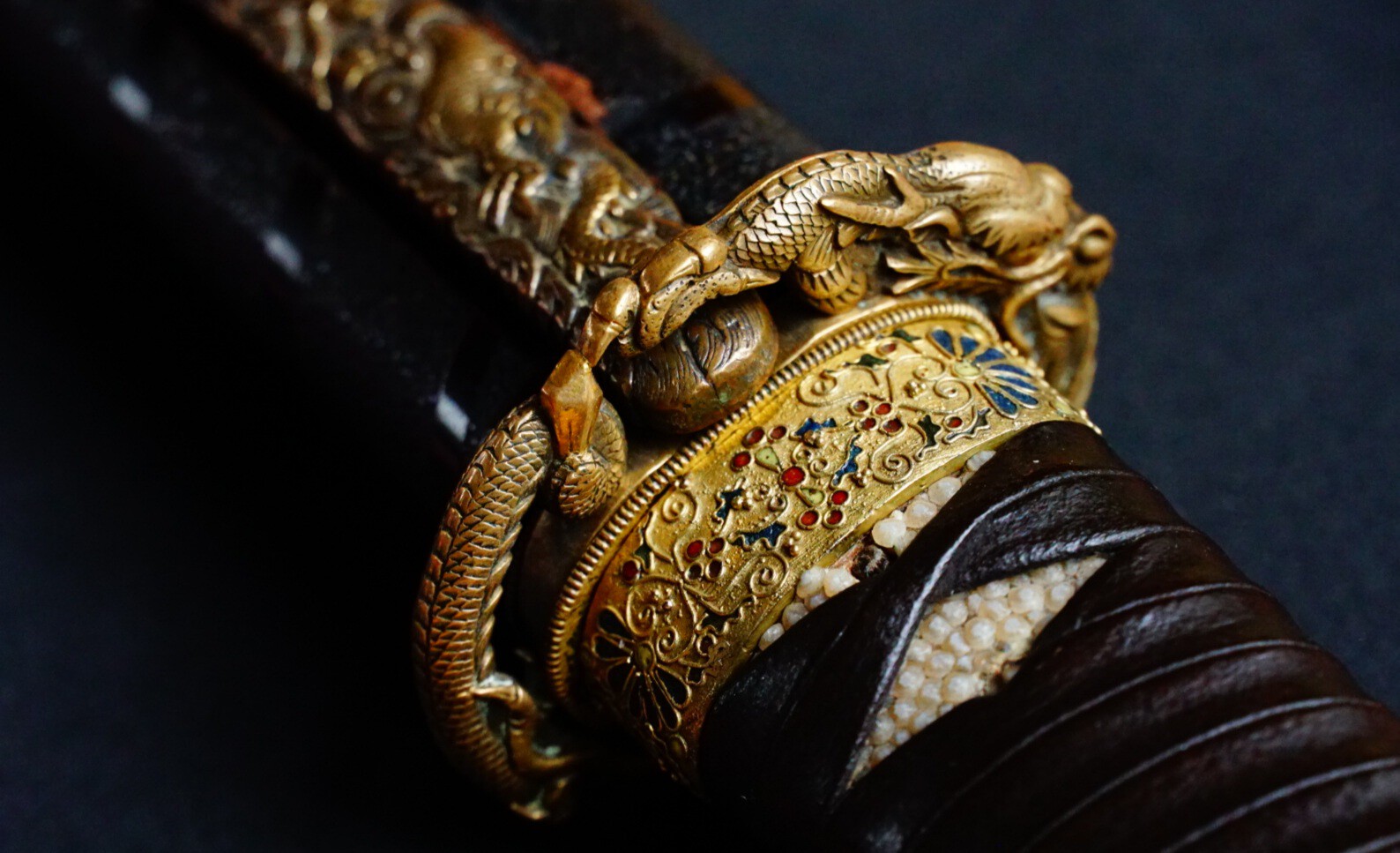

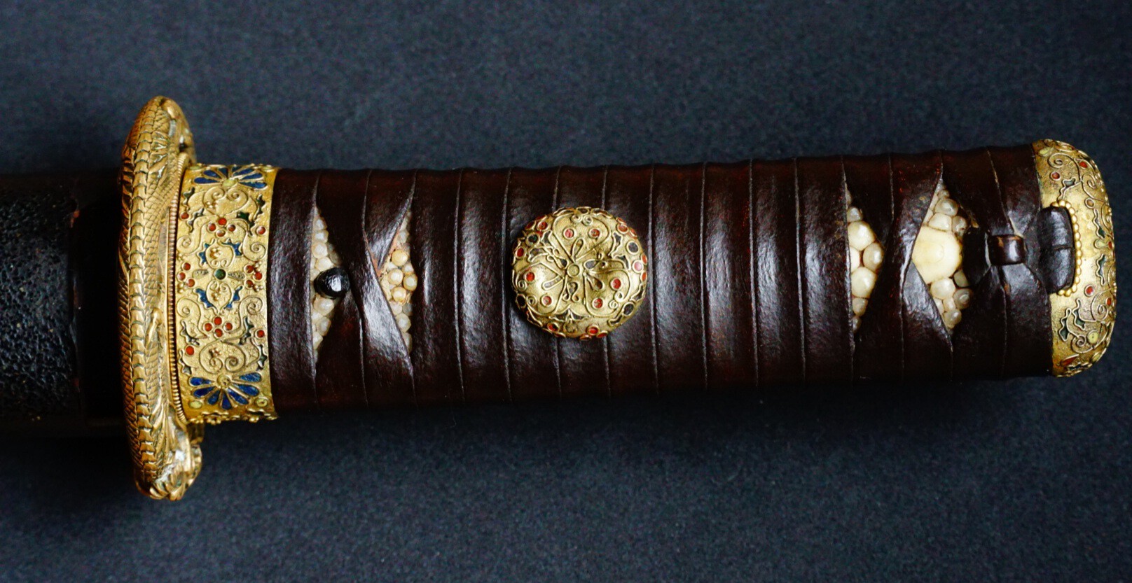

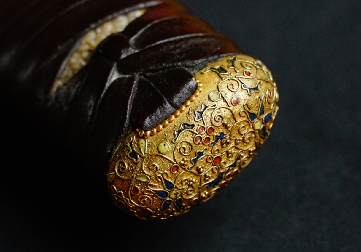

I've only got one shippo piece:
its different on the back - for a psychedelic experience:

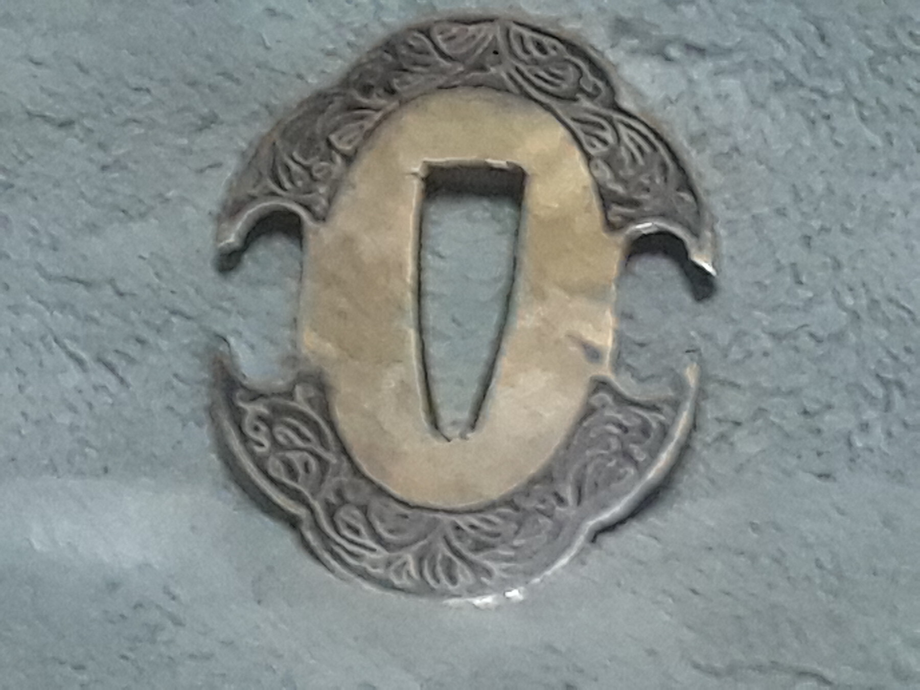

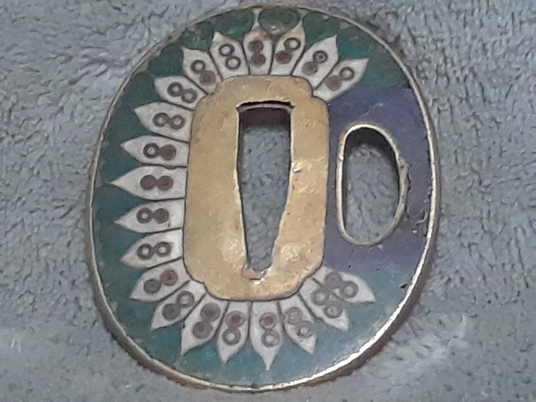

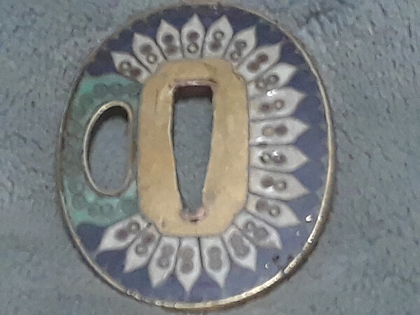

I have a few cloisonne enamel pieces. I also apologize for the crap photography. These are really old shots and I haven't bothered to retake them yet with my (somewhat) improved photography skills.
Mounted on a Morimasa wakizashi:
Second cloisonne piece:

Chris, I was looking at your tsuba and trying to figure out the symbolism when it occurred to me I had seen something similar on an uchiwa. I think the filled and unfilled dots might represent auspicious and unlucky days of the month.
Ian
Ian
Interesting! I had wondered if it had to do with some kind of theme of balance, with the alteration of colors. But that explanation of yours makes a lot more sense!
