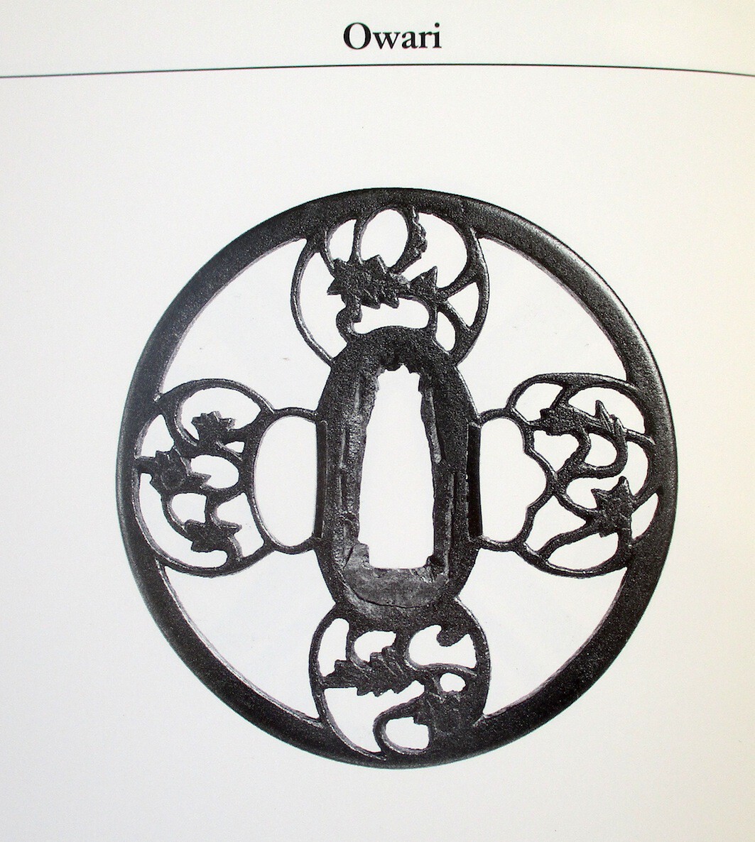

I've never seen chisel marks that far away from the nakago-ana before, is this normal?
Seems too far away to effect proper fitment, just causes damage instead.
Mark
Those kind of tagane could be found sometimes.
I agree they have none or only a small effect in altering the nakago ana.
Because of this IMHO it is most probably some kind of signature or perhaps refernce marks for a later modification of the nakago ana.
Here’s an example out of Kremers’ book “Sukashi Tsuba”. Although the tanghole has been modified already similar tagane could be noticed.
