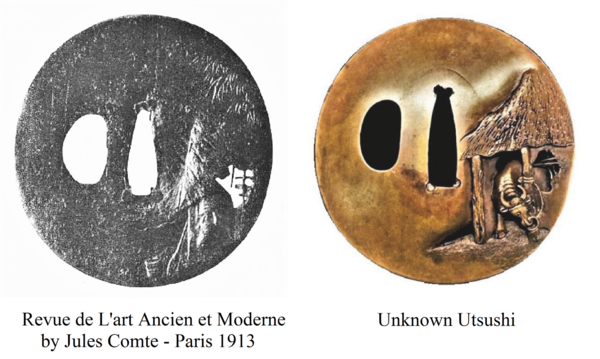

I am sorry I can't give an opinion on whether the tsuba are Ko -Nara but I have dredged up two additional images - one a very close match to yours and an older grainy image close to the other example. Perhaps the images may be of some use.

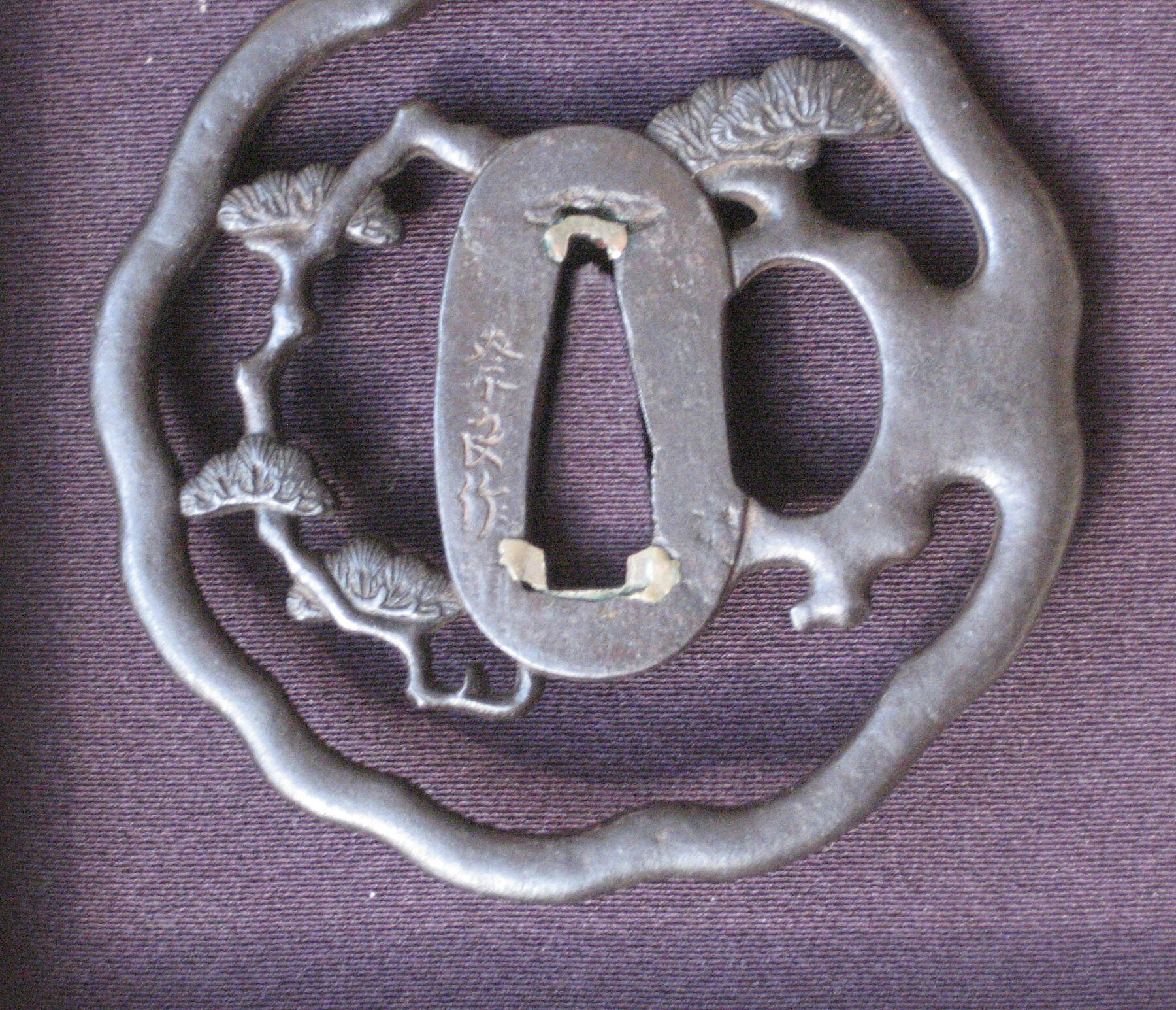

In some books, the writer will depict tsuba more like yours.
Others, more like the one I have attached. Signed "Nara saku" on the back. It is the only one I have handled to date that I would definitely call "Ko-Nara".
While "Ko-" usually signifies circa pre1600, it seems to equate to about pre1700 (edited) for the iron works of Akasaka and Nara.
Curran
