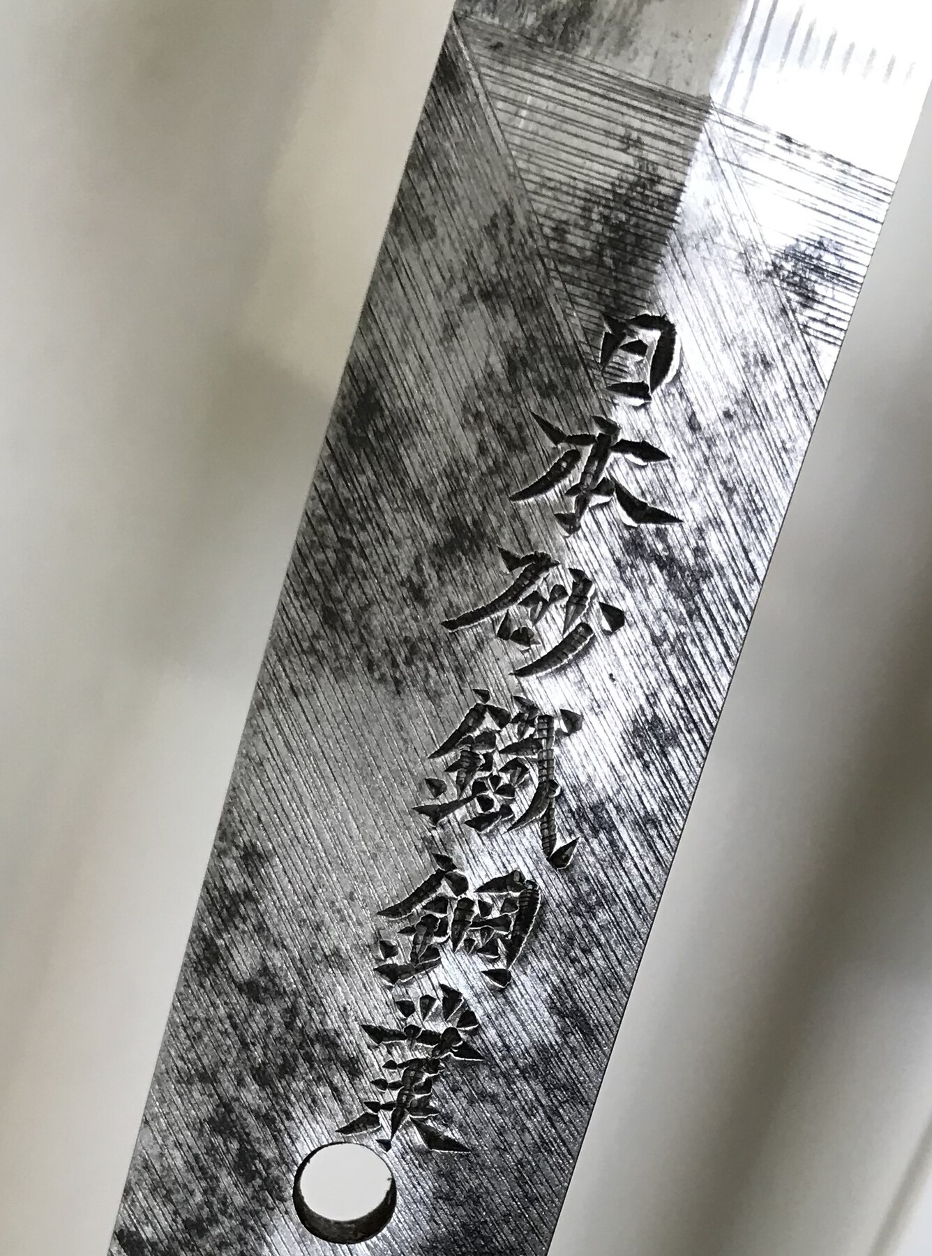

Bryce Posted July 13, 2021 Report Posted July 13, 2021 G'day Guys, Gassan Sadakatsu swords are sometimes found with the inscription : "Nihon Satetsu Kogyo Kabushiki-gaisha Motte Seiren Ko" I think his translates roughly to " Made using steel smelted by the Japan Iron Sand Steel Industry Company". If I have got this wrong, please correct me. The Japan Iron Sand Steel Industry Company made sponge iron from iron sand using rotary kilns, after first treating the sand to recover vanadium. They were established around 1937 and were listed by the US Airforce as a bombing target during the war. Before I started researching this company I had assumed they made tamahagane, but it now seems they made western steel, using iron sand as the base ore. The question is why did Gassan Sadakatsu make these swords? The most likely explanation is that the company commissioned him to make a batch of these swords, so they could be presented to important people to promote the company's product. A less likely scenario is that Gassan Sadakatsu was endorsing their product because of its quality. So far I have identified seven of these swords, five made in 1940 and two made in 1941. Three of these are kogarasu maru and four are shinogi zukuri, with and without bohi. They are also made in ayasugi, masame and soshu style. Below is an example made in 1940 in masame. Cheers, Bryce 8 Quote

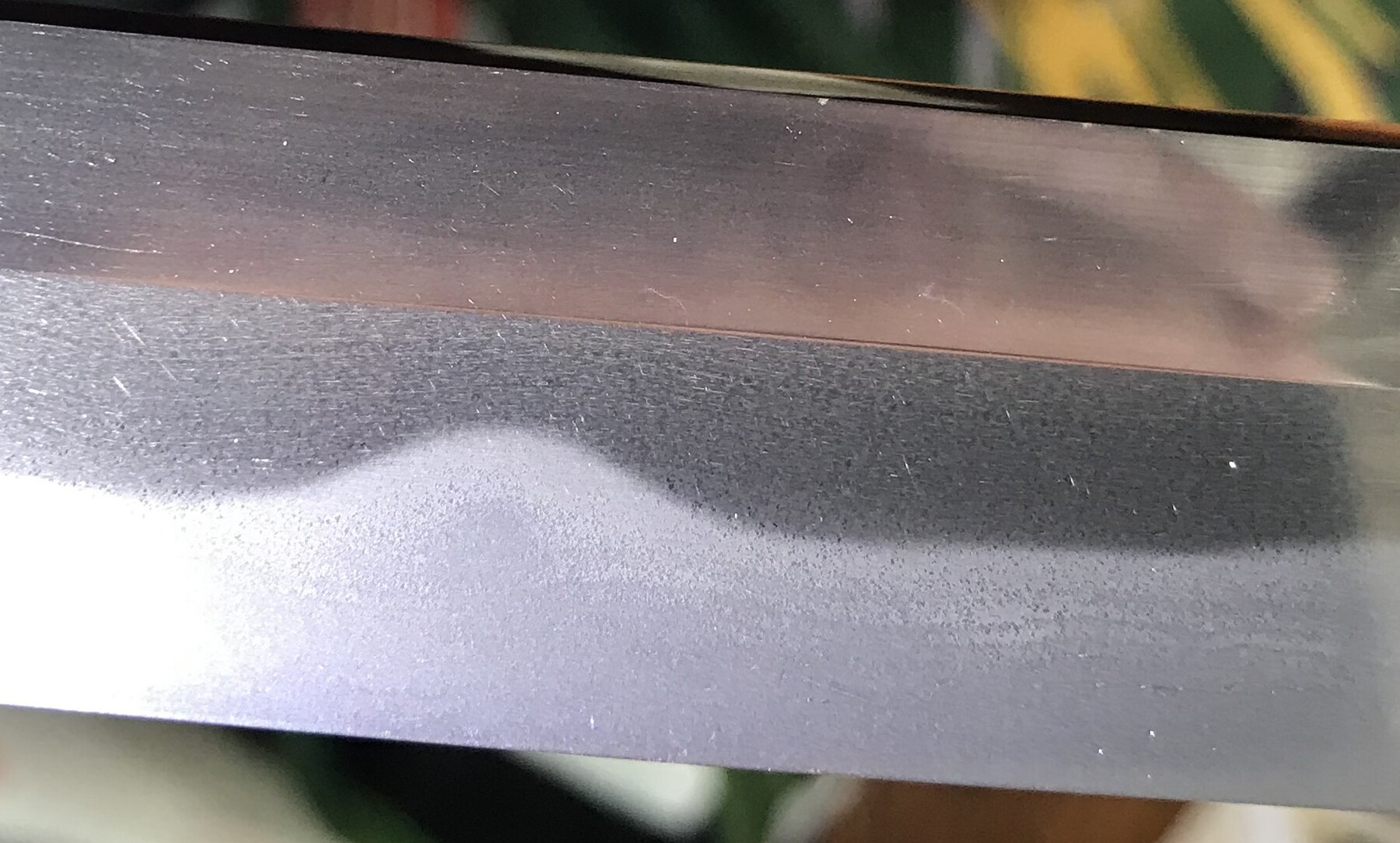

Toryu2020 Posted July 14, 2021 Report Posted July 14, 2021 I think Bruce is correct - gendaito need to be made from Tamahagane What Bob points up is that, other steels, like namban tetsu, meteorite, gun barrels and the like have historically been mixed in, in small amounts and used as a selling point. I think the amount of nie in the example sword makes it clear this is a product of tamahagane, but also clear is that the smith mixed in some "sponge iron" to make something worthy of presentation as noted in the original post. mho -t Quote
Jacques Posted July 14, 2021 Report Posted July 14, 2021 From a purely physical point of view steel is steel and its properties are the same whatever the origin of the ore, iron is iron (Fe). Tamahagane is produced in a low furnace whereas industrial steels are blast furnace cast iron and decarburized to be able to be forged. the atomic bonds make it possible to have nie (martensite) in the 2 types of steel. This is why it is sometimes impossible to determine whether a sword was made with tamahagane or not. 4 Quote

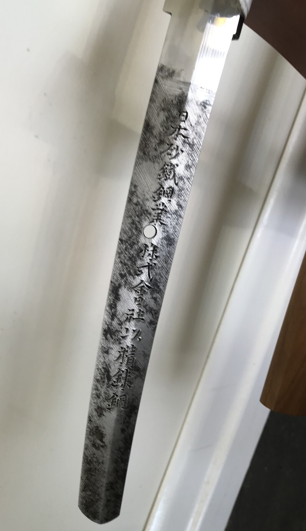

Kiipu Posted July 14, 2021 Report Posted July 14, 2021 On 7/13/2021 at 2:55 PM, Bryce said: "Nihon Satetsu Kogyo Kabushiki-gaisha Motte Seiren Ko" I think this translates roughly to "Made using steel smelted by the Japan Iron Sand Steel Industry Company." I double checked the characters and this is what I am seeing. 日本砂鐵鋼業株式會社 = Nihon Satetsu Kōgyō KK. The last four characters seem to be 以精X鋼; but, the second to last character is unclear at the moment. 1 Quote

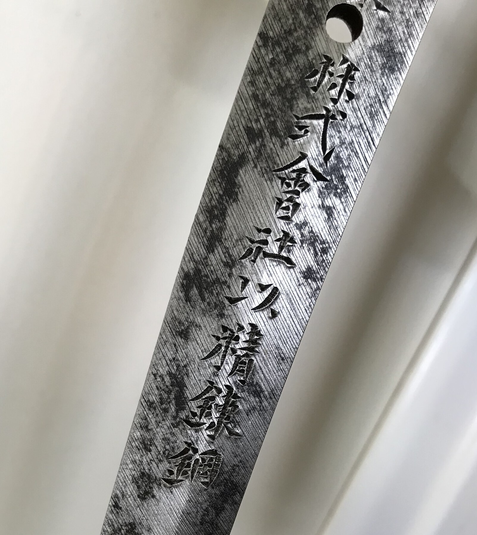

Bryce Posted July 14, 2021 Author Report Posted July 14, 2021 G'day Thomas, Sorry the original photo wasn't very good. These may help. Cheers, Bryce 1 Quote
Kiipu Posted July 14, 2021 Report Posted July 14, 2021 Bryce, thanks for the closeups. There are several old characters in that inscription and you nailed it down pretty good. There are no changes to the company name and the last four characters are 以精錬鋼 (motte seiren-kō). If you would like to do an Internet search, you will need to convert the characters I posted to the new versions. The old characters will not yield many hits. To convert from old to new characters is literally a click away. The link below is the website that I use for this. Old Japanese Kanji to New Japanese Kanji Converter 2 Quote

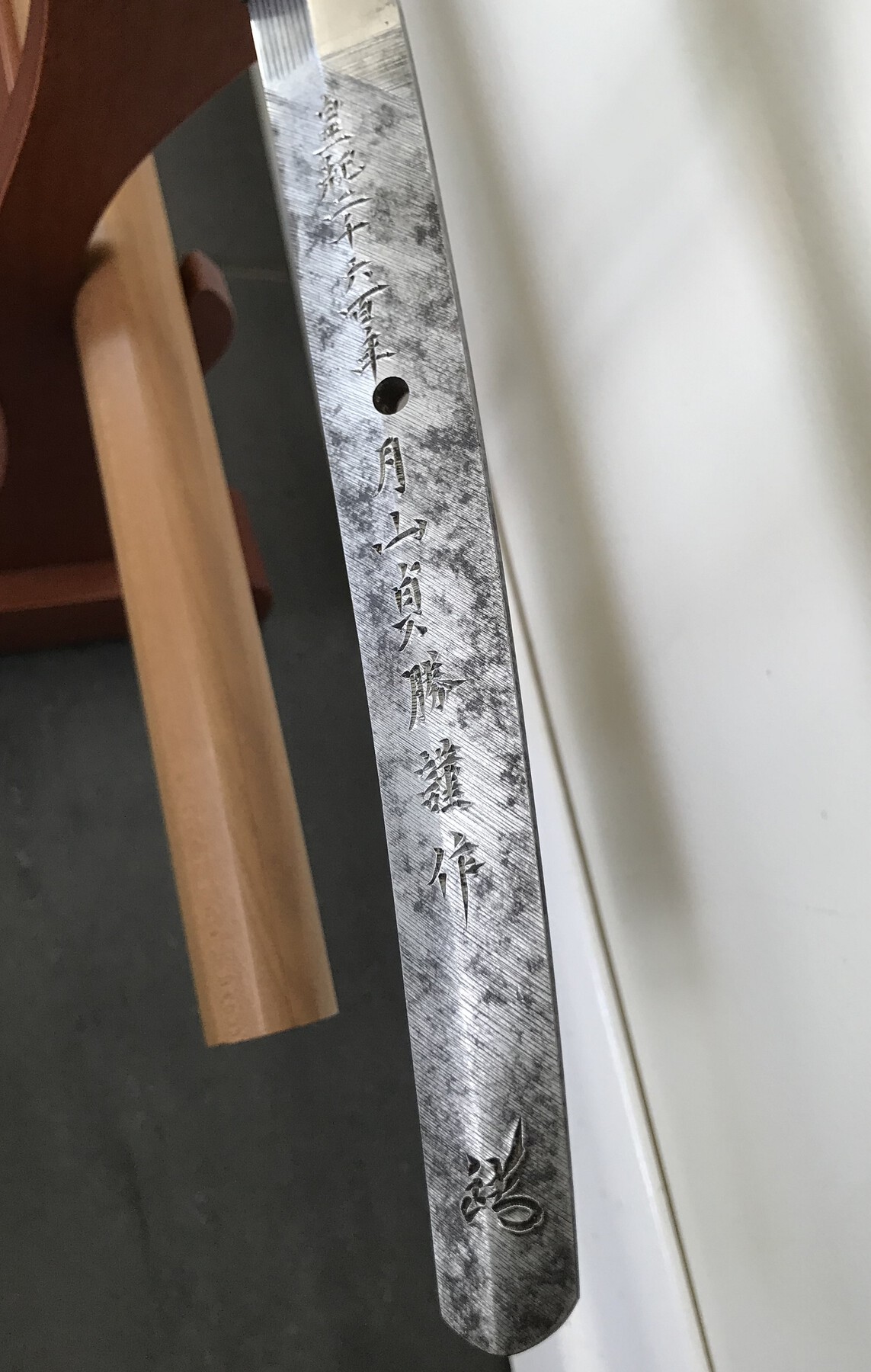

Kiipu Posted July 14, 2021 Report Posted July 14, 2021 The characters on the obverse side of the tang are as follows. 皇紀二千六百年 = 1940. 月山貞勝謹作 = Gassan Sadakatsu kinsaku. At the very bottom is Gassan Sadakatsu's signature [花押 = kaō]. 1 Quote

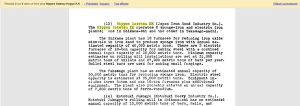

Jacques Posted July 15, 2021 Report Posted July 15, 2021 About Nippon Satetsu Kogyo K.K. https://dl.ndl.go.jp/info:ndljp/pid/9898558 https://iss.ndl.go.jp/books/R100000002-I000006834386-00 John, Off topic you don't understand what i meant. Do you want us to talk about atoms, dipole moment, electrons, what makes matter and its functioning? Quote
Bruce Pennington Posted July 15, 2021 Report Posted July 15, 2021 4 hours ago, PNSSHOGUN said: Of course Jacques, the sword below proves Sadakatsu was making oil tempered showato, right? https://warpathmilitaria.com/product/star-stamped-tachi-sword-gassan-sadakatsu-rikugun-jumei-tosho-196/ Thanks John! I didn't have a star-stamped Sadakatsu in the files! I wish the site had said what they meant by "tosho #196" sounds like a number on the mune. No pics though, sigh. Quote

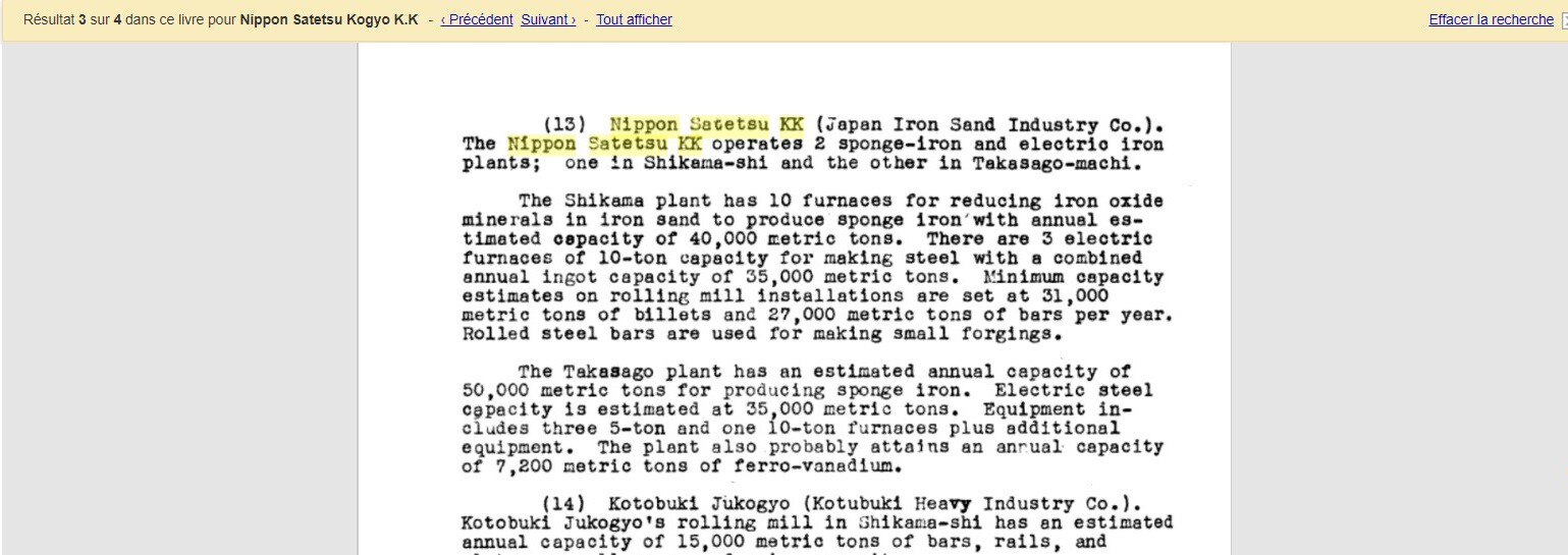

Bryce Posted July 15, 2021 Author Report Posted July 15, 2021 G'day Guys, So far I have evidence that the company produced sponge iron, vanadium and titanium oxide, but no evidence that they went on to produce steel from the sponge iron. Cheers, Bryce Quote
Jacques Posted July 15, 2021 Report Posted July 15, 2021 Bryce, Here : https://tinyurl.com/5f3xsr2d 1 Quote
Bryce Posted July 15, 2021 Author Report Posted July 15, 2021 Thanks Jacques, So the company did produce steel from the sponge iron. The question remains did Gassan Sadakatsu make these swords from sponge iron in the traditional manner or did he start with "Western style" steel billets produced by the company and does it really matter? Cheers, Bryce Quote

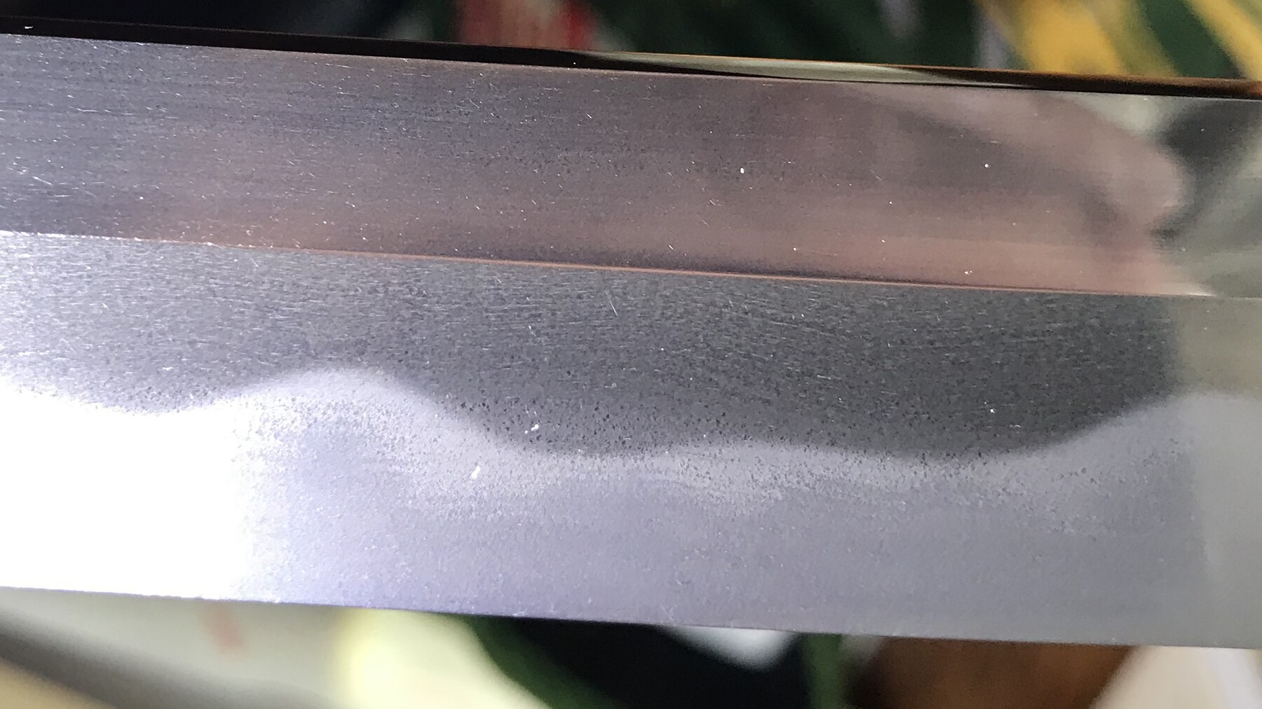

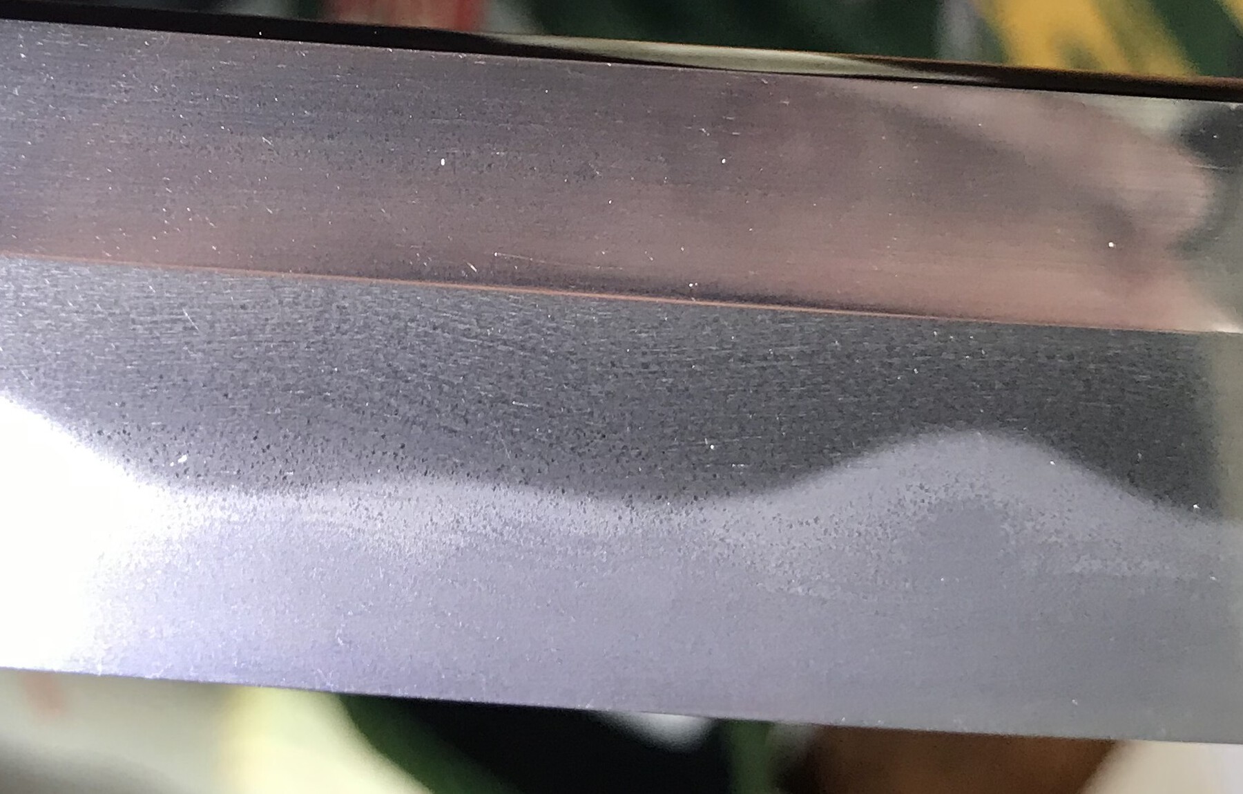

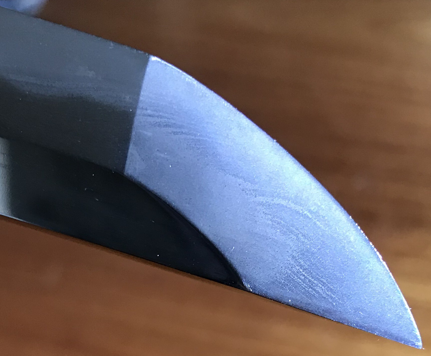

Bryce Posted July 19, 2021 Author Report Posted July 19, 2021 G'day Guys, Thank you for your interest in the topic. I managed to purchase a copy of the 40 year history of the company. Maybe it will shed some light on the subject? Here is a shot of the boshi. Very difficult to take good photos with an iphone. Cheers, Bryce 5 1 Quote
