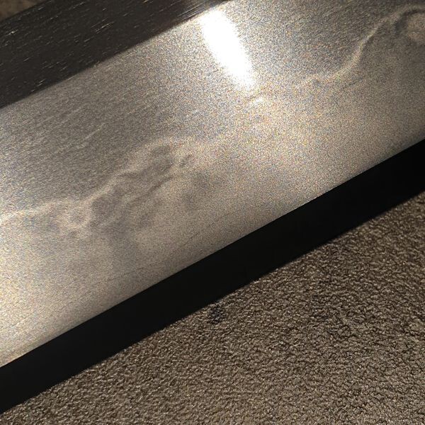

Volker62 Posted July 13, 2021 Report Posted July 13, 2021 dear Friends a very beautiful Tojin Masakuni from a 45 year old collection,parctially untouched, new condition 8 Quote
robinalexander Posted July 13, 2021 Report Posted July 13, 2021 Hi Volker, For me, this is a very nice complete package and der hamon sehr schon. 👍 1 Quote

Volker62 Posted July 13, 2021 Author Report Posted July 13, 2021 friends I'm sure that's what you enjoy a great sword by a very good Gendai smith 2 Quote
drb 1643 Posted July 14, 2021 Report Posted July 14, 2021 Thank you very much for posting this Volker. You do take great photos of an amazing sword! Tom Quote

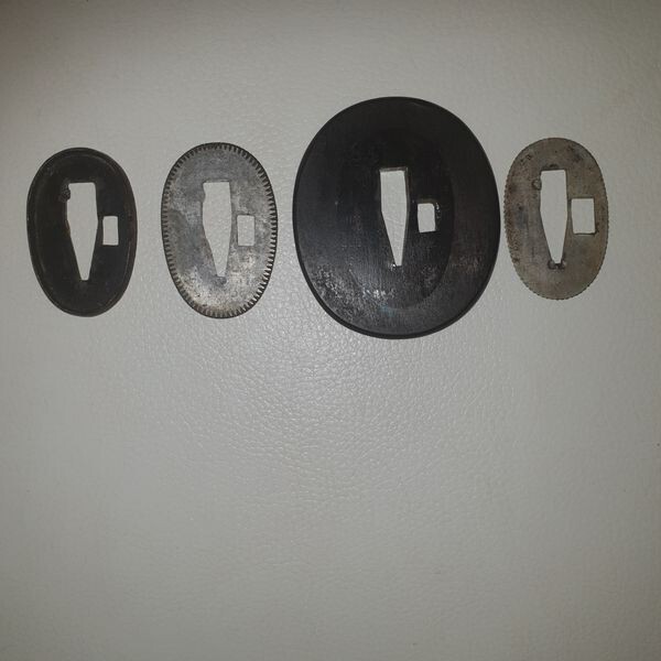

Bruce Pennington Posted July 14, 2021 Report Posted July 14, 2021 Thanks for the mune photo! The photos of the seppa/tsuba are almost clear enough to tell, but it looks like they are not numbered? Are there numbers on ANY of the fittings? There don't seem to be any. Quote

Volker62 Posted July 14, 2021 Author Report Posted July 14, 2021 Good Day Gent's Dear Bruce no stamp's of any kind.... please have a close up to the attached pic Quote
