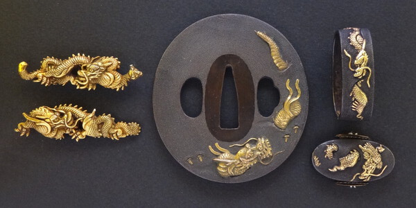

shakudo Posted July 15, 2021 Report Posted July 15, 2021 Hi Mark, Bit late to this but I waited and waited until I could achieve what I thought of as a matching koshirae. I purchased a daisho koshirae with a dragon theme. All fittings are shakudo- fuchi kashira match but the dragons are in different positions and I strongly suggest they were made by the same hand- mumei. The menuki are the same - made by same hand , different poses and sizes for the dai and the sho- may even be the same maker as fuchi kashira - need papering! Also tsuba are a matching set but are a different maker as style of features on dragon heads vary from the others and background is not nanako as the F/K- when I get some decent pics I will post. Mind you It has taken me nearly ten years to find this daisho but I am extremly happy with them- my unicorn! I have other koshirae and have always been disappointed on the mismatched fittings- even though I greatly appreciate the craftsmanship of each piece. My feeling is that unless a koshirae was special order they are nearly always mismatched due to the many reasons already discussed. But they are out there! ps. Hope the poor pics I have at present load. Regards Quote

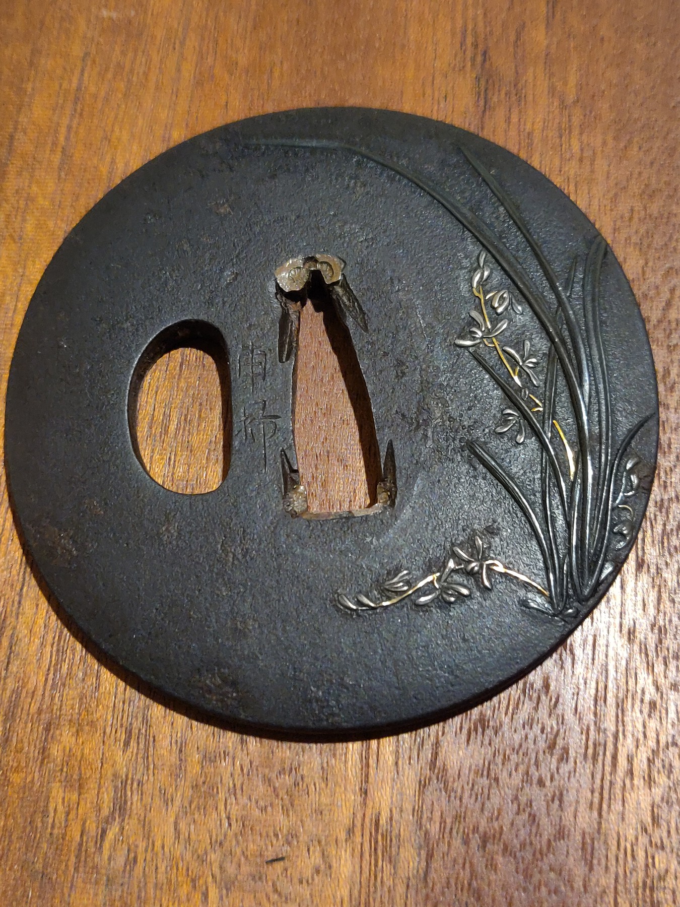

Tanto54 Posted July 17, 2021 Report Posted July 17, 2021 Dear Mark, In building on Steve's comments, it can be very rewarding to study and understand Japanese themes when building your koshirae. For example, I think that your second tsuba is an orchid (I do see how it looks like a Lilly, but in this case, it is the way that Japanese usually depict orchids - see sumie orchid below). Why would a Samurai want an orchid on his tsuba? Was he a florist? Did he just like flowers? Did he just want a “pretty” tsuba? I don’t think so… As you probably know, through much of history, Samurai were not allowed to wear jewelry and their clothing was fairly uniform. In addition, their interaction was very regimented. Therefore, one of the only ways that a Samurai could show his personality was through his koshirae/tosogu (after all, it was their swords that defined them). So why an orchid? The ancient Japanese had a well-know theme called the Four Gentlemen which consisted of orchid, bamboo, plum & chrysanthemum and, when combined, symbolized uprightness, purity, humility, and perseverance against harsh conditions. So perhaps this tsuba was originally intended to be combined with other tosogu that depicted bamboo, plum & chrysanthemum. To me that would be a logical reason for a Samurai to have an orchid on his tsuba… Of course, you can dress up your swords any way that you want, but if you desire to have something more authentic, then you need to study the culture/themes closely and choose something that “speaks” to you. You don’t want your two swords to end up looking like these guys… (who thought they understood the culture they were emulating…) 1 Quote

MHC Posted July 18, 2021 Author Report Posted July 18, 2021 Thank you George, that is very insightful information about the 4 gentleman theme, I like it. Anybody know of a written source that outlines themes/stories/fables and their meanings in the Japanese culture from days gone by? It would need to be in English as my Japanese is nonexistent. Mark 1 Quote

MHC Posted July 22, 2021 Author Report Posted July 22, 2021 Hello George, Found this online, and thought this could be another reason to have an Orchid on a Tsuba. "By the early 17th century, the orchid flower was a symbol of respect and admiration in Japanese culture. Orchids became so revered in Japan that growing orchids was sometimes considered a noble art form. In particular, dendrobium orchids were grown by Japanese royalty for their fragrance and beauty. Another orchid that has a special place in Japanese culture is the Neofinetia falcata, also known as the wind orchid. These orchids are sometimes popularly called samurai orchids, mainly because samurai were known to grow them as symbols of bravery and peace." Probably just trying to rationalize my western likes....but what the heh. Mark 2 Quote
Tanto54 Posted July 22, 2021 Report Posted July 22, 2021 Nice Mark! I think you are on the right track. If either of those themes appeal to you (the Four Gentlemen or Bravery/Peace), then I think that you would have greater choices of tosogu to bring together to form an "authentic" koshirae. Much better (in my opinion...) than simply trying to find tosogu that exactly match your existing tsuba in subject, metal and style. So for example, if you like the bravery/peace theme, you could find other tosogu (in complementary color/style) with that meaning like Idaten - the God of Peace (who is usually depicted as a brave warrior). A well trained Samurai would be able to understand the unified theme and how the parts fit together. Quote
