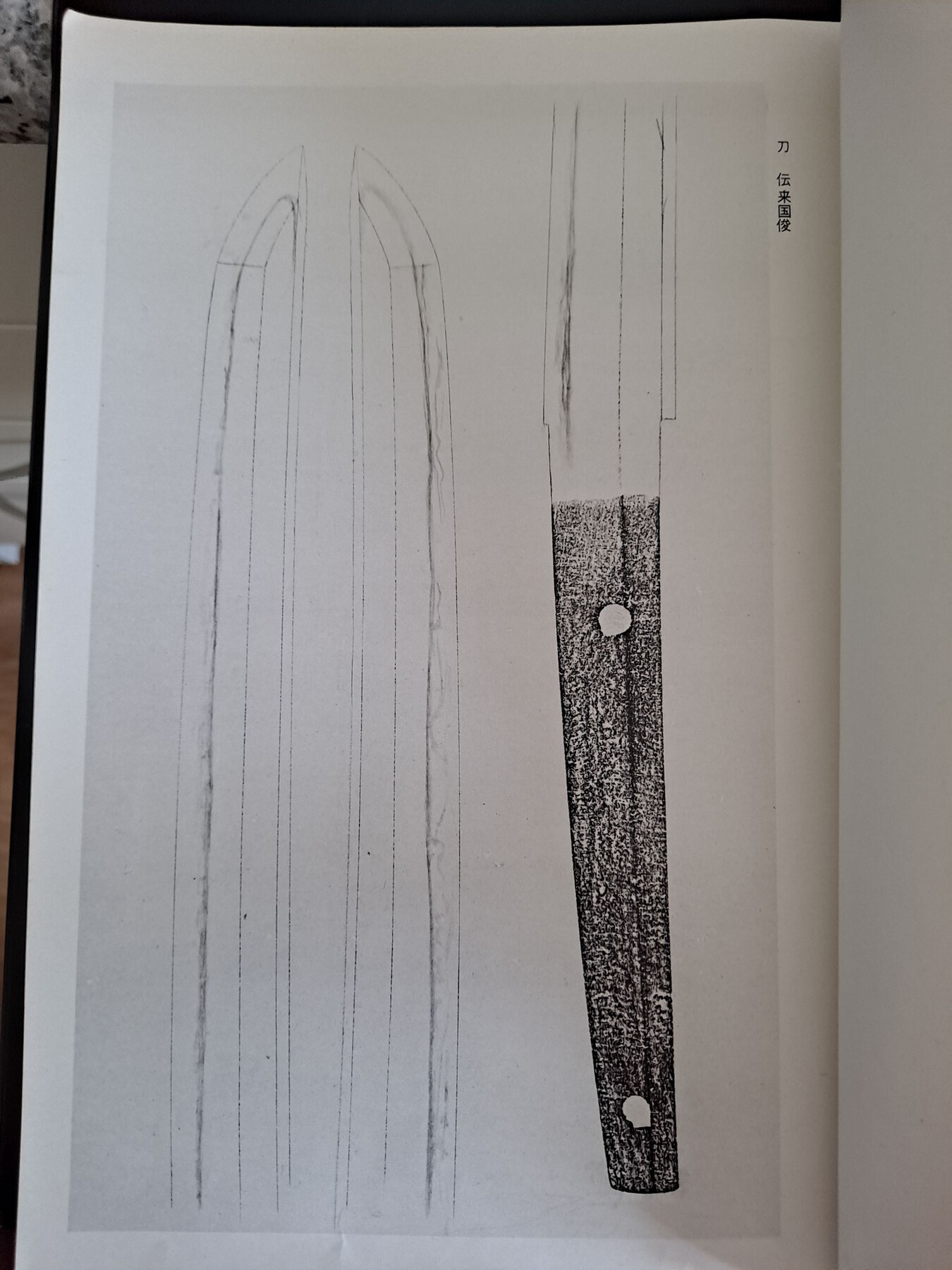

Jussi Ekholm Posted July 9, 2021 Report Posted July 9, 2021 Here is the book entry for those interested of it. It passed long time ago in session 11. Congratulations of the item Jiri. 1 Quote
Gakusee Posted July 9, 2021 Report Posted July 9, 2021 Thank you, Jussi. Interesting setsumei and thought-provoking.... talks about the characteristic style of the smith, the itame - nagare hada, the ko-ashi and ko-nie. From the photos, I would say the jihada looks pristine/perfect but the setsumei highlights some roughness here in there, known as Rai hada. But in photos it looks great and I am sure/hopeful it will be the case in hand. Physical examination will show best. But as highlighted above, the last few sentences are important and here the setsumei ends by saying that the jiba (i.e. jihada and hamon) is skillsful/masterly: calls the jiba sugure (優れ), 2 Quote
