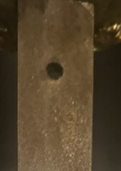

When I bought it, it came with this card. I fully disassembled it yesterday and confirmed it is the same signature on the tang. Here's where I'm at a loss: the seller (at a gun show) told me that it is from 1880's...another person told me 1942.

The date says made in September in the 18th year of Showa. Showa began in 1926 but ignore the first year in calculating the date so I make it 1943.
The signature on the other side reads “Sukemitsu”. I’m suspicious that there used to be a stamp above this that would indicate that it was a non-traditionally made blade. This looks to have been filed off - you can see where there is a blank area in the diagonal file marks.
I hope you didn’t overpay the gun show guy based on it being a pre-war blade or traditionally made.

Limit is for post, hit CTRL+F5 if it won't reset. I see nothing catastrophic here, a classic Type 98. Bonus if Gendai but can't say anymore until there are better photos of the Hamon.
Winchester, by the mekugi-ana on the obverse side which has the signature, there is a small marking.  It looks like a 名 stamp such as appears on the reverse side of the tang above the date.  Can you confirm this is indeed the case?
More than mass produced it was either produced with machine assistance, or any steel other than tamahagane. In my opinion, there is no much difference between a Showato blade and a traditional blade when it comes to utilization. However, Showato is not constructed in the traditional fashion.
Many smiths signed their work, machine assisted or not, as well as some Smiths didn't sign their work and left it mumei. It just depends for various reasons.
I wouldn't consider your blade mass produced like an NCO gunto but it's not nihonto either.
Agree with Marco.  You'll find as you get to know more about the Japanese sword, from the very beginning, that smiths often didn't sign their blades.  It's called mumei when not signed, and you'll see very old and beautiful blades that are mumei as often as you will see them signed.  So, the practice seemed to continue all the way through WWII.  It is often said that when rushed, when large quotas must be met, the smiths would skip signing.  Sounds plausible.
When Japan moved into China for real in the 1930s, and WWII escalated, the demand for swords greatly exploded.  Industry had to make advances in mass-production to attempt meeting the needs of the military.  Machinery aided in steel making and blade production, but they were always tools.  Real people made all the war blades.
It's hard to tell from your photos what kind of production was used on your blade.  It's not stamped, so there is a good chance it's gendaito, but only the blade can tell, and that from first-hand inspection from an expert.  But, well-lit photos and clear close-ups can help guys on the forums make an educated guess sometimes.
