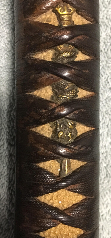

IJASWORDS Posted July 1, 2021 Report Posted July 1, 2021 Bruce, sometimes found on Gunto as a good luck charm or dedication to the Gods for keeping one safe. Here is a WW2 menuki with ken. 3 1 Quote

Ronin 47 Posted July 2, 2021 Report Posted July 2, 2021 "The cult of Acala ( Fudō) first brought to Japan by the esoteric master Kūkai, the founder of the Shingon school, and his successors, where it developed as part of the growing popularity of rituals for the protection of the state...Acala, as a powerful vanquisher of evil, was regarded both as a protector of the imperial court and the nation as a whole (in which capacity he was invoked during state-sponsored rituals) and the personal guardian of ritual practitioners. Many eminent Buddhist priests like Kūkai, Kakuban, Ennin, Enchin, and Sōō worshiped Acala as their patron deity, and stories of how he miraculously rescued his devotees in times of danger were widely circulated." You can find more information here: https://en.wikipedia.org/wiki/Acala, including why one often sees the Dragon paired with the Ken on some horimono, or like the menuki above. 2 Quote
