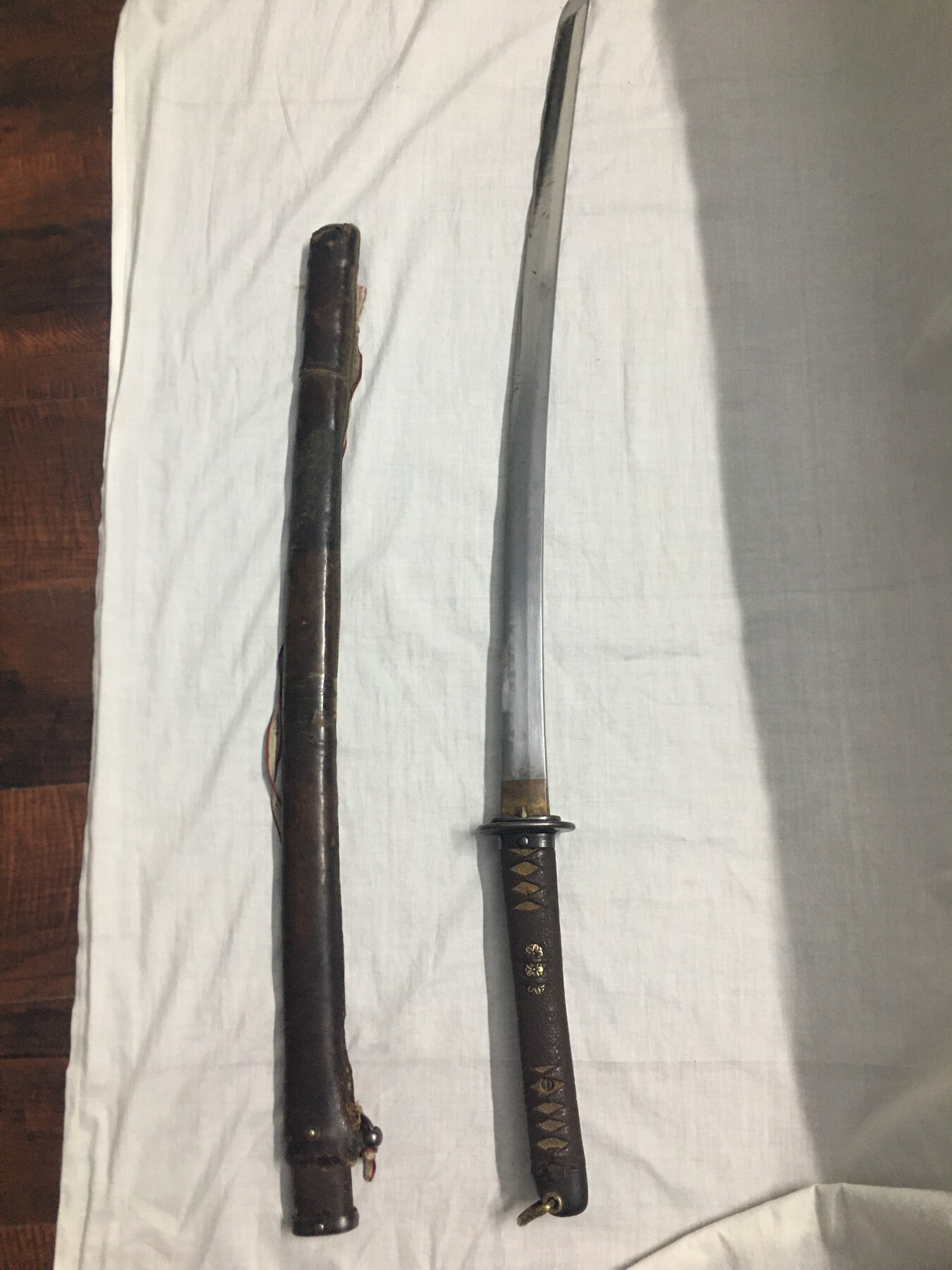

It's real, and in those fittings it most probably houses a nice Gendaito blade. Maybe a RJT one.
You'll need to take off the handle so we can see who made it. Looks good though.
Someone has fitted an ordinary iron screw into the Mekugi hole. Gently unscrew and remove that, and with luck the Tsuka (hilt) should slide off. If it doesn’t, (they are often very tight), ask again.
(Watch your fingers though. Wrapping the blade in Saran wrap can help with protection, but it’s not fool-proof, especially when the blade has its original very sharp edge.)

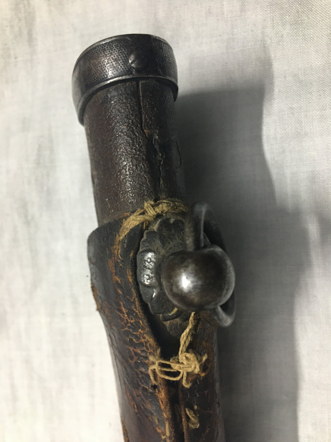

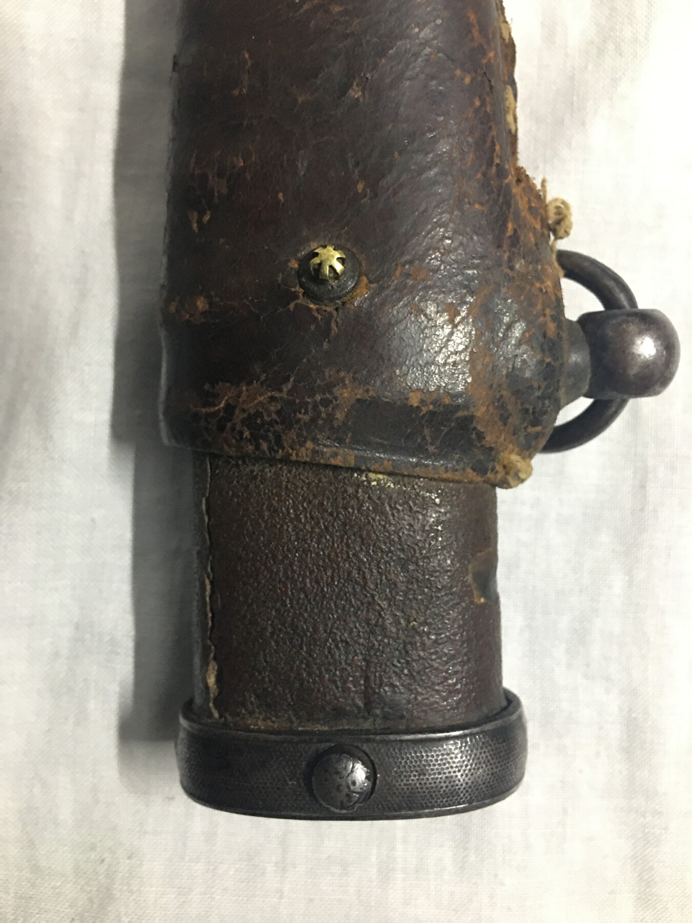

Look for the holes in the handle where there should be a wooden peg. Usually one near the top. But on this one, I think there is another at the bottom.
Please take close up pics of those, both sides, so we can see if there is a wooden peg there, or a screw or whatever. Those must come out, and then the handle will slide off downwards to show the tang.
Its, a rinji seishiki koshirae. The quality of the koshirae is above that for showa-to swords so like Brian said we could expect a Gendaito blade in it. Be carefull with the sword and avoid any damage or bad threatment.
You have 2 screws to remove from the tsuka (handle).  Then it will come off.  If it resists, don't worry, you won't harm anything to force it off (as long as you have both screws removed!).
All the rest of the parts look original. Once you get the screws out, give us photos of them.  They might be original too, though unusual to have 2.  Normally it is 1 screw near the tsuba (handguard) and a bamboo peg (mekugi) at the top end.
You can read about the development and history of this Contingency model or Rinji-seishiki, like Trystan said.  There are many names you will find collectors using like "Type 3", "late-war", "Marine" or "Navy Landing" sword.  But none of them are legit IJA names.

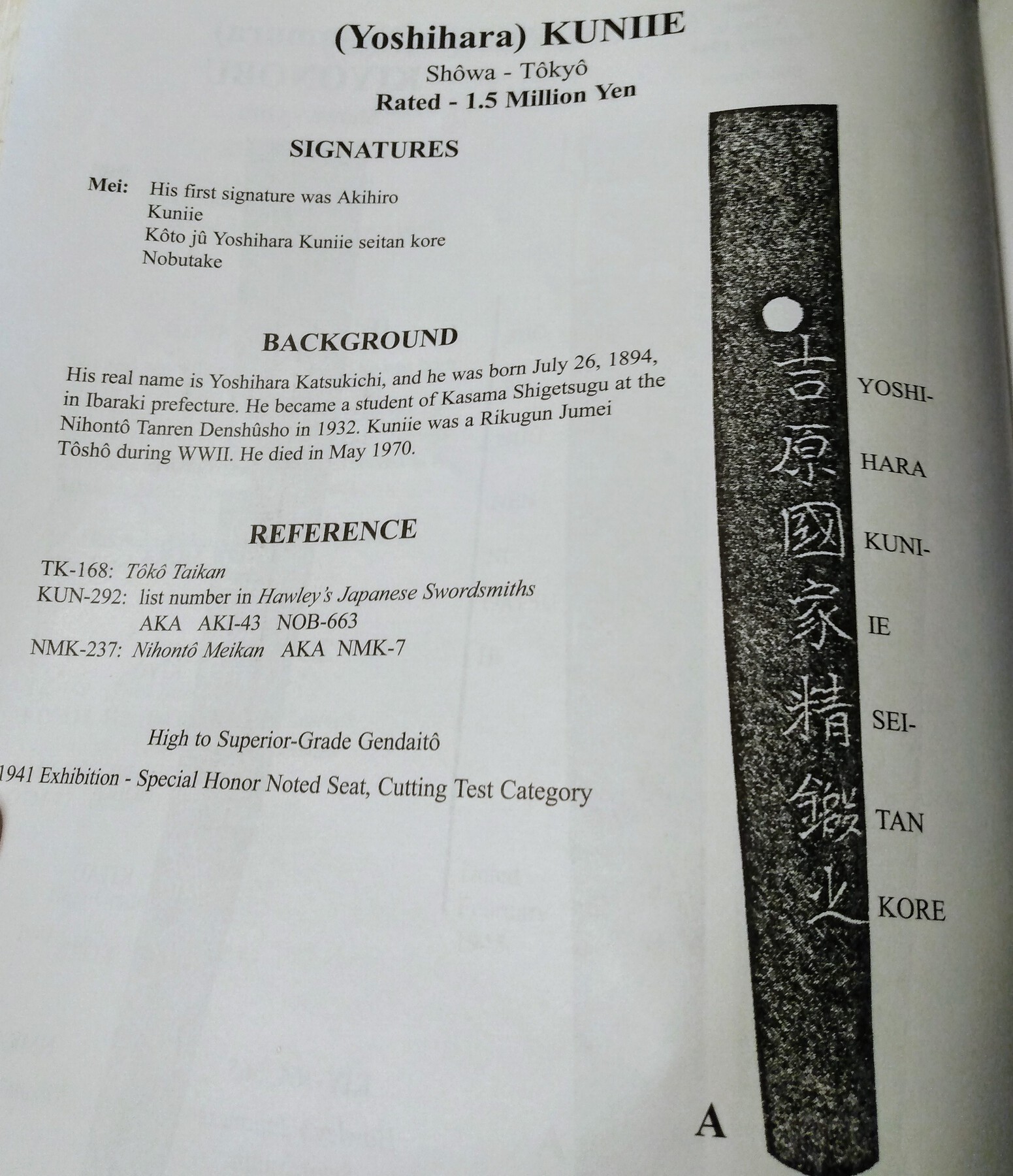

Thanks all . This blade was made traditionally right bruce . There is another number on the bottom as well . I have attached the pictures ..name of the maker ??
Amad,
Here is some really interesting information about "Nobutake" who was really Kuniie, a swordsmith instructor at the Tokyo 1st Army Arsenal, and inspector for the RJT program there:
"Submitted by Yoshii on Mon, 2009-09-07 11:45.
Information about Kuniiye
Born 26 juli 1894 in Ibaraki prefectuur
Passed away in 1970
Familyname: Yoshihara, Surname : Katsuichi
In 1933 he became the first official student at the Nippontō Tanren Denshujo
Student of Kasama Shigetsugu (shi 907)
Signed : Akihiro
Akihiro saku
oite Tokiwamatsu Yoshihara Akihiro saku kore
After 1943 Nobutake
Yoshihara Nobutake
Tokyo Dai ichi Rikugun Zoheisho Yoshihara Nobutake
Yoshihara Kuniiye
Yoshihara Kuniite saku
Yoshihara Kuniiye kitau kore
Musashi kuni jū Yoshihara Kuniiye seitan kore
Kōto jū Yoshihara Kuniiye seitan kore
In 1937 he became teacher at the Kyushu University Kingakubu Nihonto Kenkyujo.
In 1938 he started his own smithy in Nihon So Tanrenjo, in Setagaya, Tokyo
He was appointed by Kurihara Akihide as smith at the Nihonto Gakuin, (Japanese Sword Institute) in Sagamihara-cho, Zama (Sobudai), Kanagawa Prefecture.
He also beacme instructor at the Tokiwamatsu Tanren Kenkyu Jo in Shibuya, Tokyo on the estate of Toyama Mitsuru, afterna Shigetsugu had left
Hij works in Bizen and Sōshū den, he also makes utushi mono of Kiyomaro.
He was appointed Rikugun Jumei Tosho during the war.
In 1943 Kuniie was appointed as the smith instructor of the Japanese Imperial Army in the Tokyo Dai Ichi Rikugun Zoheisho, the militairy arsenal in Akabane, Tokyo.
From 1945 till 1953 he was not actice as a swordsmith. In 1953 Kuniie he started again as a swordsmith and got a licent as swordsmith, from that time on he began to teach his students the making of the Nihonto'
This is from The Nihontoclub 'Kuniie' page.
Star-stamped blades are made by RJT qualified smiths and are made with army-supplied tamahagane and locally supplied charcoal, and made in the traditional way, therefore true nihonto, or gendaito.
No one knows for sure the meaning of the stamped numbers.  They are found almost exclusively on RJT blades, so I personally feel it has something to do with their accounting or inspection system.
