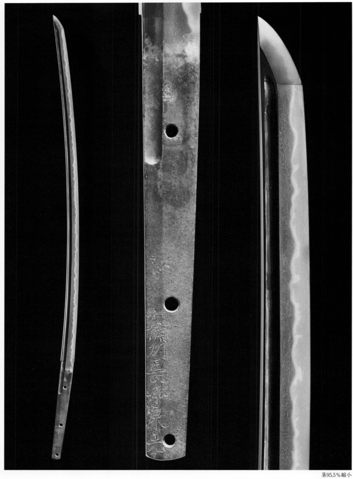

Utopianarian Posted June 23, 2021 Author Report Posted June 23, 2021 To quote Darcy from Feb 2014: About: nagamei on Oei Bizen with no date. Juyo 19 has a tachi signed "Bishu Osafune Yasumitsu" with no nengo. Juyo 21 has the same. Juyo 29 has the same (example included). Juyo 38 has the same. Juyo 42 has two tachi like this. Juyo 18 has a signed "Bishu Osafune Morimitsu" tachi with no nengo. Juyo 32 has the same. Juyo 13 has a tachi signed "Bishu Osafune Moromitsu" with no nengo. Juyo 56 has the same. There are others. Additional facts: There are tachi with nijimei and no date. There are tachi with nagamei and date. There are no tachi that I can recall that have nijimei and date. There are numerous katana, wakizashi and tanto with nagamei and date. There are tanto with nijimei and no date. There may be other configurations, this is off the top of my head for what I've seen. My conclusion: 1. obviously nagamei with no date is an accepted signature form for Oei Bizen and is not to be ruled out. 2. the accepted examples all seem to be tachi and rather large examples as almost all are slightly suriage, so it may be restricted to this form and one would have to look at a katana in this configuration skeptically. 3. it's possible that these were dated below the signature but it does not seem to be the case from these examples and the positions of the signatures, and I didn't see any that did follow this pattern, though I have seen it on Aoe. But without anything solid it is just speculation. 3 Quote
Jacques Posted June 23, 2021 Report Posted June 23, 2021 George, Nagamei without nengo on ubu swords ? I would love to see them. For example, the Osafune taikan lists 41 swords by Morimitsu from 1394 to 1426, 47 swords by Yasumitsu from 1397 to 1446 and 8 Moromitsu from 1398 to 1405. All have a nagamei and a nengo. Quote
DKR Posted June 23, 2021 Report Posted June 23, 2021 On 6/23/2021 at 3:19 PM, Jacques D. said: It's simple, the swords forged from the OEI era onwards and bearing a naga mei (Bizen Osafune so-and-so) must have a date on the other side of the nakago. If this date is not present, the signature is gimei (false). Expand Jacques, Thank you for your patience to explain your personal opinion to me. Quote
Gakusee Posted June 24, 2021 Report Posted June 24, 2021 So, just looking at the Juyo Zufu, and going by the fact that where there is nengo, they always show both sides of the nakago and the setsumei explicitly mentions the nengo, there are numerous Yasumitsu examples with naga mei and no nengo mentioned. Some of these swords were sold in various DTI fairs, so we have some photos in the DTI catalogues. So, as the Juyo setsumei does NOT mention the nengo (it always DOES when there is such) by extrapolation, there is no nengo. Two Juyo examples attached from the DTI catalogues. 3 Quote

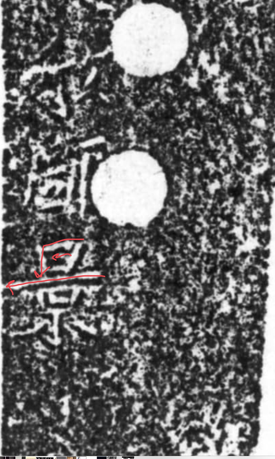

Utopianarian Posted June 24, 2021 Author Report Posted June 24, 2021 Thank you Michael, What are your thoughts regarding gyaku-tagane style chisel-strokes which can have some indication on a particular smith ie.. Chikage, Yoshikage, Morikage and Mitsukage for example. What indicators do you look at to generally tell if the chisel-strokes are left to right as opposed to normal saka tagane from right to left. I assume the chisel lines narrow pointing to the direction of the intended chisel stroke. I cannot find any literature of how to determine style of chisel stroke. Please advise. Thank you Quote
Gakusee Posted June 24, 2021 Report Posted June 24, 2021 Ha, that is an advanced topic, George. I am at a medical appointment but when I get a chance / access to my records, will try to add colour. In reality, indeed you can deduce about an individual smiths by gakutagane but I have not delved deeply into Oei smiths and direction of chisel strokes. I do remember reading this for other smiths / schools. As to how you can tell which way they go, that is not difficult - you can tell by the termination of the final chisel stroke as that is always on top of the others in a small triangular shape. So if the apex of the triangle points right then it is left to right and if the triangle points left then it is right to left for horizontal or diagonal strokes. Again, will need to append some images at the right time. 2 Quote

Jussi Ekholm Posted June 24, 2021 Report Posted June 24, 2021 One thing to note that the signature is - 備前国長(船) - Bizen no Kuni Osa(fune). This particular signature style is extremely uncommon in Ōei-Bizen blades that I have so far recorded. I have around 100 Morimitsu swords and 0 with this signature, and bit over 100 Yasumitsu swords and 1 has this signing style (Tanto from Jūyō 31). This signature style was more common is swords of Kamakura and Nanbokuchō period and the potentially appearing again from Late Muromachi (although as I focus on early swords my data on later swords is bit limited). 1 Quote
Utopianarian Posted June 24, 2021 Author Report Posted June 24, 2021 Jussi, Thank you for your knowledge on this sword. You have contributed a great amount of knowledge here on the board. I often reference the impressive statistics and informative topics that you contribute to on other interesting swords. Especially the golden age which I have much interest. I am still trying to find out more about this sword. It does take time and different perspectives of knowledgeable folks with the same interests George Quote

Gakusee Posted June 24, 2021 Report Posted June 24, 2021 On 6/24/2021 at 10:03 AM, Utopianarian said: Thank you Michael, What are your thoughts regarding gyaku-tagane style chisel-strokes which can have some indication on a particular smith ie.. Chikage, Yoshikage, Morikage and Mitsukage for example. What indicators do you look at to generally tell if the chisel-strokes are left to right as opposed to normal saka tagane from right to left. I assume the chisel lines narrow pointing to the direction of the intended chisel stroke. I cannot find any literature of how to determine style of chisel stroke. Please advise. Thank you Expand George Just checked some sources. According to Tanobe sensei: ”The Aoe school smiths of Bitchu province would be a prime example of the smiths that very commonly used saka-tagane. The old Aoe smiths worked prior to the mid Kamakura period, as well as the later Aoe smiths of the Nanbokucho period, consistently used quite a bit of saka-tagane in carving their mei. Among the Bizen province smiths, so called the Un~ group smiths including Unsho , Unji and Unju, and Chikakage, who was a student of Osafune Nagamitsu, as well as smiths in Chikakage's line who also used the kanji character "Kage"as a part of their names including Morikage, Yoshikage, Mitsukage, Norikage and Morokage, all shared the same habit of using saka-tagane. Authentic works of the Yoshii school smiths also show this characteristic. The main line of the Osafune school was succeeded by Nagamitsu, Kagemitsu and then Kanemitsu, but they all used jun-tagane [normal tagane]. On rare occasions, we encounter authentic blades with Kagemitsu mei carved with saka-tagane. These, however, can be understood as dai-mei actually carved by the peripheral line smith Chikakage on behalf of the mainline smith Kagemitsu.” When you look at sakatagane or juntagane, it is not about left or right. It is whether the stroke is chiselled In the correct/usual direction or in the opposite direction. So, if the correct direction is left to right then sakatagane would be right to left. So, he gives an example with the Rai character and Kuni character for some of the Rai smiths that were executed in sakatagane. Namely strokes one and four (the horizontal strokes) in “Rai” are chiselled from right to left (sakatagane) while normally they should be done from left to right (juntagane). See the attached image, bottom left. Next, please find attached a short video of the correct kanji stroke order for “Kage”. I have focused on that kanji as it is common across the Bizen guys referenced in Tanobe sensei’s paragraph above about sakatagane. Please watch it a few times to see how it should be executed. I always cheat and use that software to figure chisel strokes and order (shhh, do not tell the teacher!). I show below Kozori Mitsukage and Omiya Morokage and their sakatagane in red mark-up. One has to go through a similar exercise for in-depth analysis. videozip_8.mp4 1 Quote
