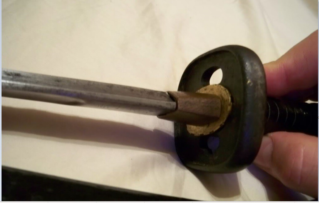

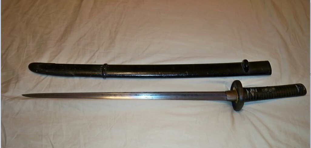

Western Bayonet blade in Japanese mounts... I know nothing else about this piece, and it has been discussed elsewhere.
