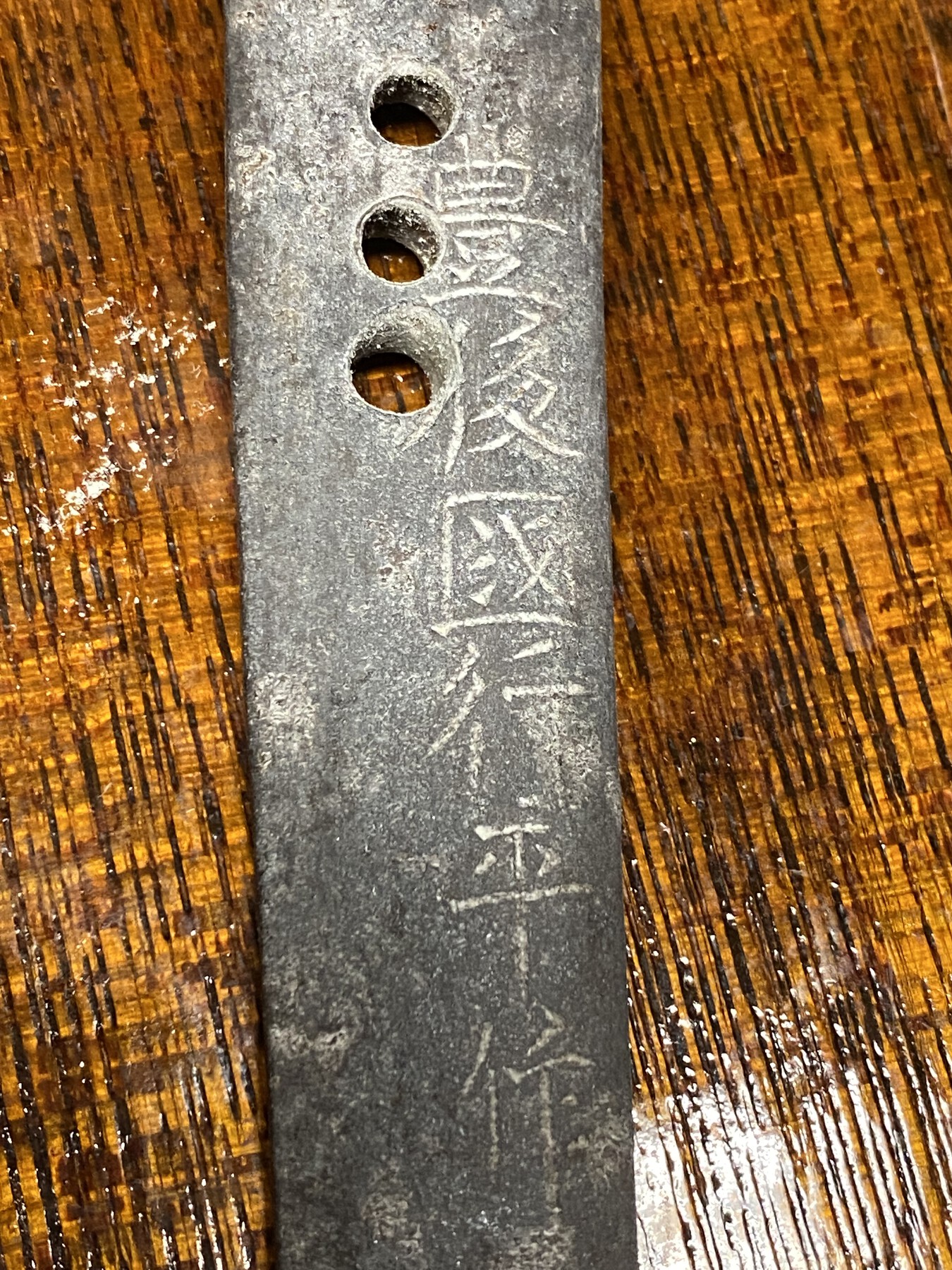

Brian Posted June 18, 2021 Report Posted June 18, 2021 It is a genuine Japanese sword. As for who made it...we need to see the signature on the tang. Nice clear close-up. It does appear to be signed as Yukihira. But less eye strain will help. 1 Quote

Geraint Posted June 18, 2021 Report Posted June 18, 2021 Dear Ted. The mei reads Bungo no kuni Yukihira saku. I also am hoping that the dark patches are a trick of the light in your photograph. As Brian said this is genuine Japanese sword, whether it is a true signature is another matter. Looking forward to some more photographs please. All the best. 1 Quote
Tad Posted June 18, 2021 Author Report Posted June 18, 2021 On 6/18/2021 at 11:56 AM, Brian said: It is a genuine Japanese sword. As for who made it...we need to see the signature on the tang. Nice clear close-up. It does appear to be signed as Yukihira. But less eye strain will help. Expand Thanks Brian. Here is a close up of the signature. It’s been sitting in a chest in our storage for over 50 years. My uncle sent it to my father from Japan but he passed about 6 years ago so we don’t know the history on it. Quote

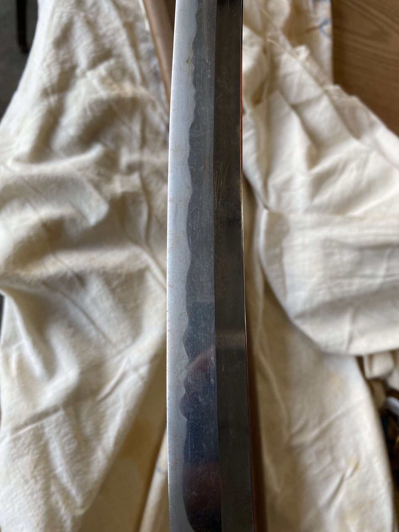

Tom Darling Posted June 19, 2021 Report Posted June 19, 2021 Would be nice if you measured the cutting edge. Also, if the hamon is active in the boshi/kissaki it is koto, if not shinto. Take a pic.of both sides of boshi area. Thank you. Quote
Tom Darling Posted June 19, 2021 Report Posted June 19, 2021 Yukihira never made O-kissaki blades. Early kamakura period. 1 Quote
Jwrussell Posted June 19, 2021 Report Posted June 19, 2021 On 6/19/2021 at 1:45 AM, Tom Darling said: Would be nice if you measured the cutting edge. Also, if the hamon is active in the boshi/kissaki it is koto, if not shinto. Take a pic.of both sides of boshi area. Thank you. Expand See post 6. Seems clear active Harmon in the kissaki to me. 1 Quote
Tad Posted June 19, 2021 Author Report Posted June 19, 2021 On 6/19/2021 at 1:45 AM, Tom Darling said: Would be nice if you measured the cutting edge. Also, if the hamon is active in the boshi/kissaki it is koto, if not shinto. Take a pic.of both sides of Expand 1 Quote

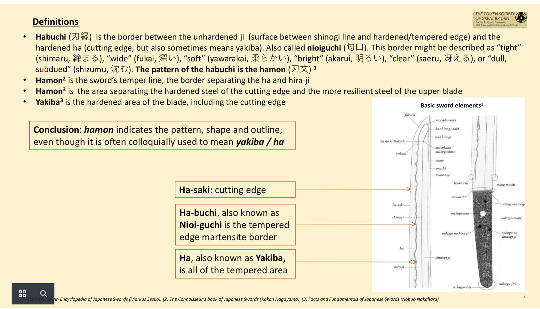

Gakusee Posted June 19, 2021 Report Posted June 19, 2021 In colloquial parlance, hamon is used to describe the ha, also known as yakiba. In fact, the hamon is the outline and shape of the ha, which you can see separated from the ji by way of the habuchi (the border). So, knowing that people use hamon to describe the ha, then an active hamon is one with a lot of activities (ie, hataraki) in it. Therefore dull suguha will not be an active hamon. An active hamon will have several of: sunagashi, kinsuji, tobiyaki (strictly speaking they are outside of the hamon but even hataraki in proximity to the hamon are considered associated with it), yo, yubashiri (see above note on tobiyaki), ashi, different forms of martensite (so combinations of nie/nioi/ko-nie), inazuma, etc etc 2 1 Quote

Jacques Posted June 20, 2021 Report Posted June 20, 2021 On 6/19/2021 at 8:32 PM, Gakusee said: In colloquial parlance, hamon is used to describe the ha, also known as yakiba. In fact, the hamon is the outline and shape of the ha, which you can see separated from the ji by way of the habuchi (the border). So, knowing that people use hamon to describe the ha, then an active hamon is one with a lot of activities (ie, hataraki) in it. Therefore dull suguha will not be an active hamon. An active hamon will have several of: sunagashi, kinsuji, tobiyaki (strictly speaking they are outside of the hamon but even hataraki in proximity to the hamon are considered associated with it), yo, yubashiri (see above note on tobiyaki), ashi, different forms of martensite (so combinations of nie/nioi/ko-nie), inazuma, etc etc Expand Perfect illustration of what I was saying. You confuse being and having. I don't have time now but I'll elaborate later. Quote
