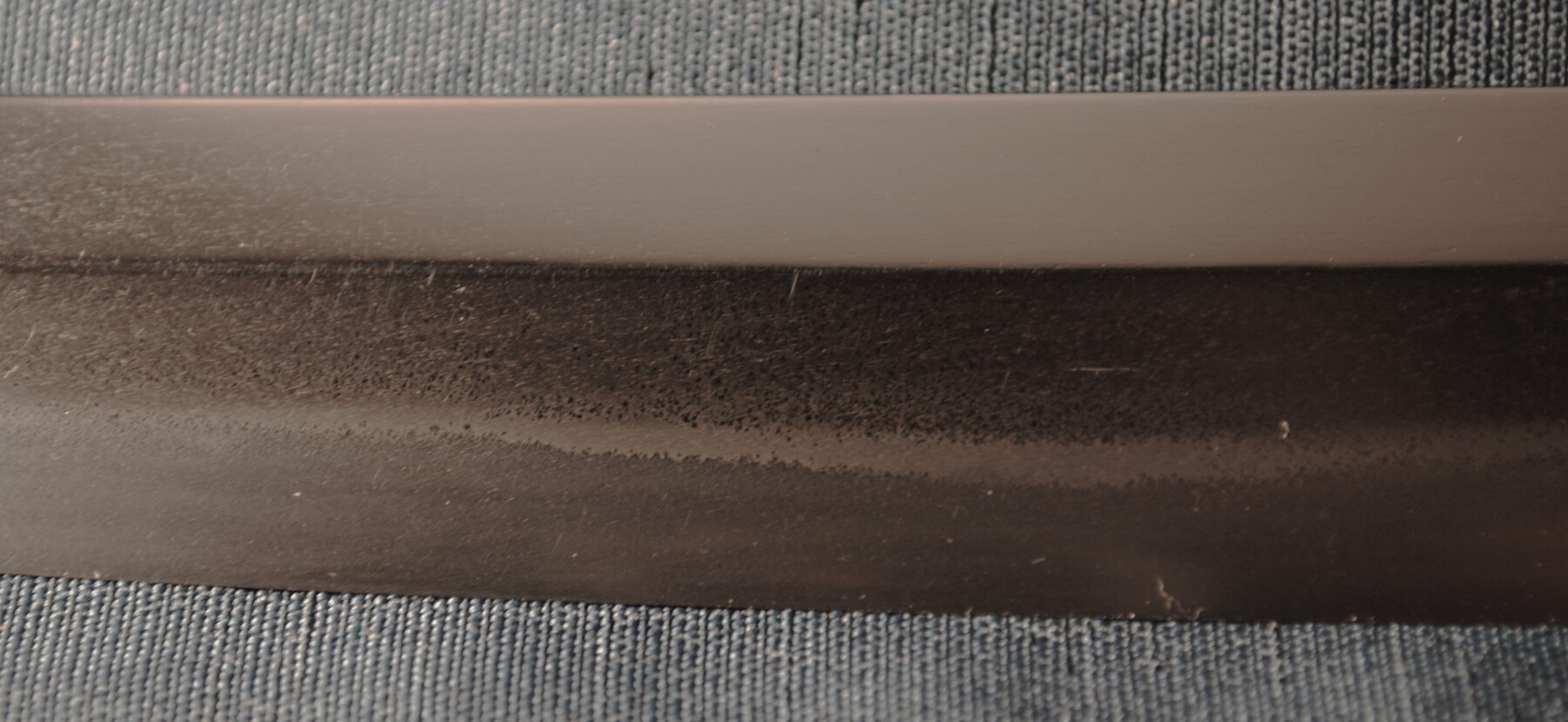

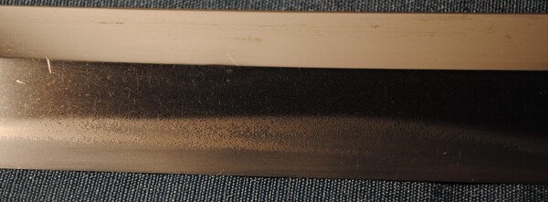

The hada is a very fine and consistent ko-itame. Overall the blade has a great deal of ji-nie which becomes brighter and larger as it progresses to the monouchi. There are also small chickei running the length of the blade. The quality of the forging and the brightness of the nie based activity are outstanding.
Hamon:
The hamon is a very gentle midare based on a suguha foundation. The nioi-guchi is extremely clear and bright and has a characteristic “belt like” form associated with this school.  Running throughout the hamon is a great deal of activity comprising of very bright nie which cascades through the nioi-guchi and creates clouds of nie on the border with the ji. There is kinsuji in the lower half of the blade. As it progresses towards the monouchi the nie becomes larger and brighter in areas it forms nijuba and kuichigai-ba.

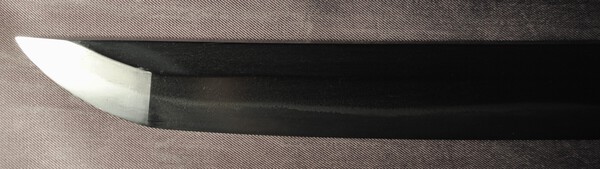

The blade has a slightly small chu-kissaki with suguha boshi which is ko-maru with a short kaeri.
