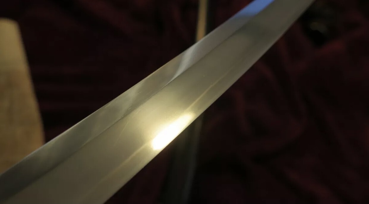

Any one know about this sword ?

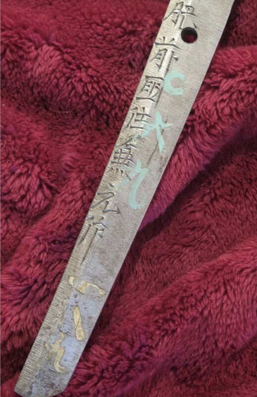

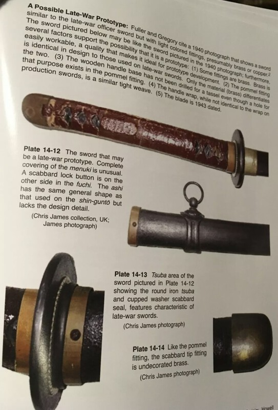

not sure if it’s worthwhile since it’s a late model but it’s star stamped  don’t know if the smith is any one  or if it’s rare I added some documentation
Steve
Any others have additional information about this sword ?
I don’t want to spend money and find out later I made another big mistake!! I did get info from others on the thread and I did aquire a description from fuller and Gregory but any other opinions would be greatly appreciated

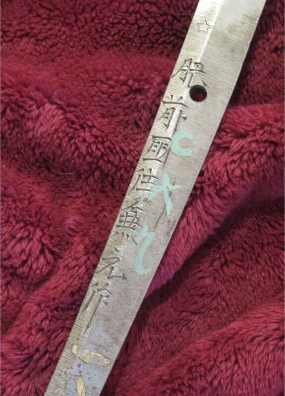

According to Markus Sesko the civilian name of the Kanemoto who made your sword was Motomura Kensaku. He was born in 1907 and studied from 1924 under 3rd generation Muto Hisahiro. He worked as a Rikugun-Jumei tosho which should tell you a lot about your sword if you did a little searching about star stamps.  It also appears he entered the 1941 sword competition, but I'll let you find out how he placed since you have a copy of John Slough's book Modern Japanese Swordsmiths 1868 - 1945..
Was  Motomura Kensaku th name i she be looking for ? Not sure which one I’ll dive a little deeper
all in all I guess it’s by a known smith and was tamahagane used being star stamped ? I’m also guessing it’s rare? I never saw another that style I’m hoping I did ok since I haven’t had much luck lately
steve

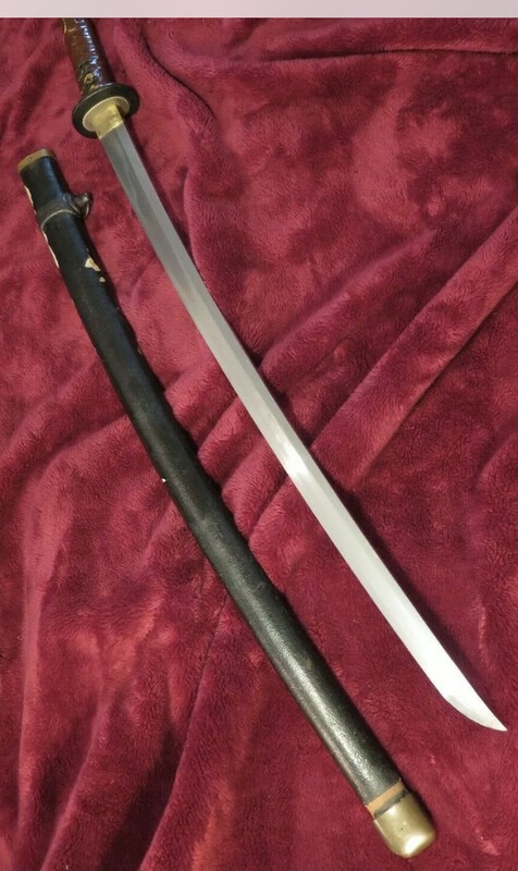

The family name of the swordsmith who made your blade is Motomura. He is listed in the names of the 1941 exhibition participants as "Motomura Kanemoto (Saga)". There were two WWII swordsmiths who used Kanemoto as their art name so don't get them mixed up. I think you are misunderstanding the concept of rare when it comes to the mounts your blade is in. Late in the war Japan was running out of essential materials and in order to save materials needed for the war effort, they simplified the scabbard and mountings in the last couple of years of the war. After using the type 98 mountings for most of the war, then they switched over to the Rinji style. Since it was only used for a couple of years at the end of the war, it's not as common as the type 98, but still there were plenty of the Rinji style made, so personally I wouldn't call them rare. Less common would be a better term.
Steve, there's a lot of good reading about the Rinji seishiki.  I'd start with Nick Komiya's articles:
Unveiling Rinjisiehsiki Sword 1940
Legally Rebutting existence Type 3 Sword
Deflating Another Myth Type 3 Army Officer Sword Expanded Version
There weren't any "official" versions of the model, but you'll see:
"Standard" version with light tan saya, usually showato blade
"Custom" version with textured, dark saya, 2 Release buttons, usually with gendai blade
"Late war" version like yours, turning out to have, so far, gendaito
"Manchurian/Island" made Rinji, with low quality blade
"Manchurian Mantetsu" unique version with Mantetsu blade
That's how I would summarize them.

hi found him in this star stamped also why would it be a lower quality blade if it’s star stamped

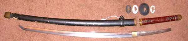

Steve, this sword in question is in fairly uncommon mounts. Being late war, the fittings are very basic, pressed metal, with no detail. If the blade is in good condition, it is a very collectable sword.
