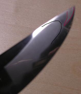

itsoverthere Posted January 13, 2009 Author Report Posted January 13, 2009 Hi Grey, I find this almost fascinating. I am aware that whatever it is I'm looking at is most probably highly undesirable but still I find it interesting. There was certainly no visible opening and yet there appeared to be 2 hamons. I have attached another pic where, in the style of a child's drawing, I have attempted to highlight what it was that aroused this question. Regards, Adam Quote
nagamaki - Franco Posted January 13, 2009 Report Posted January 13, 2009 Hi, holding this up to the light what 'reflective activity', if any, is there coming from the areas between the drawn in black border and what is outlined in red ink? Does the reflective activity match what looks to be the habuchi running out to the cutting edge before turning upward? Quote
itsoverthere Posted January 13, 2009 Author Report Posted January 13, 2009 The area between has an almost mirror-like reflection (like the cutting edge in the kissaki), and - although not so visible in the picture - is quite distinct from the two areas highlighted. What's particularly strange/interesting, for me, is that there is no such pattern on the other side, which only exhibits a turn-back at the same point as the black line is drawn on this side. Quote
itsoverthere Posted January 14, 2009 Author Report Posted January 14, 2009 Is this 2 hamon situation that Grey has described a common forging flaw? How is it possible that it exists on one side but not the other? Does anyone know? Quote

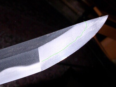

Tokaido Posted January 14, 2009 Report Posted January 14, 2009 Hello Adam, the hamon is not very visible on your kissaki (maybe because of reflections or poor polishing job). Please have a look at this sample of a kissaki. The actual hamon is made up of ko-nie and follows the green line, but there are many nie scattered additionally within the hamon in nie-kuzure fashion (the maker is famous for this type of nie scattering within the hamon) Greetings Andreas B. Quote
