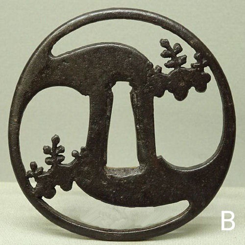

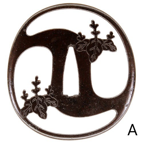

MauroP Posted June 11, 2021 Report Posted June 11, 2021 Some more stuff to give a try: 3 tsuba papered Higo, Kamiyoshi and Nishigaki. Which is which? (sorry for the pics, no others/better ones available). Spoiler A Kamiyoshi,. B Nishigaki, C Higo Quote
Curran Posted June 12, 2021 Report Posted June 12, 2021 Ha- Got all three! I like the Nishigaki. Quote
