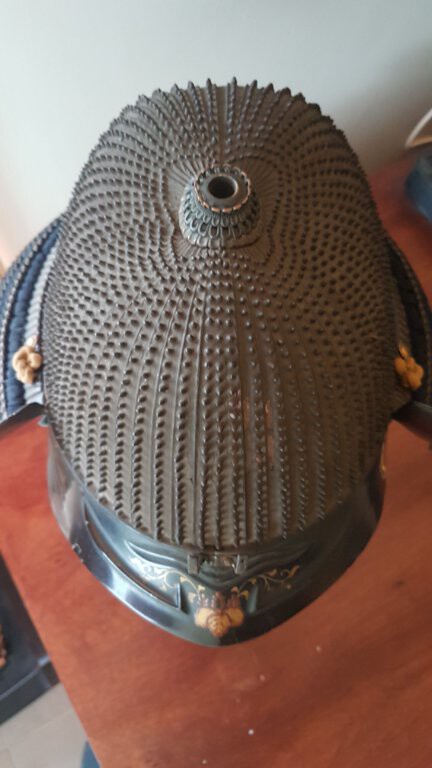

Tengu1957 Posted June 5, 2021 Report Posted June 5, 2021 62 ken Koboshi Kabuto with 2000 rivets Edo Jidai with Tokubetsu Hozon paper ( doesn't mention school ) Russet iron Menpo 1 1 Quote
Luc T Posted June 5, 2021 Report Posted June 5, 2021 The nkbkhk papers don’t mention a school easily without a reliable signature. Not because the don’t have an opinion, but simply because it is tricky. this kabuto could be momoyama too, but it is certainly early edo or earlier. Also here, they stay prudent. No space for a wrong guess. again a fine old warbeast Gary! Quote

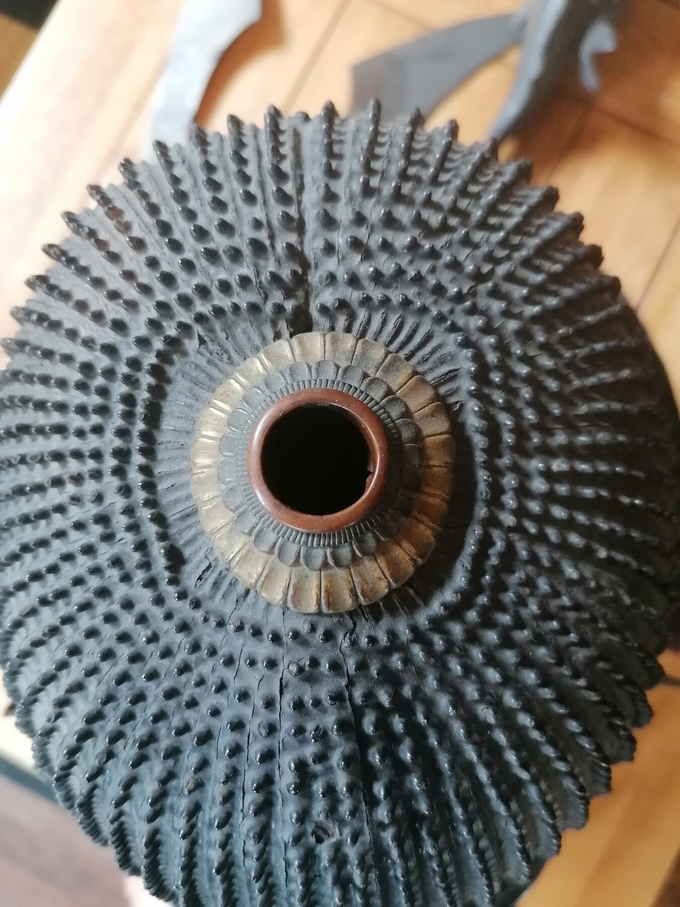

Luc T Posted June 5, 2021 Report Posted June 5, 2021 On 6/5/2021 at 2:57 AM, Bugyotsuji said: Bamen, no? Expand Piers, you are looking at the iron hachimanza, not? It looks like the ones on Bamen kabuto, but here I think we see a Soshu product again. Quote

Bugyotsuji Posted June 5, 2021 Report Posted June 5, 2021 The paperwork does say 江戸時代初期 'Edo Jidai, Shoki', which means early Edo, or beginning of Edo, Gary. (Their safe bet, maybe!) Other than the brief description, no further actual information. Quote
uwe Posted June 5, 2021 Report Posted June 5, 2021 Yes Piers (and Luc), early Edo is a save bet! What might speak for Bamen are the simple iron tehen-no-kanamono and the three rows of rivets on the front plate. The shape of the rivets, on the other hand, is not typical Bamen school. Although there is (at least) one helmet by the hand of “Masayuki” with similar hoshi....so further discussion is needed! Hard to tell from the pics if the shikoro (with “副” on the fukigaeshi) is a later addition or refurbished in Edo times. The ressei-bō, however, seems to be mid/end Edo.... PS: Maybe it’s only the picture, but the longitudinal axis of the construction seems not clean?! 1 Quote
Anthony de Vos Posted June 5, 2021 Report Posted June 5, 2021 Hi! My believe is that this kabuto is not typical for Bamen school. The iron hachimanza is rather large compared to the general size from the Bamen. The mabesashi is not typical for Bamen koboshi of the period (could be a replacement). The koboshi should be more conical. There is no gunbai pattern typical for Bamen koboshi (few exeptions are extant). The harai date doesn’t feel right. Lovely old kabuto but I think the origin is from somewhere else. Nice find. Anthony 2 Quote
Iekatsu Posted June 5, 2021 Report Posted June 5, 2021 I totally agree with Anthony, to add further points, three rows of rivets on the front plate is a common convention for Ko-boshi kabuto and not unique to Bamen at all and the placement and shape of the rivets is not consistent with Bamen work. Quote
Iekatsu Posted June 5, 2021 Report Posted June 5, 2021 I actually think the Hachi dates to the late Muromachi period and not the early Edo for the following reasons. The rivets are very fine, quite close to the Suji and not placed with precision. The Tehen is quite small and the Tehen kanamono is very simple, this is very much in line with Ko-boshi of the late Muromachi, where the Tehen was often vestigial. The shape and form of the Mabizashi is in-line with comparative examples from the period and the unconventional shape of Haraidate-dai is consistent with the experimentation taking place in this period. 3 1 Quote
Bugyotsuji Posted June 6, 2021 Report Posted June 6, 2021 Thanks guys for the valid detail, reviving my memory banks. The lack of deep side shielding on the mabisashi should have been a warning. My bad. I glanced at the top and thought I saw a gunbai or butterfly, nothing deeper than that. Quote

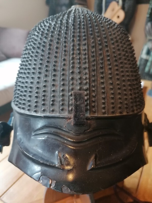

uwe Posted June 6, 2021 Report Posted June 6, 2021 Well, I can agree with Anthony and Thomas here! I was not stating it's Bamen at all, but liked to drew attention to some points... As we know, older helmets are sometimes undergone several changes during time. Hence mabizashi, haraidate as even koshimaki...etc, are not neccissarily reliable indications for an proper judgement. A while back, we discussed this kabuto: It bears remnants of a Bamen signature and was allegdely attributed to Masayuki. Yes Anthony, we have this "gunbai-thing" here! But the rivets as also the mabizashi are not typical Bamen, IMHO. What I'm trying to say is that in many (if not most) cases, we can only make an assessment on a basis of the accumulation of probabilities. Especally when it comes to older pieces whitch mostly lacking a signature. Whereby a comparison between mei and workmanship becomes impossible.... Quote
Luc T Posted June 6, 2021 Report Posted June 6, 2021 Interesting discussion. what do we have: a 62 plate koboshi number of koboshi per plate? Gary? no hibiki no ana no shiten no byo Small but perfect finished tehen no ana no nonsense but functional hachimanza. irregular shaped koboshi irregular aligned koboshi placed close to the suji. a probably replaced haraidate dai. a mabezashi that is possibly replaced too. According the style, we have a Kanto kabuto who did we have there: the Joshu. This is not a Joshu kabuto the Yashu. There are no koboshi known by them. the soshu (Sagami, Odawara) there was an Ietsugu who made koboshi +-30koboshi per plate. I have seen several of his work and it looks very much like this one. Ietsugu is recorded in the shin katchushi meikan as early edo. But there must have been several Soshu smiths with this name during the end of the momoyama-early edo period by my humble opinion. Gary, is it possible to post a picture with the names of the shinsa members? Some of them know these schools very good. But I am not sure if they were in the shinsa for this kabuto. there is a fair chance that this old boy is signed. Then we could be sure. Now we have to judge on what wee see. 1 Quote

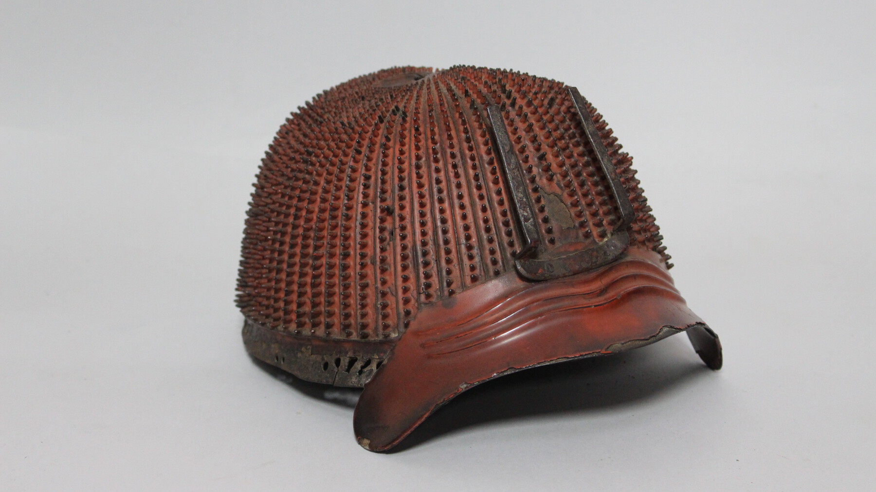

Luc T Posted June 8, 2021 Report Posted June 8, 2021 thomas, here 2 late muromachi koboshi, signed joshu Norikuni. One with original mabezashi and haraidate dai, the other one nicely converted according the West-Japanese momoyama fashion. Quote
