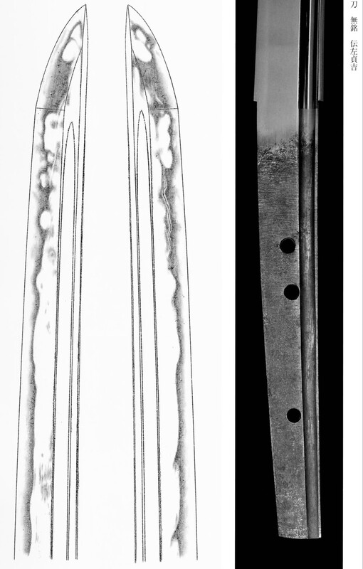

Hoshi Posted June 5, 2021 Author Report Posted June 5, 2021 The answer comes tomorrow. Last clue: Soshu Nambokucho it is. Vast majority have gotten this right, so kudos! But where would the attribution point to? There are certainly competing hypothesis there. Quote

Hoshi Posted June 6, 2021 Author Report Posted June 6, 2021 Time for the reveal! Many good and close answers. The majority nailed the period and tradition. A few of you nailed the school. Sue-Sa or Sa Ichimon would count as Atari here, so I think the board was very close to succeeding here (and Brian can PM me his Ether public key) The sword is attributed to the Sa Ichimon. By tradition, Sa school blades with a relatively calm suguha or cho-notare are attributed to Sa Sadayoshi. Due of the wild monouchi and ichimai boshi, the attribution is prefaced by "Den". So we have here a piece attributed to Den Sa Sadayoshi. The smith has 21 Juyo pieces, and half of them are accompanied by Den. His signed works are extraordinarily rare, and the attribution within the ichimon follows tradition. There is significant overlap between Sadayoshi and his father, Yoshisada, in style. To sum up, there is significant uncertainty when attributing within the Sa Ichimon due to the lack of daito with a preserved signature and the majority of works attributed to his students and the master are prefaced by Den. The thick and bright habuchi with sparkling ko-nie is a strong kantei point for Sa school. The boshi of Sa school is often quite distinctive, with a sharp and long kaeri. Here we have a sharp kaeri, but more intriguing is its ichimai characteristics, which is unique amongst Sa School published work. What I find particularly appealing is the wild but symmetrically tempered boshi and monouchi. In combination with the early end of the bohi, we have here a deliberate design choice on behalf of the smith and essentially would give the blade a second life in the event of a broken boshi. A point of particular interest is that there is a single prominent kinsuji on both sides, at the same place. These features are unusual for the Sa ichimon, and point to the influence of Go. An attribution to a student of Go is also plausible here, but that is not within the practice of the NBTHK due to lack of an extent historical corpus. The blade was once part of the a museum collection and came with an old inventory tag on its sayagaki (further research required here, I was told Tokyo national museum had the same tags). It further had an early torokusho number of 4038. Not much else is known about its provenance. It is possible that it was passed as Go during the Edo period due to its prominent fully hardened boshi, or the work of O-Sa as is often the case with Sa Ichimon, and has been carefully preserved as a result. For an old blade, the state of preservation is close to Kenzen, with a few weak areas on one side. Often for Sue-Sa or Sa ichimon attributions, the hada can be relatively weak, and this particular work stands out here. It passed Juyo with the following setsumei: Explanation The Chikuzen-smith Samonji (左文字) was active in the early Nanbokuchō period and left behind the traditional, classical Kyūshu style by establishing a new style which was comprised of a bright and clear jiba and a prominent amount of chikei and kinsuji. Samonji had many highly skilled students, e.g., Yasuyoshi (安吉), Yukihiro (行弘), Yoshisada (吉貞), Kunihiro (国弘). Hiroyuki (弘行), Hiroyasu (弘安), and Sadayoshi (貞吉), who faithfully continued the style of their master and who flourished throughout the Nanbokuchō period. It is said that Sadayoshi (貞吉) was the son of Yasuyoshi (安吉) and that he was active around Bunna (文和, 1352-1356). Signed works by this smith are extremely rare but there are unsigned blades with period attributions to Sadayoshi which often show a ha that bases on a Sa School- typical suguha. This blade is ō-suriage but reflects with its wide mihaba, little taper, shallow sori, and elongated kissaki the typical shape of the Nanbokuchō period. The kitae is a standing-out itame that is mixed with mokume and nagare and that features much chikei. The hamon is a nie-laden chū-suguha with a wide nioiguchi that tends a little bit towards notare, that widens along the monouchi, and that is mixed with gunome and angular elements, and the bōshi is a largely undulating midare-komi with a pointed kaeri. We recognize thus the workmanship of the Sa School and as Sadayoshi is traditionally known for hardening most often a suguha-based hamon within this school, the blade can be attributed to him. The jiba is rich in hataraki and has many highlights, and particularly impressive are the powerful nie and the sharply pointed kaeri of the bōshi, features which both match the dynamic shape of the blade. Therefore, we have here an ambitious masterwork among all blades attributed to this smith. Tanobe sensei's sayagaki Jūyō-tōken at the 63rd jūyō shinsa Sa Sadayoshi from Chikuzen province This blade is ō-suriage mumei. It is of an Enbun-Jōji shape, shows an itame-nagare that features plenty of ji-nie and much chikei, and is hardened in a nie-laden suug-chō with a wide nioiguchi that shows kinsuji and yubashieri and that is mixed along the upper half of the blade with a gently undulating notare. The bōshi is a widely hardened midare-bōshi that is bold and powerful and as its kaeri is somewhat pointed, we recognize along the jiba all characteristics of the Samonji group, with the rather calm course of the ha of this masterwork attributing it within this group to Sada- yoshi. Blade length ~ 71.5 cm 11 Quote
Tom Darling Posted June 6, 2021 Report Posted June 6, 2021 If I were in the juyo shinsa ( don't take this too seriously) I wouldn't rule out Naoe Shizu Kaneuji, being my 2nd guess. Believe it or not I had a Sa Sadayoshi, one (SA) character in gold, suguha hamon, with a dip (small cave in) on one side. Quote
