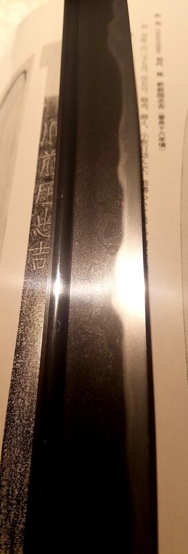

NewB Posted June 4, 2021 Author Report Posted June 4, 2021 On 6/4/2021 at 8:20 AM, Valric said: Shodai Tadayoshi, these are commodities in Japan. The smith was one of the most prolific of all times, and only the cream of the crop of his work will pass Juyo - typically special orders by the clan who employed him. You can recognise those special order blades as signed without his official title. And even for these, they'll need to be unaltered and pristine, showing his best effort. Here is one for example: https://yuhindo.com/hizen-tadayoshi/ Now these are rare. So I don't want to be all doom and gloom, but your best bet is to take an iphone, dark room, and beam a light on the sword to get decent photos. Gather feedback, and then decide. Expand Well mine was made for the Daimyo of the Nabeshima Clan by custom order. It is definitely a Juyo. If this doesn't pass JT I don't know what would. And yes, it is mint and exceptional and that's why I don't sweat this one at all. I know what it is and there's a ton of paperwork that comes with it. I tried with photos and I gave up so off they go to NTHK in August and if they suggest then off to Japan. Meanwhile I have about 20 that I have to sell as I have no more room anywhere.. John Quote

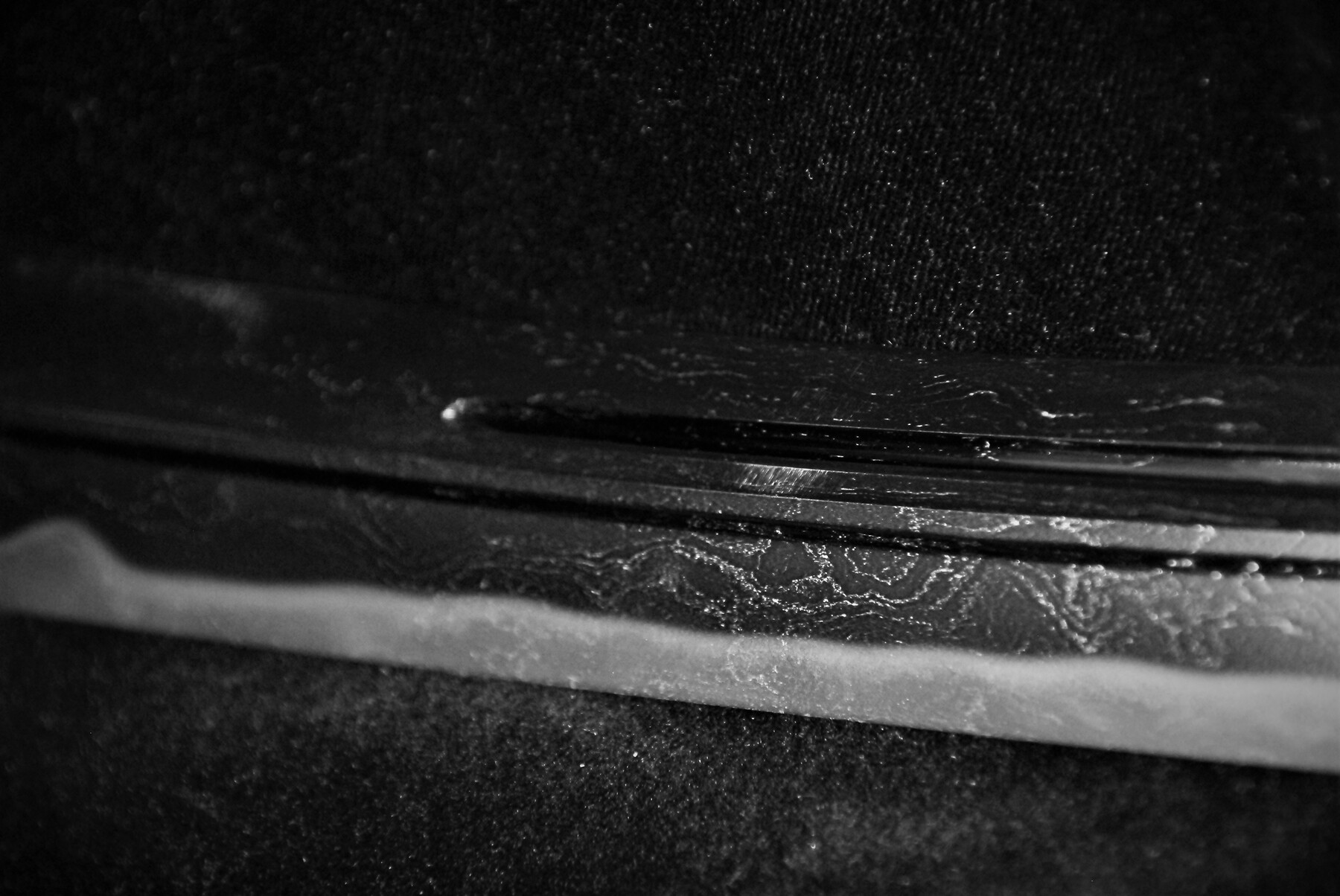

NewB Posted June 4, 2021 Author Report Posted June 4, 2021 One of the Shizu Naginata. How about that hada... John Quote
ChrisW Posted June 4, 2021 Report Posted June 4, 2021 Well, give us a little show and tell of those 20! I am sure you'll get offers from board members on them. Quote
NewB Posted June 4, 2021 Author Report Posted June 4, 2021 One by one. First is the Yasuaki. Have no clue why it hasn't been sold yet.. maybe the whole shinsakuto vs gendaito .. quite unfair John Quote
ChrisW Posted June 4, 2021 Report Posted June 4, 2021 Its a lovely blade, but out of my price range! Quote
Jwrussell Posted June 4, 2021 Report Posted June 4, 2021 On 6/4/2021 at 7:57 PM, Darkcon said: Shodai Tadayoshi John Expand Ohhhhh...that is seriously pretty. Quote
NewB Posted June 4, 2021 Author Report Posted June 4, 2021 I appreciate that very much!! I know the expectations are really high but I also know what I own. No bragging John Quote
NewB Posted June 4, 2021 Author Report Posted June 4, 2021 On 6/4/2021 at 8:07 PM, ChrisW said: Its a lovely blade, but out of my price range! Expand Yes, this one will run very very high, hence my hesitation to put it in the post John Quote
