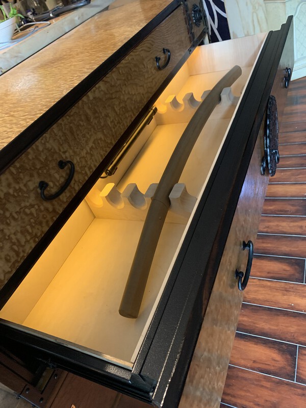

RichardP Posted May 31, 2021 Author Report Posted May 31, 2021 Thanks everybody for such nice replies! I just fetched a better camera, here’s some clearer pics: (The veneer is Tamo wood, by the way: https://www.woodmagazine.com/materials-guide/lumber/wood-species-3/tamo) 1 Quote

RichardP Posted May 31, 2021 Author Report Posted May 31, 2021 The gunsafe came with a little led light set in the inside of the drawer face, but I removed it and installed different lighting. I used a diffuser filter and amber light gels to tint the light a nice candlelight color: 2 Quote

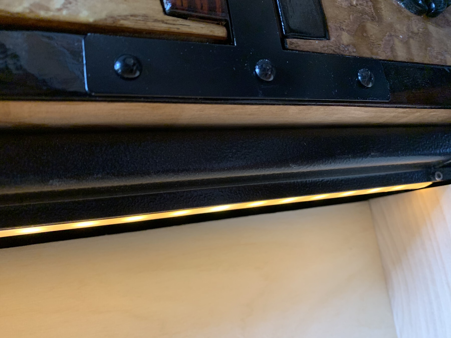

RichardP Posted May 31, 2021 Author Report Posted May 31, 2021 On the underside of the gunsafe’s lid, right at the mouth of the drawer, there is a 1/4” metal flange set at 90 degrees that I drilled through. I attached an aluminum led light strip bar (https://www.superbrightleds.com/moreinfo/aluminum-channels/micro-alu-led-strip-channel-universal/2039/)by drilling and tapping the bar laterally to accept #4-40 socket head screws. Three screws hold the whole assembly in place, and I don’t lose any more headspace than the flange was already taking up: 1 Quote

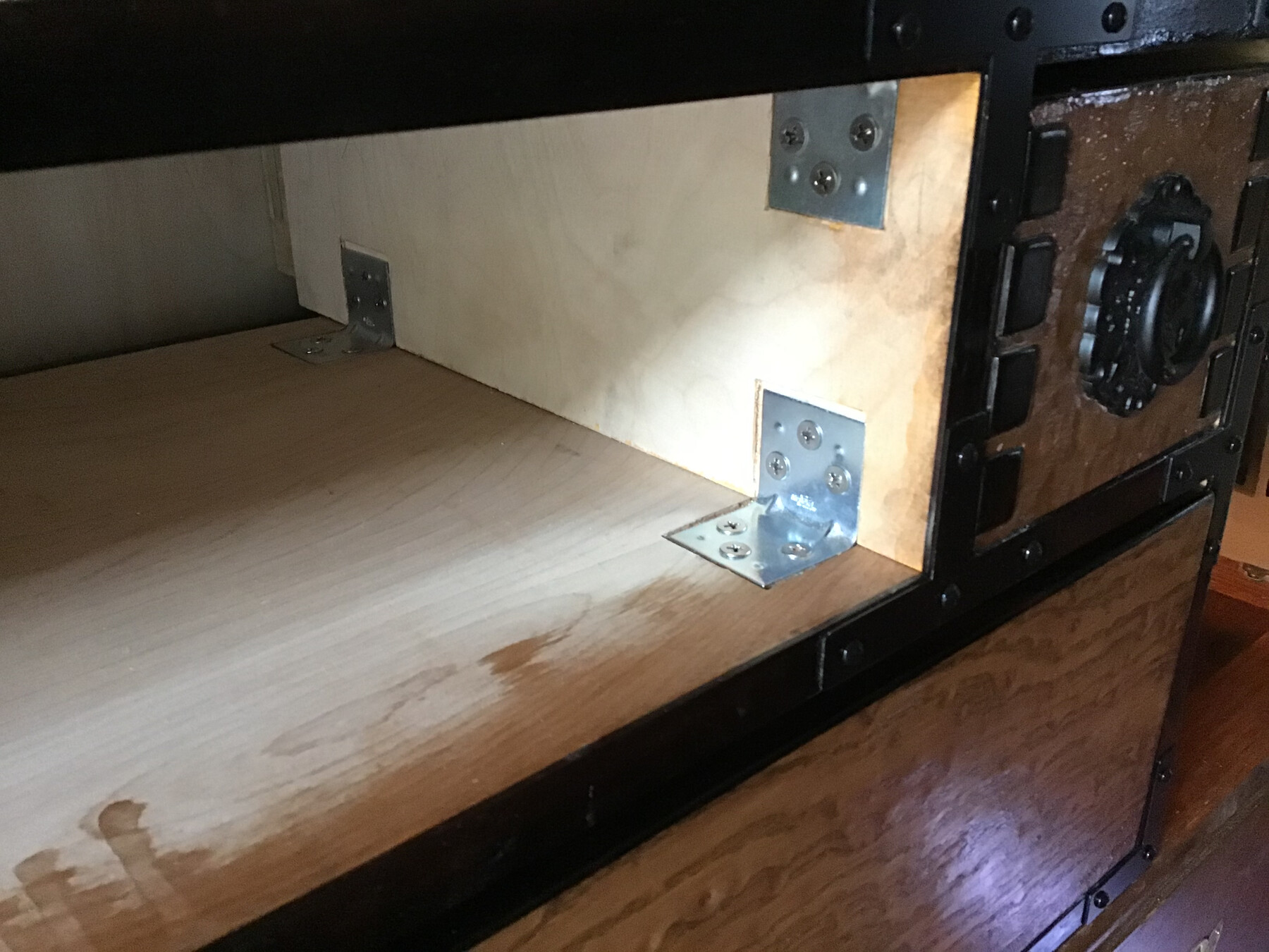

RichardP Posted May 31, 2021 Author Report Posted May 31, 2021 11 hours ago, PNSSHOGUN said: the joinery is superb Perhaps until you look behind the curtain—then: buh buh BUMMM.... Nothing but butt-joints & brackets. (The brackets have been countersunk with a router so as to avoid tangling up the drawers, but that was my only concession to professionalism. All you need to build this box is a table saw and a router. And a drill press helps.) Quote
