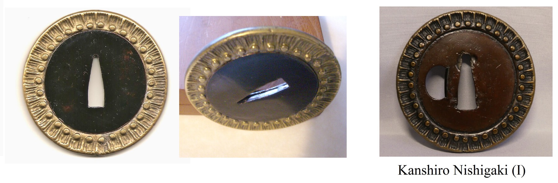

Spartancrest Posted May 16, 2021 Report Posted May 16, 2021 Many years ago I posted an interesting guard that I had just purchased - it was almost universally thought to be a modern cast fake [it is certainly not cast] Today I have found another attributed to Kanshiro Nishigaki (I) copper with identical fukurin in brass. https://www.jauce.com/auction/h556950818 The one I have, has enameled plates either side over a copper core. [I did at the time think the base plate was iron but it is non magnetic, so copper or Shibuichi?] I am wondering at what the board will think this time? [ I will be watching the auction with great interest] Quote

Curran Posted May 17, 2021 Report Posted May 17, 2021 Vendor: well, yes, he does post some good papered items in a short supply world. and shilling seems to be fairly commonplace on Yahoo!Japan. This guy could get extra bids on a 1999 Lincoln penny and turn it into 2 or 3 cents. As to the Kanshiro: I see it as an homage piece to an older style. It isn't papered- or more likely the NBTHK papers aren't being shown and got shoved in a drawer. Current NBTHK probably papered it to something else. --- I am traveling and don't have my books available to me at the moment to look up what the attribution is on this design in Tsuba Kanshoki or other of the big books, BUT the point is the 'Kanshiro' (supposedly in Ito-san's Nishigaki book, yet I don't remember it) is an homage to the old style. If antique, I'd view yours as also an homage piece. The one on Yahoo!Japan doesn't strike me as Kanshiro, and I am 50/50 on the one in Ito-san's book being Kanshiro. While Ito-san is a scholar par none and certainly 7 leagues ahead of the current NBTHK when it comes to Higo works, I still sometimes doubt the attributions on a few pieces in his books. Conclusion: ignore the Kanshiro attribution on the Yahoo!Japan one and hit the old big books to understand what the originals were. I want to say that they were attributed as Mirror Maker tsuba, but the old attributions might simply be Ko-Kinko. Yours would be a later homage or utsushi of that style. 1 1 Quote
lonely panet Posted May 17, 2021 Report Posted May 17, 2021 Well i dislike it, and canbe put in the other group of people that think suspiciously. You could Call me ignorant, you could call me correct, but i am just a student Quote
Yasaka Azuma Posted May 17, 2021 Report Posted May 17, 2021 2 hours ago, Curran said: Conclusion: ignore the Kanshiro attribution on the Yahoo!Japan one and hit the old big books to understand what the originals were. I want to say that they were attributed as Mirror Maker tsuba, but the old attributions might simply be Ko-Kinko. Yours would be a later homage or utsushi of that style. I had an online discussion with a ko-kinko collector in Japan, comparing some of the items listed, and he was of the same opinion. 1 1 Quote

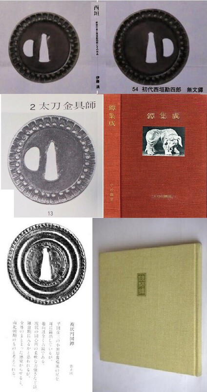

Spartancrest Posted May 17, 2021 Author Report Posted May 17, 2021 Thank you all - indeed I would love to hit the books, but so few are in English [or German] the only ones I can read. So Kanshiro is out, who is in? I too don't think my guard has great age, utsushi of who or what? I did have an image of yet another with the identical fukurin, in that case there was a slightly raised central plate both sides with conventional nami (wave) engraving, the thin (shakudo) plates were riveted at the seppa-dai in sanmei fashion. [unfortunately the image is now missing from my database] Whatever they are, they are all linked by the style of fukurin (odawara?) I just came across this image - same fukurin 2 Quote
Curran Posted May 18, 2021 Report Posted May 18, 2021 Ah yes "Tachi-kanagushi". Basically = Ko-kinko for a tachi attribution. I'm more than fine with that. The Ko-Mino tsuba would be a more specific version of Tachi-kanagushi. I talked to a friend about the Yahoo!Japan one. Both of us thought it more likely Shoami than Higo (Kanshiro). The friend was excellent to scan in the translation of Ito-san's comments on it and it was atypically weak commentary. The Kanshiro book is the thinnest of his books, and I'd put it forth that this one was "filler". I kinda like it, but only because the Hikozo [see Nihonto.com ones for sale] ones are all Juyo and above my pay grade. 1 Quote

Curran Posted May 18, 2021 Report Posted May 18, 2021 Once I get out of my current muddy trench of things, I will. Currently in the thick of it, but more than 51% through the current wave of work and associated mayhem. I'm only rarely online at the moment. This is one where the Edo => 'shoami' Pre edo => 'tachi kanagushi' is financially rather discriminatory. By calling it Kanshiro, Ito-san certainly helped whomever owned this one. I agree that the particular one might be Higo or by a Higo dilettante, but the logic in his writing to attribute it to Kanshiro seemed a bit long armed stretch to me. Gotta go... stayed here too long this morning. 10 minutes late now. Quote
