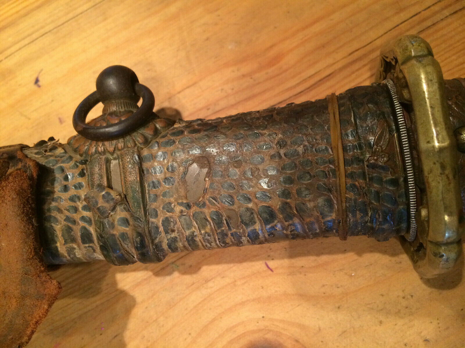

Bruce Pennington Posted May 19, 2021 Report Posted May 19, 2021 Both Army and Navy used ray skin. The Navy simply lacquered theirs black. I personally have never seen a 97 with shark same’. I’ve seen a couple of 98s with unusual things like snake skin, though. Quote
Kolekt-To Posted May 19, 2021 Report Posted May 19, 2021 Thanks again for clarifying Bruce! Snake skin would be interesting to see, indeed. Quote
Bruce Pennington Posted May 19, 2021 Report Posted May 19, 2021 Thou Thought I had one on file. This one is a saya cover. If I can find one in same' I'll post the link. Quote
Bruce Pennington Posted May 19, 2021 Report Posted May 19, 2021 THIS ONE is either snake of shark. I think it's shark, though: Quote
Bruce Pennington Posted May 19, 2021 Report Posted May 19, 2021 THIS ONE is unknown, but could be snake: Quote
