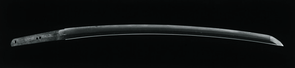

Alex A Posted May 7, 2021 Report Posted May 7, 2021 Hi Neil, Be good to see a pic of the blade showing its full length with measurements, nagasa, nakago length as Bizen works can have traits that make them easier to date. The file marks look correct. Quote
lancashireparade Posted May 8, 2021 Author Report Posted May 8, 2021 Hi @Alex A, I've been following a some templates to describe the sword and trying to fill them out according to what I see: So here goes: Signature : Nagamei on Omote side (Long Signature) - 備州長船祐定 Bishu Osafune Sukesada. Ubu: No evidence of suriage (shortening) Location: Bizen Province (Modern Okayama prefecture) Quality: The six character Mei suggests Jo-Saku and according to one sword order from a daimyo, this level of sword was for upper grade commanders and generals. Mekugiana : Single hole. Possibly punched as there is no burr on either side. The blade is not polished. Blade length Overall : 66.99 cm or 21 inches. Nagasa: 53.5 cm or 21 1/16 inches Nakago: 13.3 cm or 5 1/4 inches. Nakago Desription Sori : 18.5 mm Kissaki : no distinguishable yokote Width at the hamachi : 30.5mm Width at the Kissaki : 20.1 mm Kasane : 6.5 mm at Hamachi or 4.8 mm at Kissaki Era : The rust on the tang is rich and black indicating 16th century perhaps? Village of Osafune was destroyed by flood in 1590 Shape : It is in hira zukuri with a centered sori (Torii Sori) If you can help me shed any light on this blade, its age, or especially it's smith, i would be most grateful. I am on the list with David Hofhine to get it polished, but that won't be until sometime in 2023..... I think what I like particularly about this blade is that is possibly connected to the turbulent time between Oda Nobunaga, Toyotomi Hideyoshi and finally Tokugawa Ieyasu. There is a great series on Netflix called Battle For Japan which really brings this period of history to life. I love the thought that this piece of steel is connected to that era..... Quote

Alex A Posted May 9, 2021 Report Posted May 9, 2021 Hi Neil. Good to see im not the only one that does bad images, not a lot to go off. Would have been good to see a clear image of the nakago showing its shape. I see you hoping to date it to the end of the Muromachi period, theres a good chance it is. Personally, i would not be bothered about which Sukesada made it, let alone signed it, just too much variation. Its not like we are talking about a few smiths at the end of the Edo period. Mass production churning out weapons, not art swords. Can you see any detail at all with the grain in the steel?, i see some hamon, reminded of something like this. Japanese sword Touken Komachi, Wakizashi, Shirasaya Bishu Osafune Sukesada Wish i could be more help. Cheers Quote

Alex A Posted May 10, 2021 Report Posted May 10, 2021 Good evening Neil. The mei that your sword has covers a broad spectrum. You will find mediocre and also decent swords with that particular mei, as mentioned above its best to judge the sword. Compare a sword made during busy turbulent times to a peaceful time where there was more time and better materials. Seen it written few times that the best of this bunch were made at Eisho and then declined. From what limited number i have seen i would agree, often dated and more effort put into the sword, horimono also present. Also, Just one example of an Edo sword using the same mei, notice the hamon pattern near to the hamachi https://www.aoijapan.com/wakizashi-bishu-osafune-sukesadanot-guarantee/ Quote
