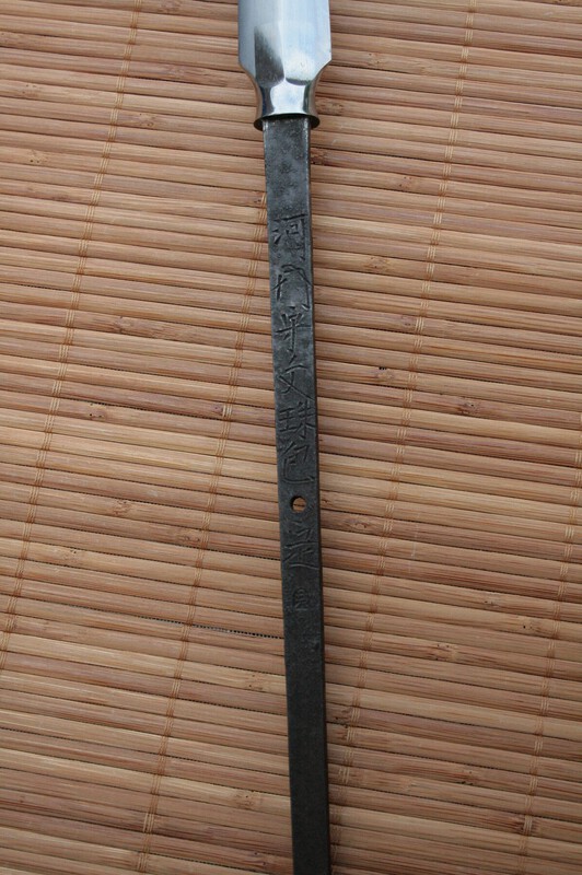

lancashireparade Posted May 5, 2021 Report Posted May 5, 2021 I have been searching the forums about punching vs drilling and how to tell. The best I have come up with is that it's not the shape that's the true indicator, but the pillowing of metal where the bit emerges from the steel. However, I can't seem to find any good comparative examples. When did drilling first become a standard practice? And how could one definitively tell if a mekugiana is drilled or punched? Here is what I am looking at: Quote
Guido Posted May 5, 2021 Report Posted May 5, 2021 Punching was done alternating from both sides, so there’s no outwards facing exit “pillow”, but usually a kind of “step” in the middle of the hole. 2 2 Quote
NewB Posted May 5, 2021 Report Posted May 5, 2021 Yours is punched, for sure. I assume very sharp edges of the whole, uniform size on both sides would potentially speak of drilled but I have read that uniform looking ends do not necessarily mean drilled. Cheers John Quote

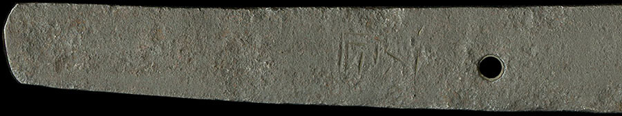

Jacques Posted May 5, 2021 Report Posted May 5, 2021 Punched mekugi-ana, perfectly circular and without "step". Quote
lancashireparade Posted May 6, 2021 Author Report Posted May 6, 2021 Thank you all! I think I can see the differences, but they are certainly subtle. Jacques, those are some beautiful mei, and I have never seen one with an engraving before! Thanks, Neil Quote

Jacques Posted May 6, 2021 Report Posted May 6, 2021 Neil, Quote And how could one definitively tell if a mekugiana is drilled or punched? Expand IMHO, it is often impossible to know if a mekugi ana has been punched or drilled and I think we should let the mekugi-ana aside when we make a kantei. 3 Quote
ROKUJURO Posted May 6, 2021 Report Posted May 6, 2021 On 5/6/2021 at 2:40 AM, Bugyotsuji said: .......What kind of punch would they have used? A tagane and a big metal hammer, onto a... wooden surface? Expand Piers, Western anvils have a pritchel hole which you can use. There are also tools that go into the hardie hole that have smaller or bigger holes so you can punch through. Japanese swordsmiths may have similar tools. The punches (or TAGANE) are conically shaped and mostly have a blunt tip. Holes are usually drifted from both sides and the excess filed flat, so there are no 'cushions'. The same applies to drilled MEKUGI-ANA: the 'cushions' have to be filed away, otherwise there would be an obstacle for the TSUKA. Jacques is correct when he says that it is often difficult or even impossible to differentiate between a drilled and a punched MEKUGI-ANA. But on closer inspection and a magnifying glass, you may often see a tiny difference in the respective hole, just as Guido mentions. I have seen drilled holed with a "step" as a result of unprecise drilling from both sides - the Japanese did not have power tools, and drilling steel was probably not at all easier than punching a hole in a red-hot NAKAGO. The advantage of drilling was that it could be done at a much later stage of finish, and I think in later times it was probably often done by the TSUKAMAKI-SHI for easier adapting of the TSUKA. 3 2 Quote
