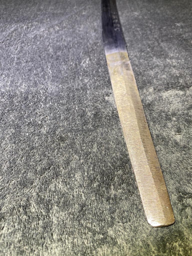

 Comprei duas lâminas de katana em uma loja de antiguidades que não eram importantes e foram abandonadas na loja. Não tenho conhecimento da katana, fiz pesquisas e as características da espada me lembram do período kamakura. Ficarei muito grato com qualquer informação que você puder me orientar! obrigado.
Hello Sir Peter Bleed, when I bought the swords they were kept inside the saya and had tsuka, but they were very damaged.  The blades had many spots of rust, I removed with hydrochloric acid.  These blades do not look like other damask steel katanas that I bought in Toledo / Spain, I believe they are authentic from Japan. The two blades contain hamon, and all characteristics of an authentic kamakura katana.

The blades shown above are clearly damascus blades, non-Japanese. And even if they were, by admission of using hydrochloric acid on them, you've committed a huge no-no in nihonto (and ruined them). Never, EVER, do anything that would impact the condition of the steel other than removing and reoiling a blade. That is something this forum will never tolerate; this stance is at the words of every proper togishi (Japanese blade polisher) who has received the years of proper training it takes to make nihonto shine.

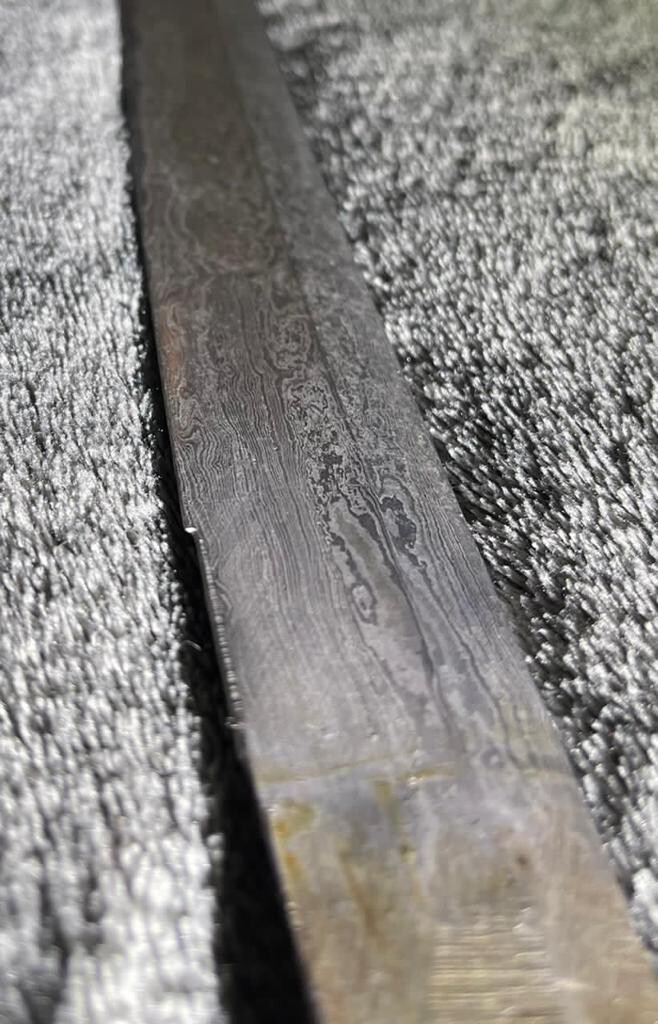

It doesn’t look like Damascus steel to me. It does look like something treated with acid though.

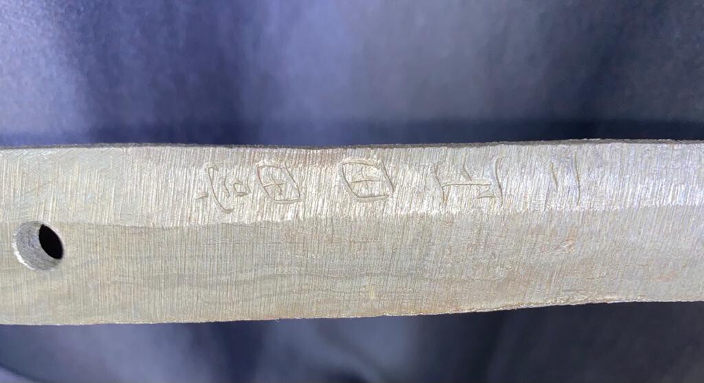

The writing looks legit, can someone translate?  The first one looks amateurishly made though. I could be wrong on all the above.

I saw some videos on YouTube of specialized people polishing blades they recover all the shine but unfortunately I don't have that kind of work where I live but I am still in doubt are the blades real or false?  making a comparison with damask steel it is very different the blades are of a single color steel the damask has two colors someone in the group knows how to say what is written on the blades thank you
Unless they are a properly trained togishi, they should not be doing polishing work and no one should seek to emulate them. Becoming a proper togishi takes years of work under someone with the experience. Most of those people are found in Japan.
I do believe this type of look comes from what is called "pattern welded steel". Which is simply multiple thin layers of same/similar steel that have been stacked together, edge tack welded together, then heated and hammer forged together, WITHOUT any folding occurring. The slight difference in layer colors, mainly comes from the surface skin carbon/scale that is present on each individual layer of thin steel that has been stacked together. The surface impurities show up after hammer forging has fussed the individual sheets together.
You can clearly see the layered detail even in the nakago, which you never seen in a true Japanese sword. The layers only appear in a true Japanese sword after careful, proper polishing.

This is a blade of damask steel compared to the blade I bought. I thank everyone for the guidance for informing me that this is an imitation. It was the research I did on some sites that made me believe they were original pieces. Thanks

The picture of the "Toledo" blade also appears to be a modern replica as well, which is a copy based on the original swords of days gone by. It too is a pattern welded blade, it is not an authentic Damascus steel blade. You can go online and buy those replica blades for only several hundred dollars, they are a very popular tourist items, and military folks pick them up while on leave as well.

I do believe this type of look comes from what is called "pattern welded steel". Which is simply multiple thin layers of same/similar steel that have been stacked together, edge tack welded together, then heated and hammer forged together, WITHOUT any folding occurring. The slight difference in layer colors, mainly comes from the surface skin carbon/scale that is present on each individual layer of thin steel that has been stacked together. The surface impurities show up after hammer forging has fused the individual sheets together.....
Mark,
unfortunately, you are completely wrong. Pattern welded steel is mainly found in early Viking blades, and it is made by intensively folding, twisting and forge-welding work. Please read
https://en.wikipedia.org/wiki/Damascus_steel
for more information.
The blades shown above (with the exception of Jacques' blade) have absolutely nothing to do with Japanese forging techniques, and this applies as well to the lower photo on the JSSUS paper.
They are not Japanese, never were Japanese and never will be Japanese.
EVERYTHING is wrong with these. The shape, the fake kanji, the steel, everything. There is not one thing there that looks Japanese. I have $100 for you if they turn out to be Japanese. They won't.
I could point out multiple things. But there is no point. Many people told you, now I am saying it with zero doubt.

I go with the guys, a blatant fake with acid treatment. Boshi is all kind of wrong, and let’s not even talk about the kanji. Sorry man, but that’s the truth.
Jean, I humbly beg to differ.... the only thing that could be misconstrued as wrong, is the fact that SOME (not all) modern blacksmiths do indeed fold or twist their welded stack of thin steel sheets(in order to attempt to get accreditation from the modern blacksmithing community). I have reviewed and overseen classes in blacksmithing as an experiment in knowledge gathering, and have seen 1st hand through class instruction and actual examples of worked steel (both new and old) that were attempts to replicate the LOOK of the original Wootz steel Damascus blades. I have seen as many as 100 pieces of .020 thick sheets of steel all stacked together, edge tack welded then heated in a forge and hammer welded together. Once shaped and semi polished, these displayed the pattern exactly as seen in the bogus sword shown in the photo. I was simply commenting on examples I've held in my had as a comparison.
Yes, some blacksmiths from far back in history tried many ways to duplicate true Damascus steel, all with varying degrees of failure. The Wikipedia article you linked, tells us as much.
Furthermore I was not trying to give a thesis on the history and manufacture of original Wootz crucible pattern steel Damascus blades, or on Pattern welded blades, I was once again, simple commenting on the shown blade from the original OP, and giving a loose overview of how most likely THAT blade was made.
Original Wootz crucible Patterned Damascus steel was just that, a crucible steel, not a welded pattern steel ingot...huge difference between each of these.

Every cloud has a silver lining and the happy lining here is that you don’t need to worry about that acid wash just this one time: don’t get me wrong the pitting and steel corrosion acid will do, which can never be fully fixed, is a terrible way to lose thousands were it an antique.
The reason you don’t need to worry this one time is as everyone noted: these are cheap replicas so little of value was lost. In the future, if you see that weird tyedie etched looking “Damascus” hada, along with things like that misshapen kisaki, stay away since those are the hallmarks of poorly made acid etched replica.
Seriously though, when you get a nihonto, stay away from acid and abrasives since that’s a very easy way to cut its value to a fraction.
